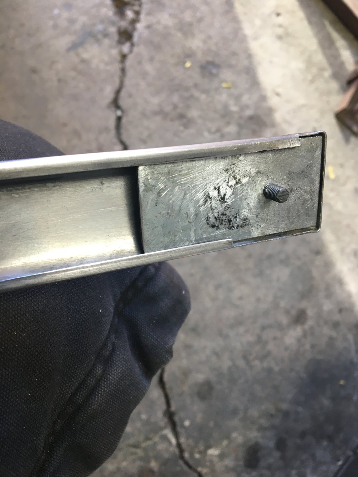

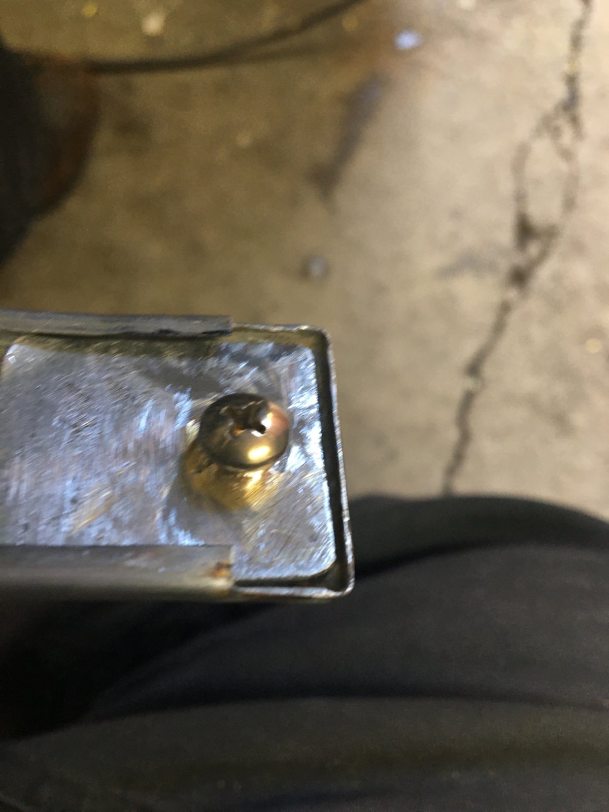

    This is one of several that I have made. Yes, I'm an Old Timer!  IMG_0358.JPG IMG_0359.JPG

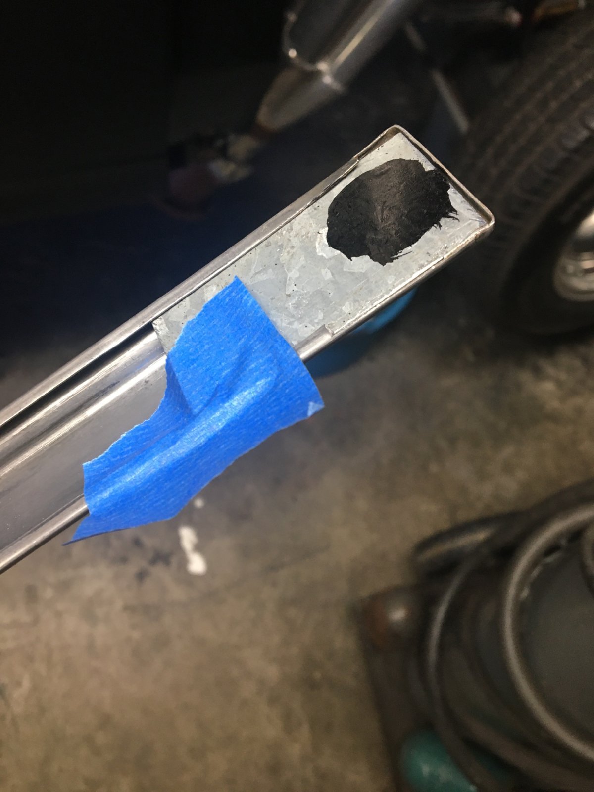

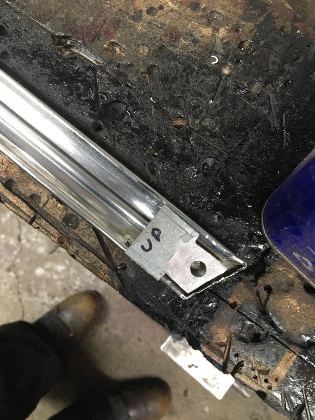

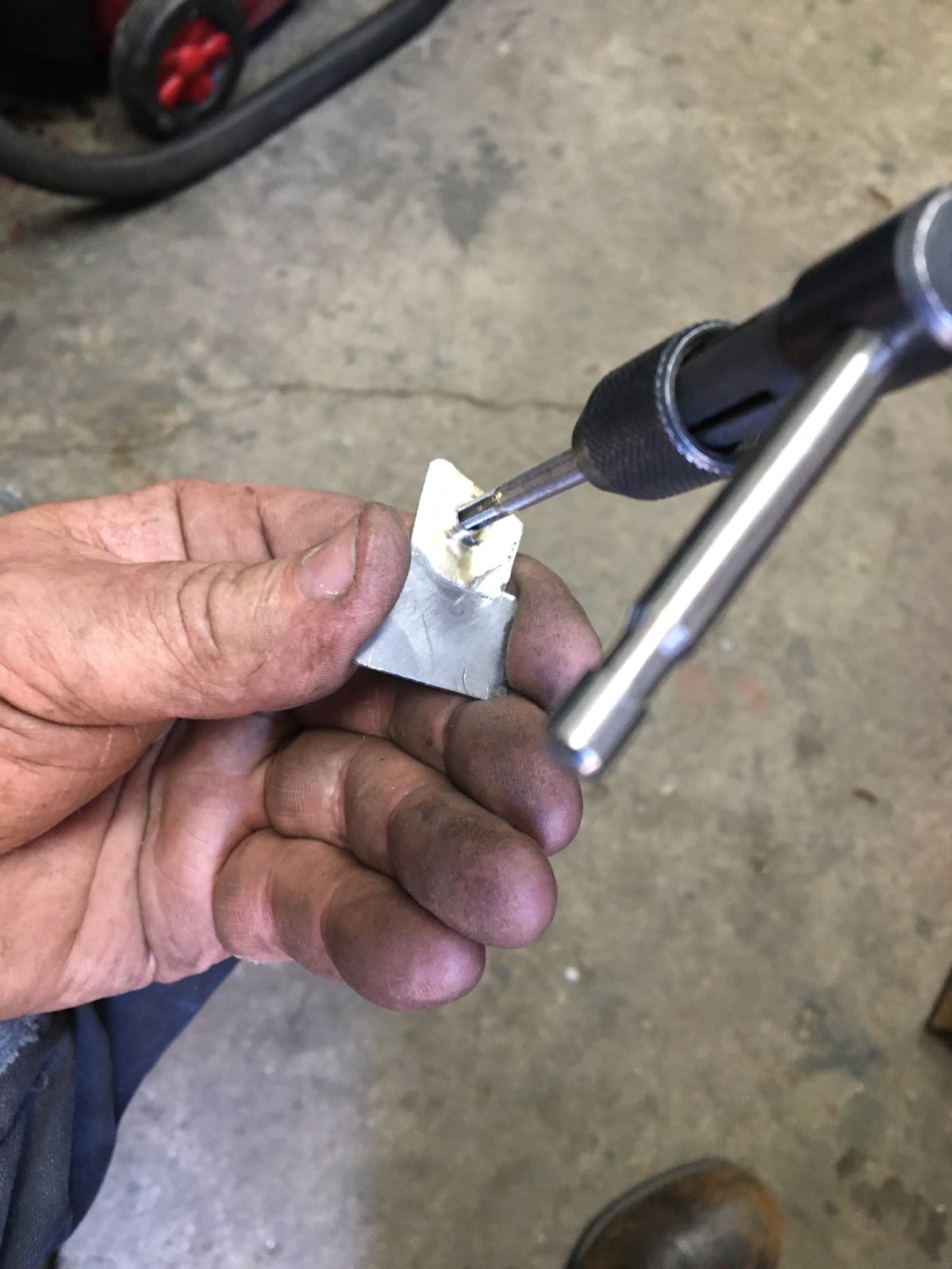

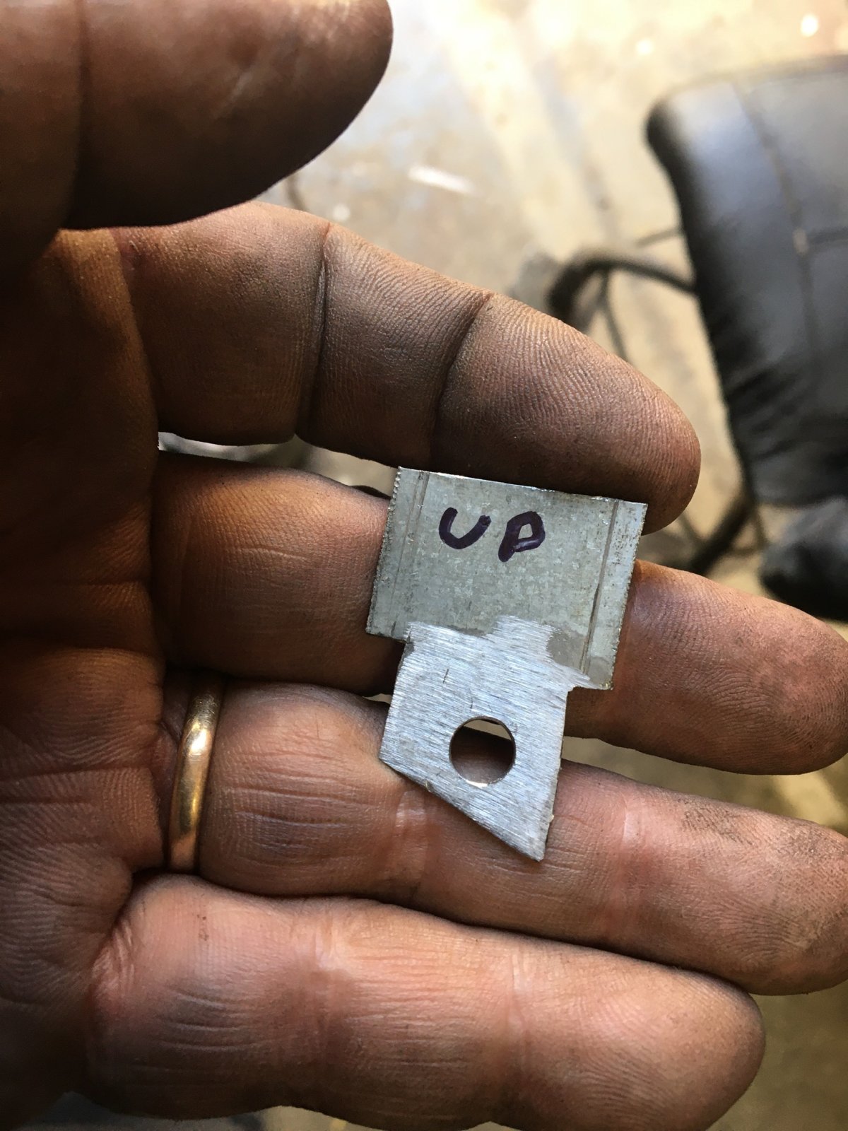

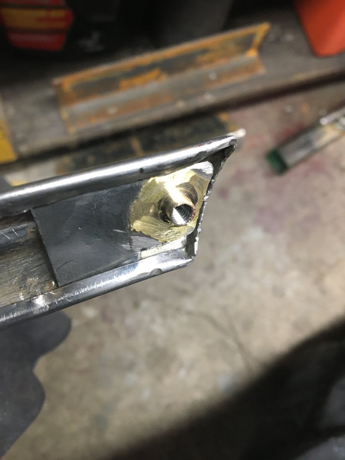

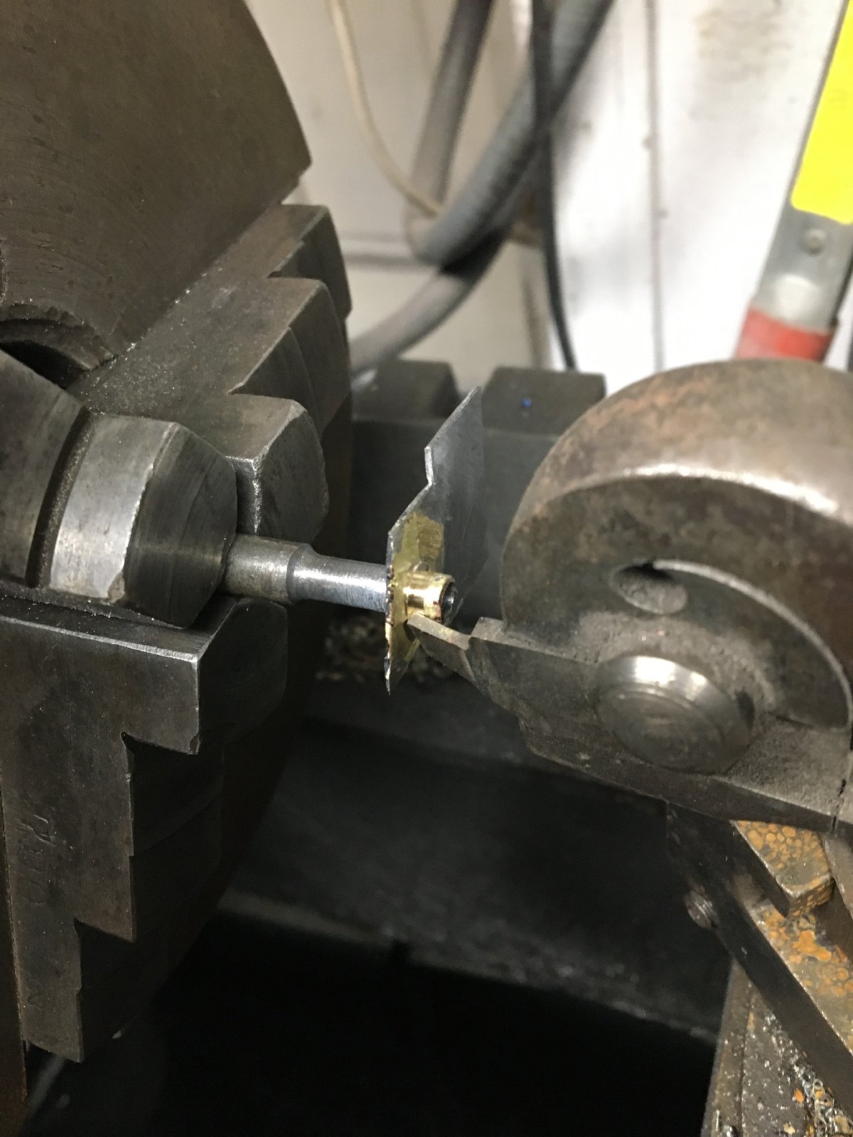

    6D762150-F8F8-4643-BF00-7727297E1F70.jpeg E38FDBA8-14D2-42D8-A079-33EBF6628C0A.jpeg 3CB7E819-7ECE-42B8-81FC-D54D5DE5B006.jpeg D19C024F-B85E-4C56-B7B8-A63FCD05F50C.jpeg 60586E38-BFB2-43C1-B9C6-DCC7E1F19849.jpeg FCBB16BD-A899-4A7D-BB5B-D006000D7CB8.jpeg F60FB588-C12F-4DFB-B4FD-21606924F50D.jpeg 5BE3EC5D-15A7-491E-9904-331C0076FA37.jpeg More clips. I braze the galvanised sheet metal to shaft. Then I can chuck it in my 100 year old lathe and clean up the excessive br*** and drill and tap. I don’t think you can purchase any clips of this nature. The first pic I had to make the clip longer due to the lip destruction on removal. Someone had to drill out most of the screws holding the trim on the car. Where they couldn’t drill, it was tore off. Enjoy making them.

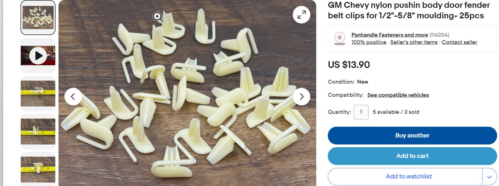

    Got it! Found these nylon trim clips on ebaY. They fit both the wider body and door trim as well as the narrower grille trim pieces. Pop tightly into the factory 1/8" holes. Waiting on another style to arrive that should(?) fit the tiny nose strips. Great thing about the nylon clips is they don't damage paint and don't rust.
    I thought about getting a few stud and nut type for the ends of trim but can't use them all along the trim but can't reach much of the length from inside. Can't even reach the ends of several trim pieces. Stuck with snap in type which the nylon ones do perfectly.
