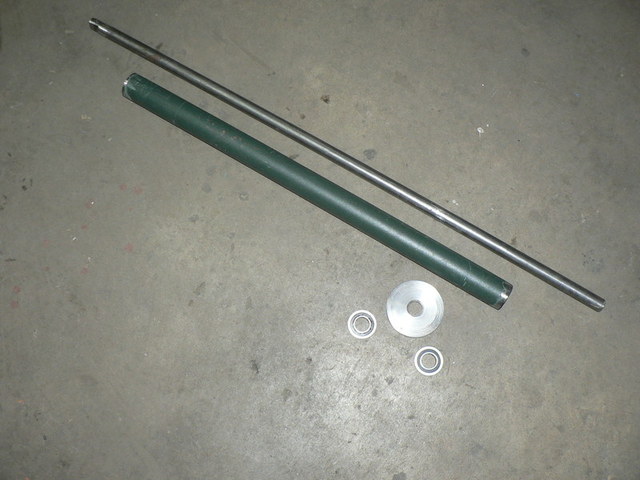

    1.5" tubing, 3/4" steel rod, a plate cut for the wheel and the bearings.
    Here are the bearings I used, from a local tractor supply.

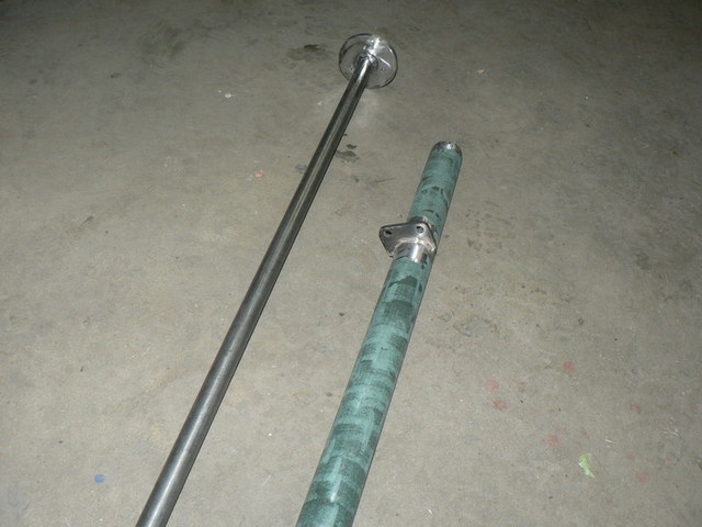

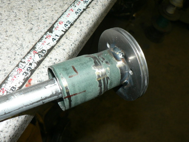

    plate welded to the rod, mounting tab mounted to the tube and the bearings have been greased and tack welded to the tube.

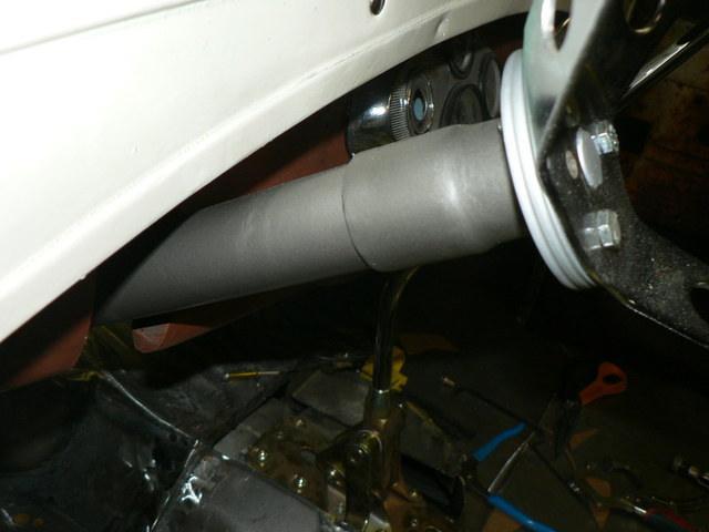

    I didnt like seeing the bearing and rod when it was installed os I added a sleeve to the wheel plate
    Painted and installed

    The only thing left is to clean up the exit area and make a lower mount at the firewall, works great very happy. Hope thsi helps someone.

  4. quote''plate welded to the rod, mounting tab mounted to the column and the bearings have been greased and tacked in.''
    did you mean you tack welded the bearing into the tube?

  6. Yes, that is what I meant - I will go back and clarify that.

    If you prefer not to tack it in.. You can do sort of what GM did with a coil spring and a locking collar with a set screw. These 2 pieces push up on the lower bearing, and they also pull down on the steering wheel, which presses the top bearing down.
    Both pieces came from the same hardware store as the flange bearings did.
