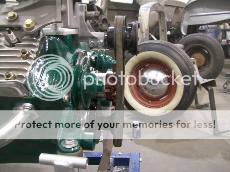

Mallory crab style igintion on a flathead, what am doing wrong?
Discussion in 'The Hokey Ass Message Board' started by Jalopy Kid, Nov 18, 2009.
  1. 59A block, 49-53 Merc crank with a 59A pulley, everything lines up, however the Mallory electronic ignition hits fan belt!! What am doing wrong and what have you guys done to fix this?
    And if anyone says it is because I have a big ugly alternator on there I will slap them haha. Its a customer engine and I tried hard to get him to run a generator but he wouldn't have any of it.

    I'm glad you posted with pictures since I am looking at the same problem. I think the problem is the double crank pulley but someone correct me. Didn't the 59a come with a fan bolted to the front of the generator, a single pulley crank and a single belt driving everything? I think I have to either use an electric fan, or lose the crab and go to a late dizzy. But if any older geezer than me knows a better way tell us!

    From the pictures it looks like you need to move the fan shaft and lower pulley out approximately 1/4 inch to clear or go with the other suggestion on a elec. fan.

    This is a common issue with that long body distributor. Simply switch that distributor for the stock Ford 42 style distributor and every thing fits perfect. You can run the stock distributor on 12 volts with no problem. The stock distributor runs fine at flathead engine speeds. You didn't specify what you were installing this in but that fan set up takes up a lot of space in a small car.

    I would double check that crank pulley. Looks like you only need less than an inch of additional clearance. You may have the 8BA/8RT double pulley which may be a tad shorter than the 59AB double pulley. I'm at work so I can't give you the measurements of these two parts.
    The double pulley was used when Ford went to the 2 piece "crab" style dizzy. The wires were routed out the back of the cap in order to clear the belt. Also, the body isn't as thick as an eletronic Mallory like you have.
    Would you use consider using a 99A single crank pulley and make a idler fan pulley from an '39 or earlier generator that mounts the fan on the hub?

    The Mallory distributor is longer that an original 42-48 distributor witha 42 cap.
    Change the distributor or
    use a 33-39 fan on the generator and use one belt.

  9. The engine is going in a 46 mercury coupe. The generator fan will not work because of the offset gen mount, plus the customer is hell bent on running the alternator.
    I will suggest using the stock 42 style distributor, but chances are he will suggest to run an electric fan.
    An 8BA pulley will not fit either, it hits the bottom of the distributor

    Most guys run the 8RT pulley. It's about a half inch smaller on the outside ring only, (same pulley diameter), and slightly shoter so it clears the mallory nicely, belts ride outside the case. To the best of my knowledge all the RT pulleys were the same, (? I think!). This is what I'm running on my 8 BA fitted with earlier distributor.

    8rt vs 29A pulley...not really interchangeable. The inner sheave of the late one is farther forward and needs the longer late truck pumps, because everything on the late engine has to move forward to clear the sideways distributor. Fron fan-drive sheave is in the same place.
