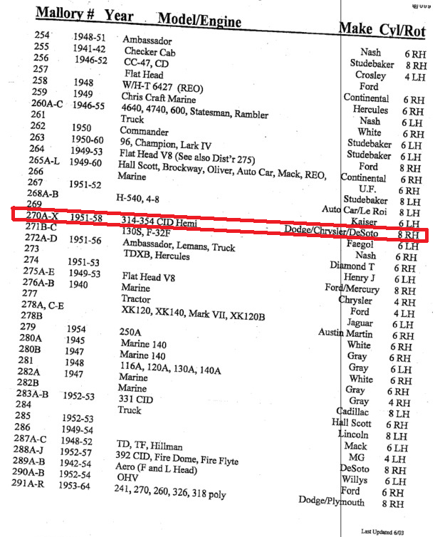

    Here's what I came up with. 270A-X fits a 1951-'58 Dodge/Chrysler/DeSoto 314-354 CID Hemi with right hand rotation. ZC states that it should have both vacuum and centrifugal advance. Hope this helps.

    Right hand rotation is the direction the distributor spins. Here is the sheet I used for the info I sent.

    I guess I should have worded that differently. I do know that the RH rotation referred to the rotation direction of the distributor, but I guess what I wasn't sure of, is that considered clockwise rotation?

    My original AutoLite distributor out of the Desoto is apparently being held hostage, so I don't have anything to compare this one to. All I can say with certainty, when I drop this one into the engine, the shaft seems to stop it from seating on the block by a 1/4" or so. It's a 1956 341, though my knowledge of hemi engines and the differences between Dodge, Chrysler, Plymouth and Desoto and the various CID differences is nearly nonexistent.
    And thank you for posting the chart, I appreciate it.

    PnB, the distributor I have is clockwise rotation, I do know that, but I thought my Desoto hemi was as well. So, without my autolite here to check, just wanted confirmation.
  10. Desoto hemi, and MOPAR 318 and Chevrolet all rotate clockwise.
    A cheap trick, look at what side of the cam shaft the distributer is on, if it is to the left of the cam shaft it rotates clockwise.
    NOTE: disclaimer a reverse rotation boat motor will be opposite.

    Thanks for the info, PnB. While curious as to the original application of this Mallory, I don't particularly need to know. More just wanted someone more knowledgeable to confirm or refute what I had been able to ascertain about this distributors rotation being the same as Desoto. Guess I'll keep it and maybe look into one of the HotHemiHeads adapter shafts if there's one available for this particular fitment issue.
