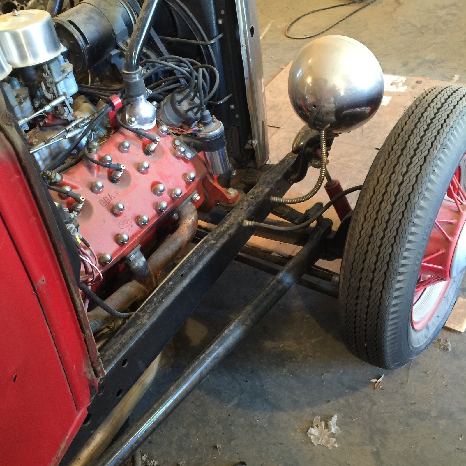

  14. x77matt
    Joined: Mar 2, 2004
    Posts: 831
    x77matt
    I did the same on my Mallory Flathead conversion. Drilled the cap for 8mm resistor wire and it works great. I used the pertronix in combination with MSD boost control setup.
    The Napa replacement 1 piece cap does not seem to be available any longer last time I checked.

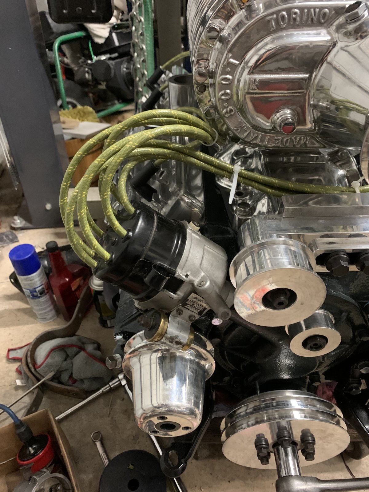

    I had an old Mallory dual point on my 8BA and was able to have it converted to HEI guts. It was worn out and wouldn't keep accurate timing, so it was either trashcan it or try to salvage it by having it converted.
    46E62103-881D-4076-80A4-FCFC558AB8C6.jpeg I had the 2 piece cap and was never able to locate a replacement, 1 piece or 2 piece. Hopefully there are suitable new parts available now.
    Toms Dogs and G-son like this.
