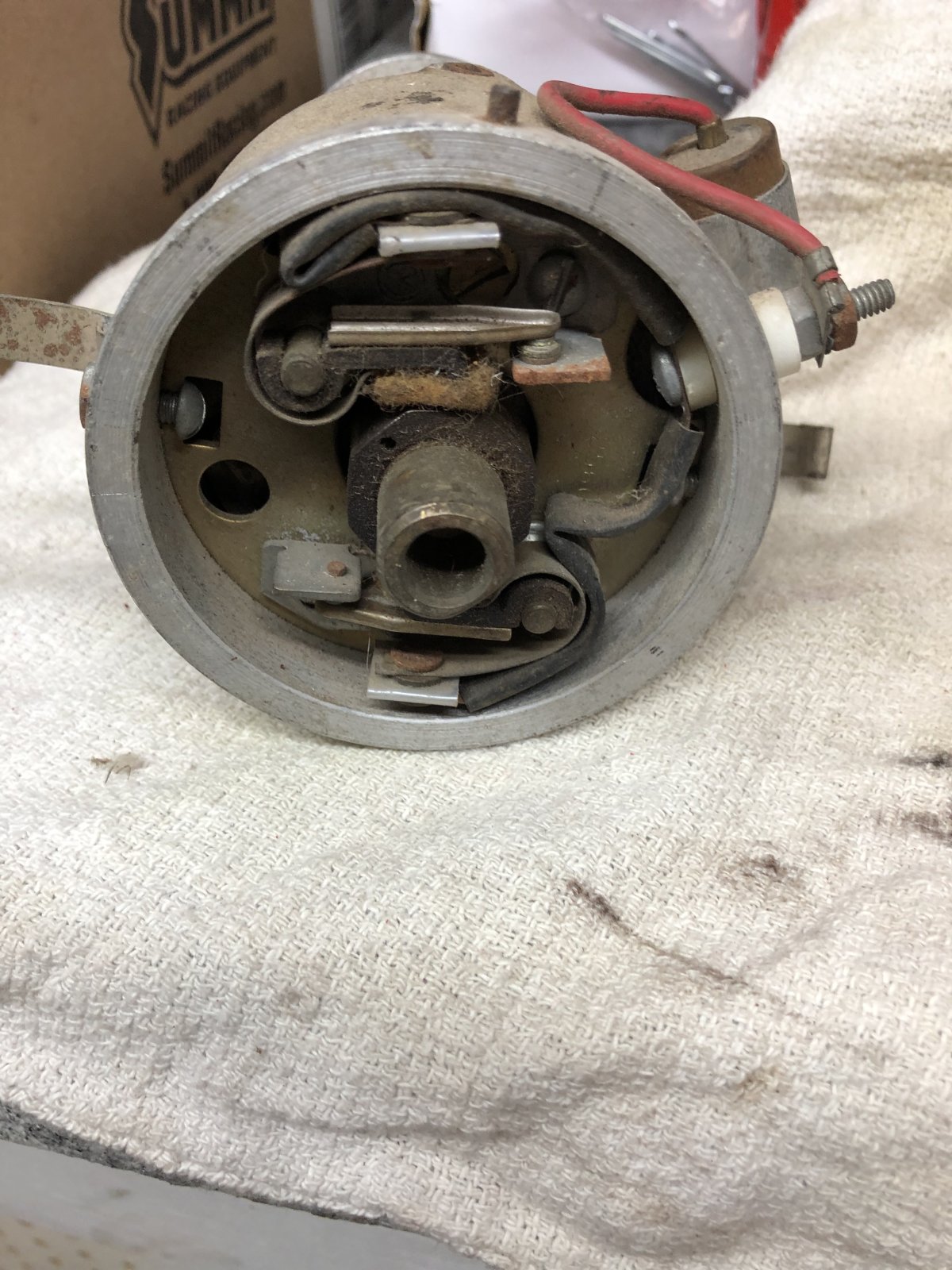

    Okay,,,,, I purchased this unit a few years ago,,,,I found it online .
    I think I gave 35 bucks for it,,,,it needed some attention ,,but it was overall pretty good.
    From the first pic,,,you can see it was very dirty,,,mostly from sitting for years somewhere on a shelf I guess . I received it without a cap or rotor,,,,,but it was still worth the money .
    It had a few issues ,,,a bent strap for the cap,,,,,and mostly a patina of surface rust and dirty grime that had gathered on it .
    Either way,,,I knew that it would turn out great with a little attention .
    These units are very well built and last a long time with a little service and maintenance .

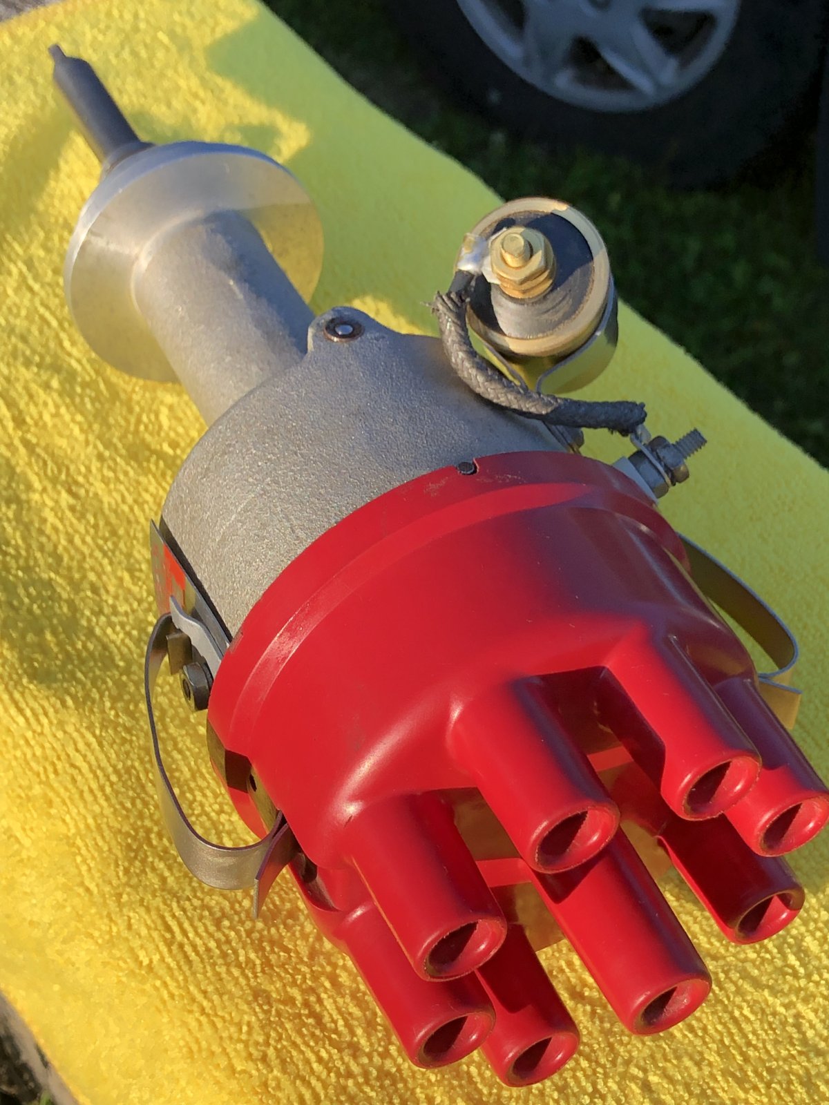

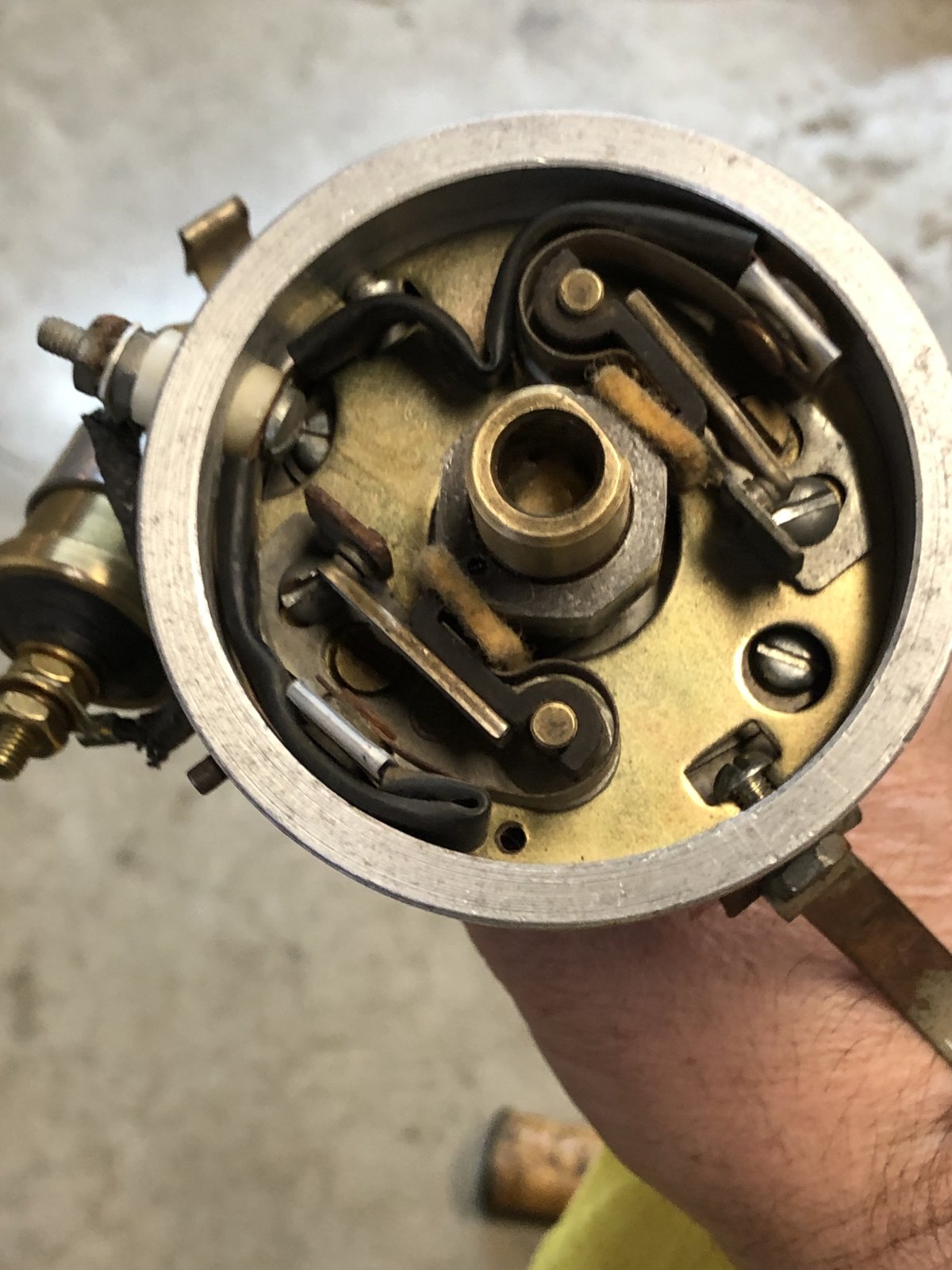

  3. Here is the next progress in the units return to glory .
    After dis***embly and cleaning,,,it was good to see it was in excellent condition and ready for the job ahead .
    I cleaned it in a sink of hot water and Dawn detergent,,,,I used a green Scotchbrite pad and got all the surface rust and general **** removed from the unit.
    I was very pleased to find no wear in the bushings and the unit was definitely a low hour unit .
    After re***embly,,,,here are the results .
    Tommy

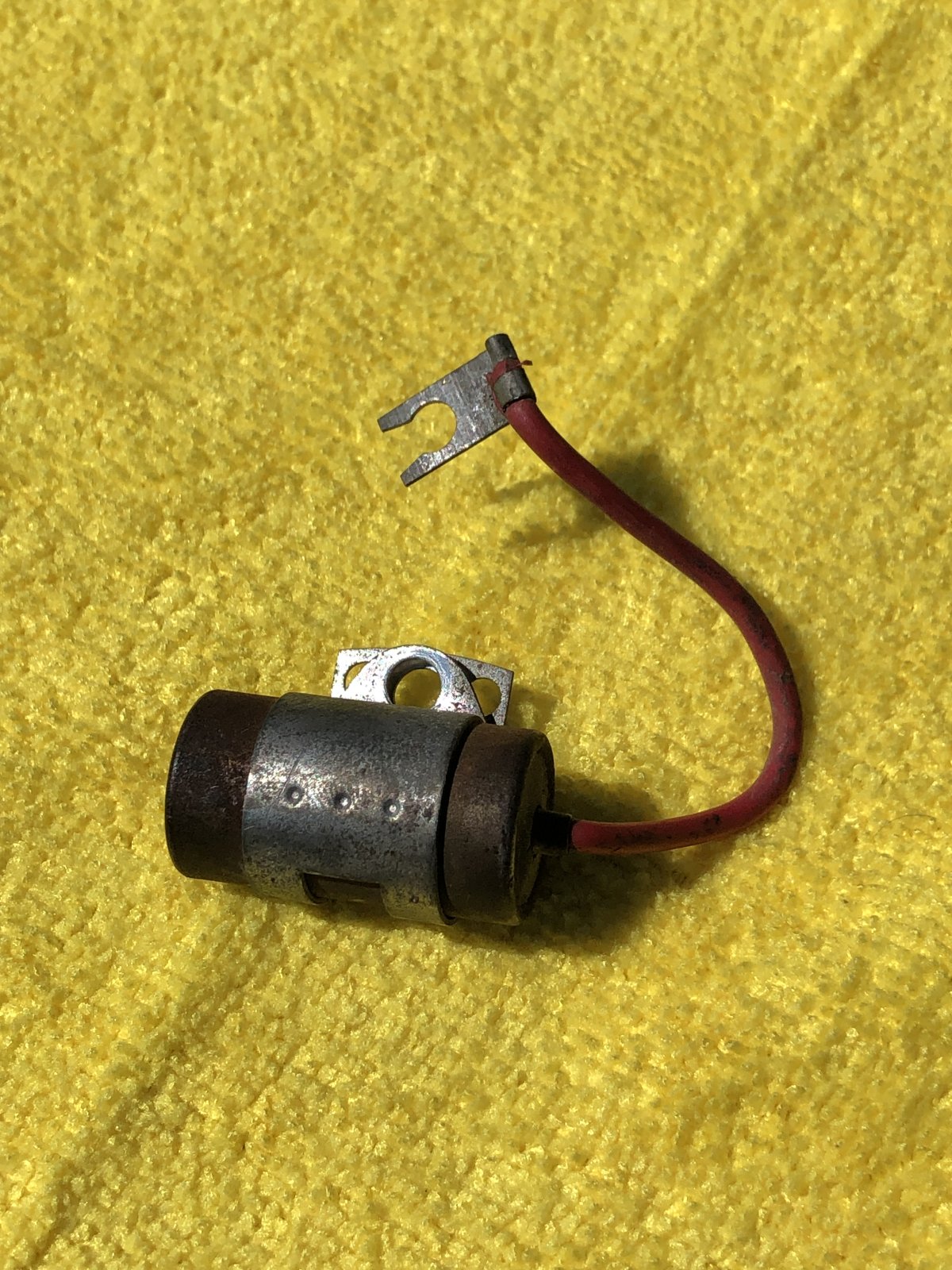

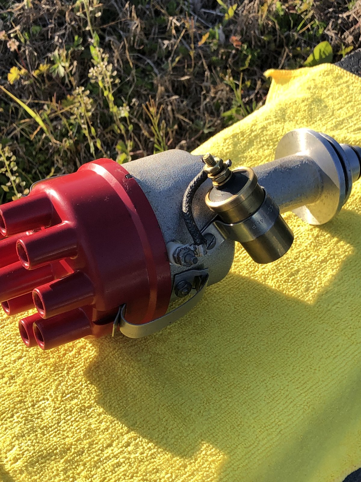

  4. The factory condenser was in terrible condition,,,,looks wise .
    I decided to replace it with a brand new piece I bought from Tubman here on the Hamb .
    His units are beautiful,,,,and work great !
    I kept the old unit though,,,,,I’m sure it’s still good and I can always clean it later on if I need it for another application .
    I purchased the new condenser several years ago,,,,I just knew I would need it someday !
    I’m certain it will last a long time .
    Tommy

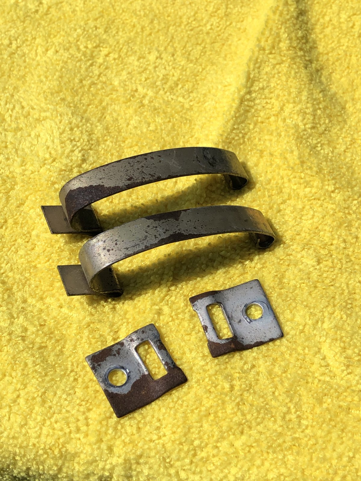

  6. Okay,,,,,the worst part on the unit was the straps for the cap,,,they looked like **** .
    One was bent badly,,,,and both of them had rust on them,,,,looked really bad !
    I straightened it back correctly,,,,and used a 90 degree sander with a Scotchbrite pad to clean off the funk .
    After a repaint,,and letting them cure they turned out better than I had hoped for.
    Here are the pieces before,,and after .
    Tommy

  9. And now the results that I was hoping for,,,,I was hoping for a good looking unit that would perform well,,,I think I succeeded .
    Altogether,,, I might have a couple of hours of honest work in this refurb .
    A little money,,,,and some repairs,,,and it is good to go .
    I had an almost new cap and rotor,,,,,with my other stash of distributor parts ,,,lol .
    I think I have about 50 bucks in this,,,,,,35 for the original purchase,,and maybe 15 for the cap and rotor .
    Oops,,,I forgot the Tubman condenser,,,I think it was 60 back then,,,,,still not a bad total .

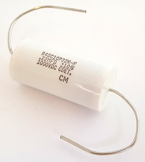

    New automotive replacement condensers usually work, some don't. I've used an electronics condenser (called a capacitor in the trade) rated at 0.22 uF and 1000 V with great success...it is not in a metal can, you have to ground one lead and connect the other to the points. Places like digikey and Mouser sell them.

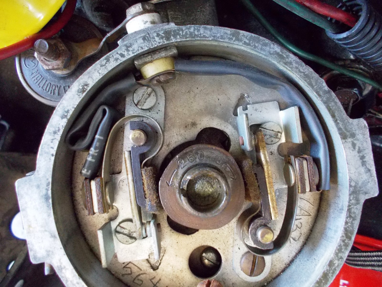

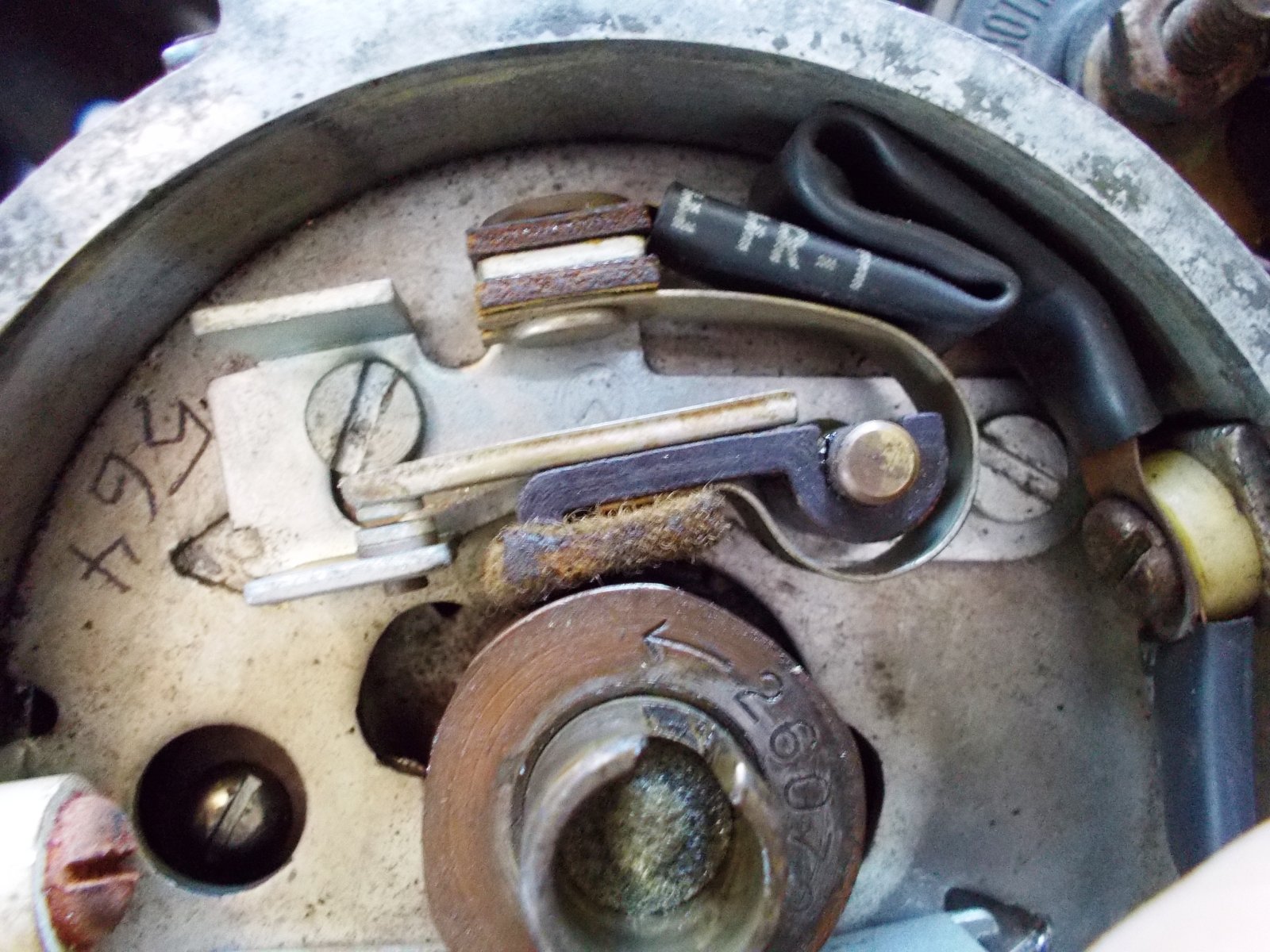

    I've used Mallory dual points in my six banger nostalgia drag racers for a long long time. One is a six-lobe dual point and the other is a 3-lobe Dual Life. K.I.S.S is a big reason. Traditional looking is another. You can still get points for them (my Ford, at least).

    The parallell dual points are meant to handle more current without getting burned quickly, right? A way to get more power to the ignition coil, and the resulting more powerful spark.
