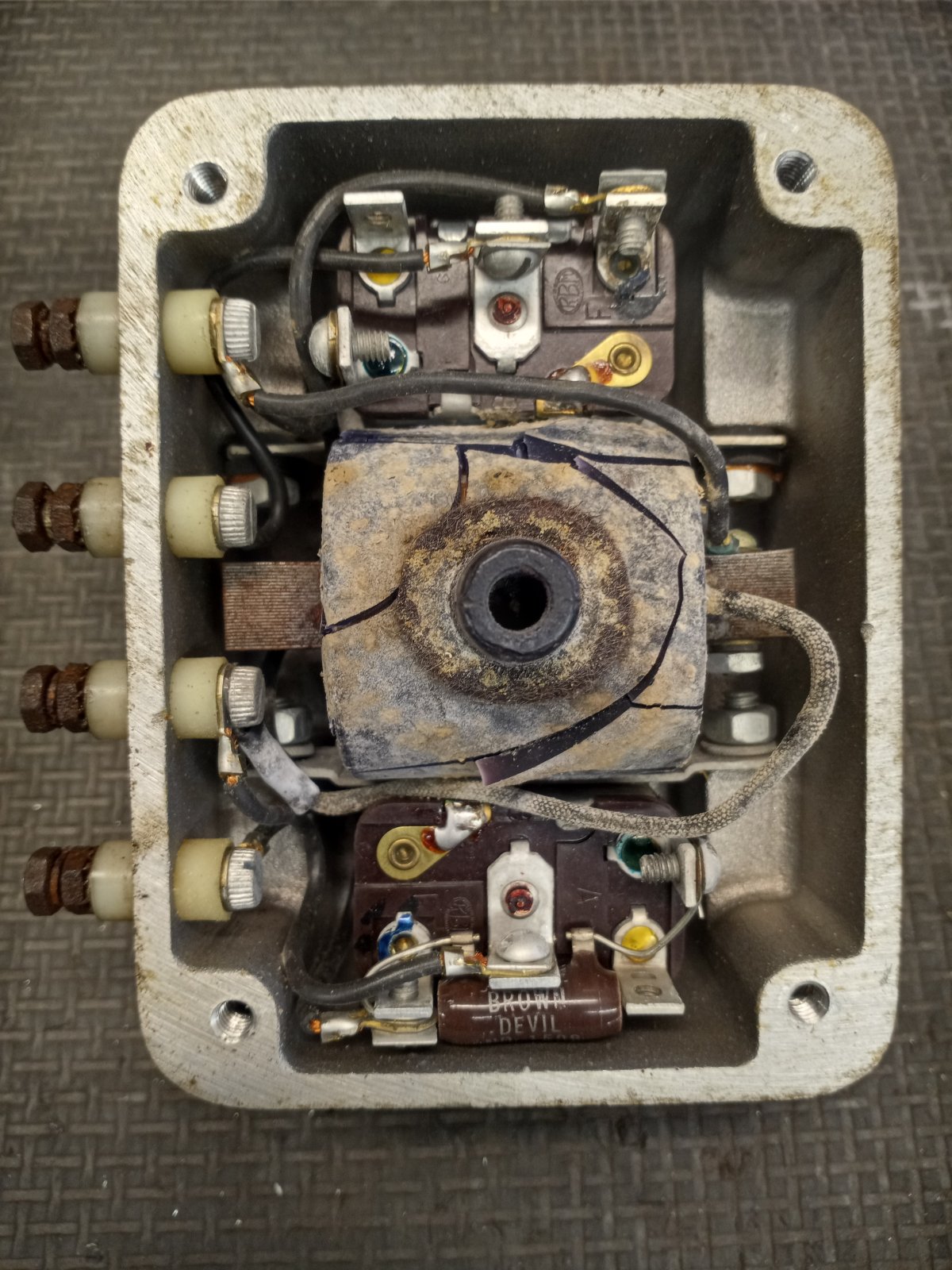

    We've had this NOS Mallory mini mag /power pak for years. I know a lot of people had problems back in the day with them, but any suggestions on a heat tolerable plastic to recast around coil, or a durable
    replacement coil to use? Closest I've found is older aircraft coil. I've talked with just about every distributor rebuilder years ago and all suggested converting it which I don't want to do. Also have an earlier one for 235 stovebolt that had coil inside power pak that needs same attention. Any help would be great. IMG_0629.jpg

    I have two Power-Paks left. One has the coil. It's slightly cracked like yours. And it has the wire out the front – what's that for?
    ( I had three a long time ago and when we opened them up, they all had different innards. You're welcome to the coil and the inside parts I might have if you can describe what you want.)

    The wire runs to distributor cap. The problem was inadequate plastic around coil along with overheating. They were impractical; but a few liked them. It's history, and I feel deserved to be refurbished; updated and used. We will see how it goes

  7. Well coils can be rewound. Not many do that any more but if you find a place that does armatures and sweet talk 'em they should be able to do it.
    If the coil is not fried what I would do is fill the cracks with silicone then paint it with Glyptal paint. That may not be the right name. Its usually red or maroon and is used for electric motors.
    Now here is another solution that I saw at a car show a few years back. A guy had one in a 57 ford. he had replaced the coil with an MSD Blaster. It was not trad in any way other then the fact that he rebuilt it using ingenuity. It worked like a champ.

    Need to keep this thread going. Here is a couple pictures of the internal coil type Mallory Power-Pak. I too am interested in a replacement coil for mine. The original coil was made by Bendix and has a terminal out of the coil body for a ligh tension lead to the center of the magneto cap.
