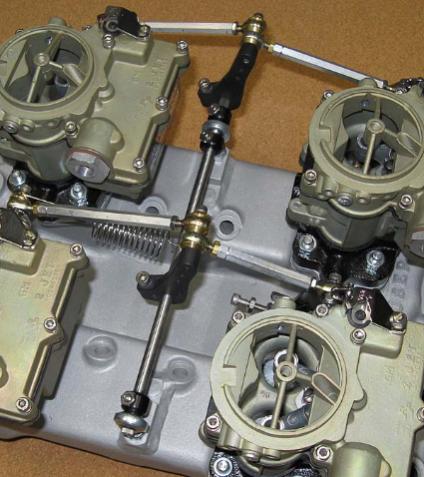

  3. joel
    Joined: Oct 10, 2009
    Posts: 2,677
    joel
    Hope these help.

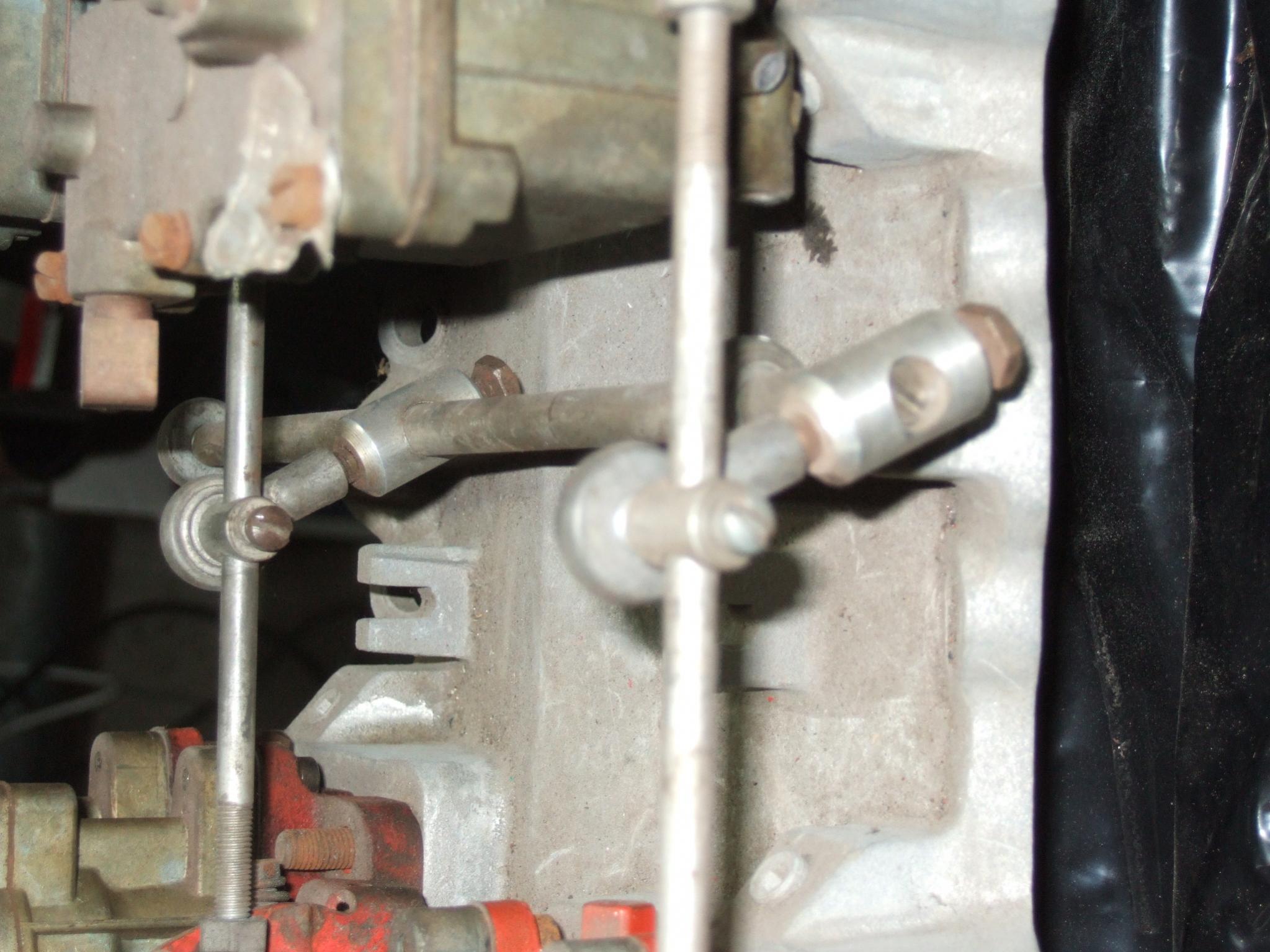

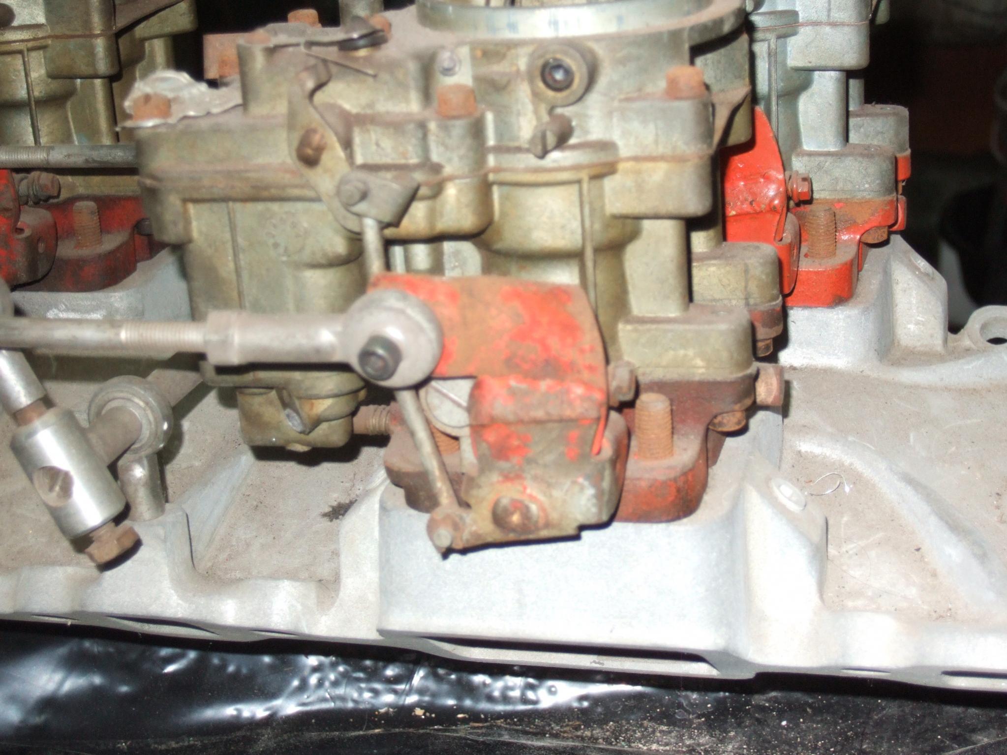

    titus
    I made the set up on mine from scratch, copied as close as i could to the original stuff, i ordered rod ends left & right hand threads, stainless rod, left hand jam nuts and a lh tap and die. then i went to it. had to have a buddy machine a couple small parts but over all it worked out nicely. and only cost me about $50
    I also modified the peices that went on the throttle shaft. trimmed off all the fat.
    jeff

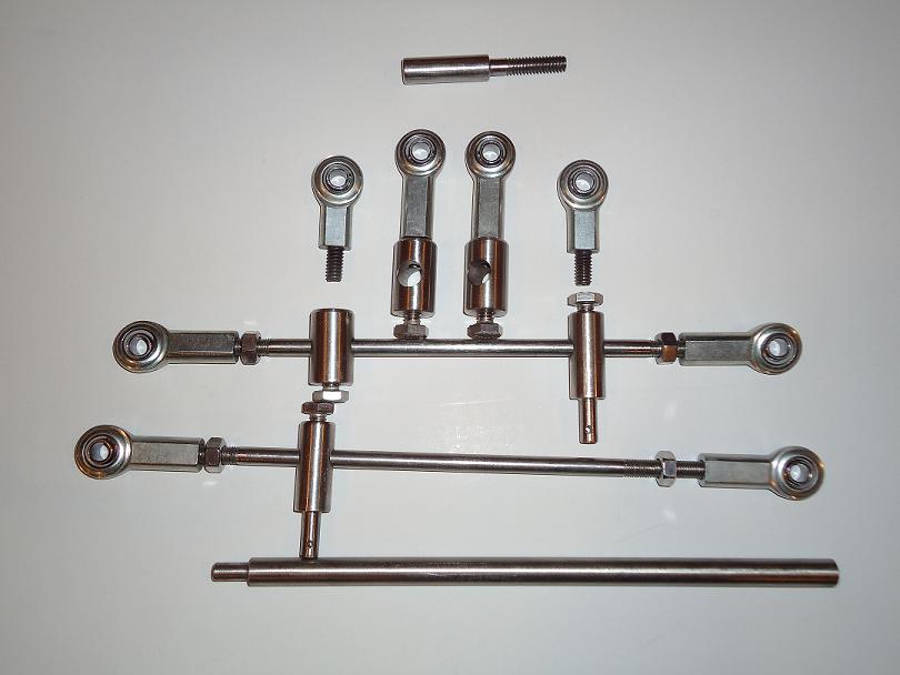

  13. oldskooljc
    Joined: Aug 4, 2009
    Posts: 812
    oldskooljc
    from Fresno CA.
    Only thing I am having a problem with is the two peaces that go over the center shaft and the two pivot himes screw into and lock on the shafts. Dose any one know if there is a peace all ready made like that or will they have to be made from scratch. Pretty much have every thing else. thanks jim

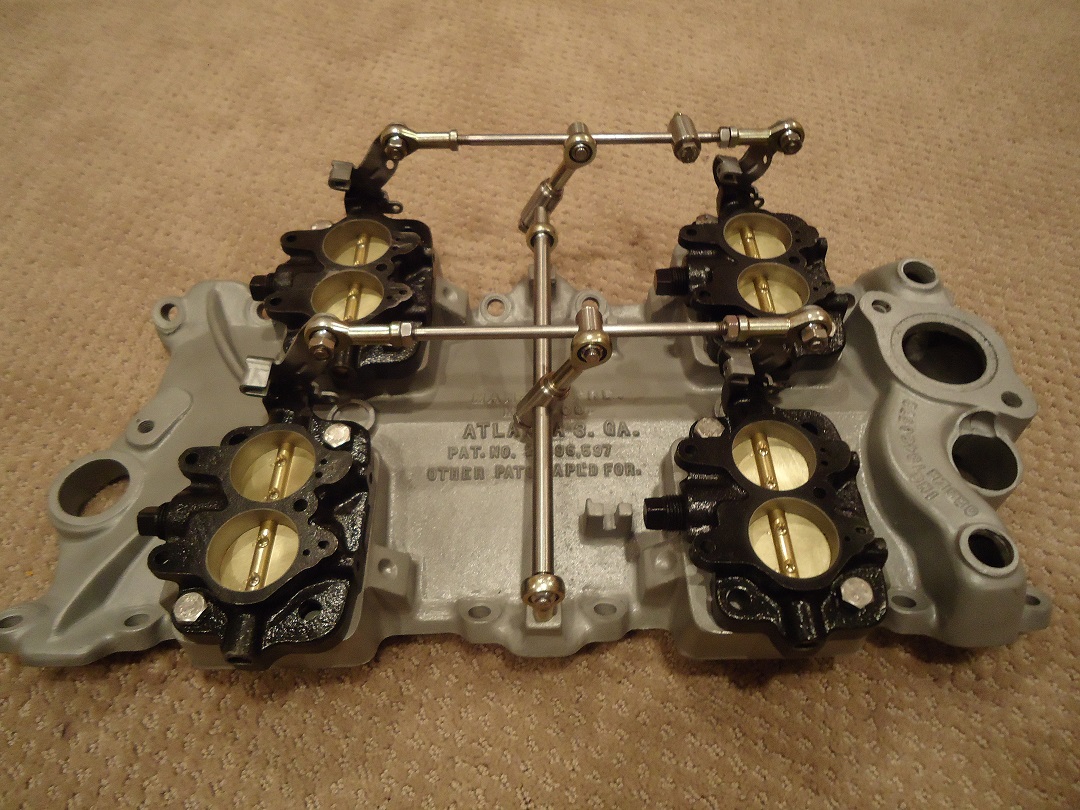

  15. jacplumb
    Joined: Nov 23, 2006
    Posts: 50
    jacplumb
    from new jersey
    Let me see if I can help, I will be making a couple of new sets in the near future.
  16. saltflats
    Joined: Aug 14, 2007
    Posts: 13,222
    saltflats
    from Missouri
    Bet that cost more than a 24 pack.
    Looks great!!!
    WHat do you have for shaft flex? It does look like larger dia.
