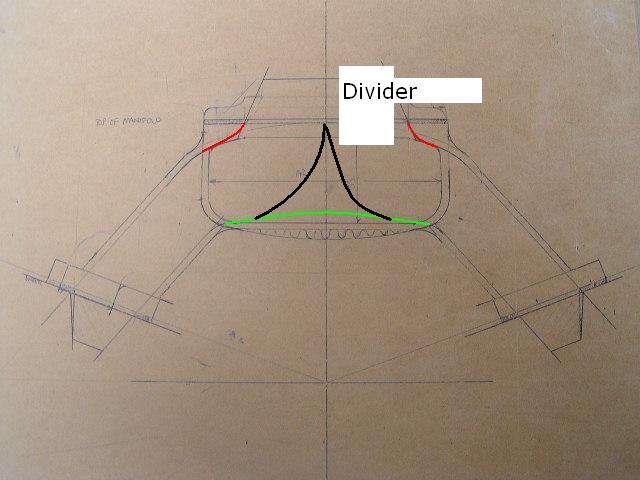

    Haven't been following this thread, so sorry if someone already brought this up. The manfold as designed is, of course, a compromise and has to fit/suit many different engine tunes and chassis types, but it can easily be made more less "universal" and tailored to your car:
    1. anyone nervous about low speed response, etc. can simple insert a vertical divider plate right down the middle (factory supplied with some Weiand manifolds). A piece of 14 gauge can just be flanged 3/8" on 1 end, bolted to the bottom, and fitted into small slots (or between small bolt heads etc.) in the underside of the base to prevent movement - it doesn't have to be airtight, so no gaskets etc. needed. This will reduce peak power somewhat, but greatly increase vacuum by reducing plenum volume by over 50%, may allow smaller jets for mileage.
    2. anyone with extra hood clearance can increase plenum volume and add peak power by adding a piece of 1" or thicker plate cut out in the middle to match the body, and installed with an extra gasket and longer studs as a sandwich. IMHO aluminum is best and prettiest, but as long as you have a good seal it could be masonite, particle board, plastic, etc. but coat it top and bottom with fuel dope etc. against gas soak and fiber shedding.

    Quite correct Panic,
    When I had the engine on the dyno I wanted to experiment with an insert in the pleum, particularly with the single four that would act as extensions to the runners to the back and front cylinders. I have seen examples of this on other manifolds of a similar design.
    As I got into the dyno test time it became clear that I wouldn’t get time to experiment at that level in the time available. I still intend to go back and have a shot at doing this and looking at the impact of controlling the space in the plenum.
    As I got a increase in HP and the power curve was an improvement on the stock four barrel manifold I figured it was a safe option to make these available and if further development proved the case for a divider I would provide them as a retro fit option.

  17. panic
    Joined: Jan 3, 2004
    Posts: 1,450
    panic
    Yes, many 2 × 4 Chrysler factory dual quad manifolds had a center divider, as do all Offy "360" manifolds. Some Weiand single planes even come with a removable divider.
    It can even be used as a tuning device - it can block off the entire plenum or only part, leave a "window" where you want.

    On the topic of a divider, The attached image shows the type of divider I intended to experiment with the two black lines is the intended shape of a removable divider that could be used.
    Attaching the divider by bolts or possibly a couple spots of weld is an option as is making it in a way that it locks in place

  19. strombergs97
    Joined: May 22, 2006
    Posts: 1,888
    strombergs97
    My concern would be to much open plenum area. Yes, higher speed which is greater demand this will work just fine..I like the snap from the start. Good looking intake. Waiting, for feed back from other owners..As panic mentioned, the performance of this intake will differ according to lots of variables..
