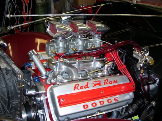

    Here are some pictures of Dodge Red Ram Intakes 241, 270, low decks..One is Offy from Hemi Hotheads..The others I had custom built..
    Duane..

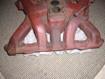

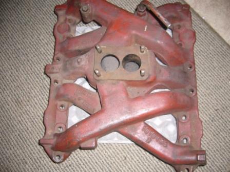

    Got given a two barrel manifold with the following number on it 1619724. This could be a dodge hemi or a? Anybody go any ideas
    Cheers
    Peter
  7. TR Waters
    Joined: Nov 18, 2006
    Posts: 1,439
    TR Waters
    from Vermont
    I cant find that number in my books. Can you post a picture?
    Tom
  8. strombergs97
    Joined: May 22, 2006
    Posts: 1,888
    strombergs97
    Peter, if it's shorter then the Desoto it is most likely a Dodge..
    Duane.

    Hi,
    Photos as discussed
    Any help appreciated
    Cheers
    Peter
  10. TR Waters
    Posts: 1,439
    TR Waters
    from Vermont
    Peter,
    It appears to be a Dodge. If the distance between front bolt holes is approximately 8 1/2", it will fit a low deck 241 or 270.
    If it measures approximately 10 3/4", it fits a tall deck 315 or 325.
    The casting number indicates a 1956 date.

    I believe that it is for the low deck, I'm not sure if the high where out in 1956..
    Duane..
  12. 38 mopar_fan
    Joined: Sep 10, 2006
    Posts: 223
    38 mopar_fan
    Thanks Tom,
    Friend of mine was delivering some spare parts to the Chrysler club parts room and in an effort to make some space found it. He grabbed it and poked it in my direction.
    Width wise it looks the same as my 330 Desoto manifold going to pull my manifold off and see it if comes close. Would be easier to build a new one with slightly smaller runners but able to take the same top plates.
    Don’t know if its worth the effort but I’ll think on it.

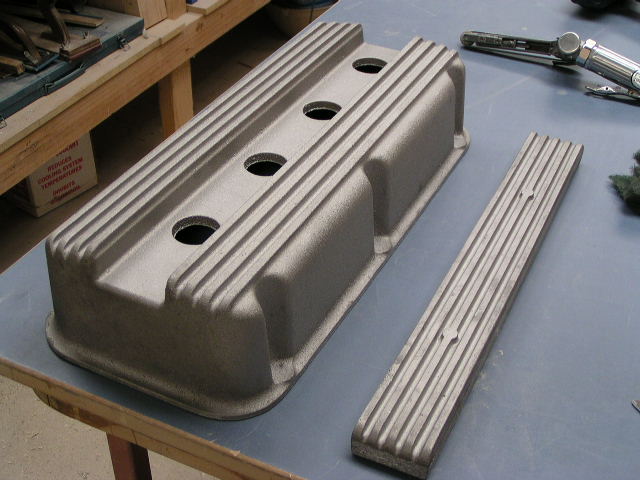

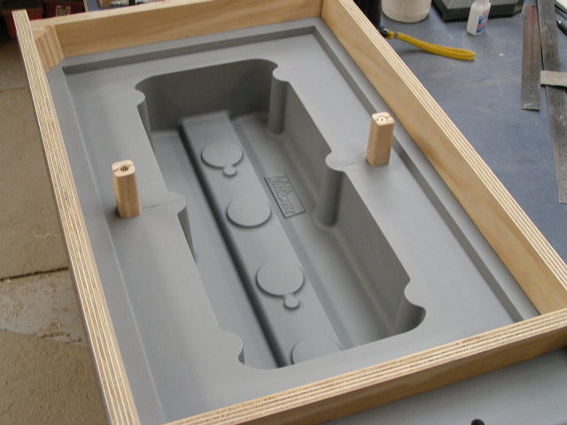

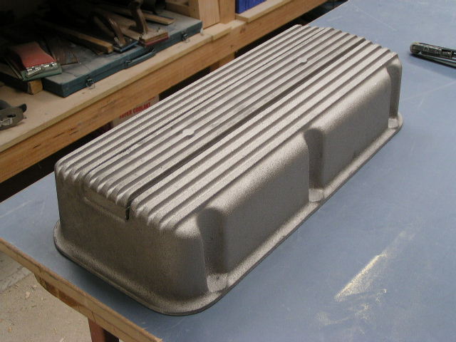

    Well I couldn’t resist putting up a couple more photos of the rocker cover patterns. They are now at the foundry awaiting the first trial casting.
    The blower conversion is progressing and will get some photos up as soon as possible.
    Cheers

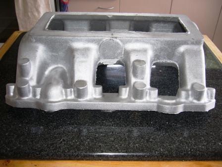

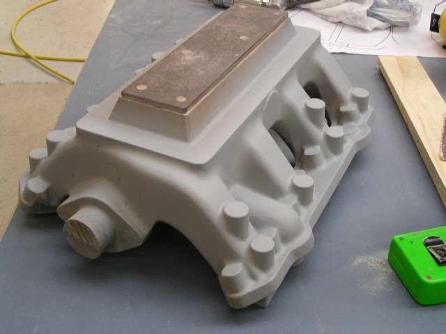

  14. 38 mopar_fan
    Posts: 223
    38 mopar_fan

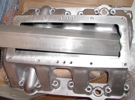

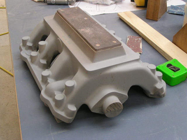

    Well guys, The moment of truth, For those hanging out for the blower adaptation to the manifold have a look at the following photos. We have included injection bosses and two support mounts that will have a leg from the top plate to provide extra support.
    The pad for the blow off valve is between the runners hardly noticeable.
    Let me know what you think as these will become permanent fixtures on the manifolds.
    Cheers
    Peter

  18. 38 mopar_fan
    Posts: 223
    38 mopar_fan
    Hi Rat,
    At this point they will all be fitted with the injector bosses. Wanted to have three options available but the cost of producing a copy of the complete pattern was prohibitive. With limited numbers being produced /purchased I couldn’t recover the cost
    To date I have provided one demo manifold, have one on my motor and have sold 10 manifolds. I have another three ready to sell. The pattern will be back at the foundry next week and we will start the process again.
    About 5 people have indicated they want a blower manifold. So development cost v returns is high
    Cheers
    Peter

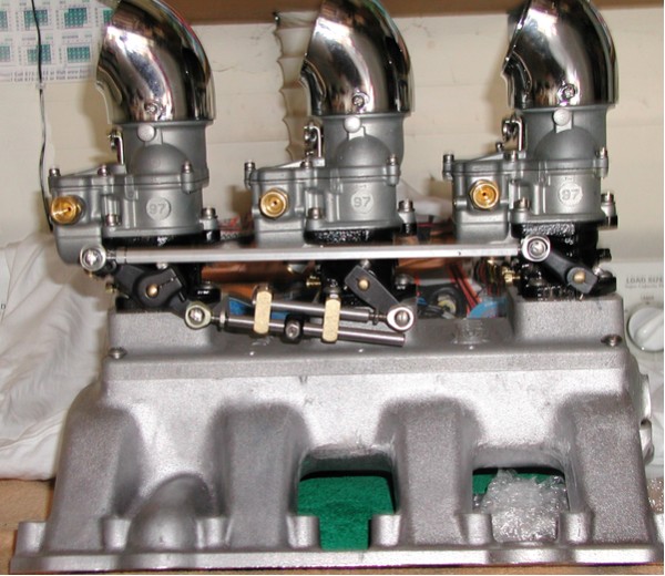

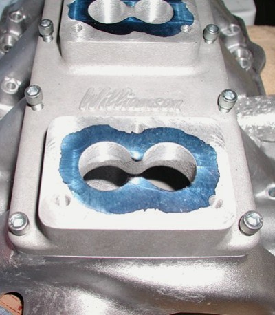

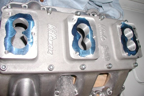

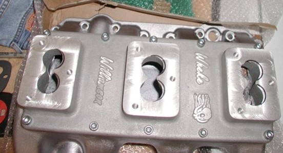

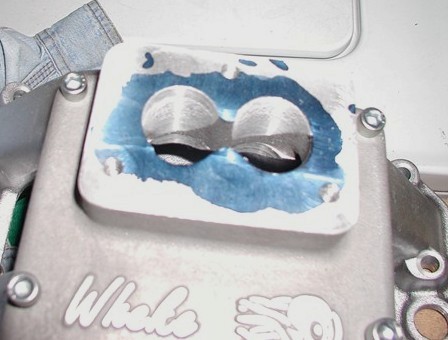

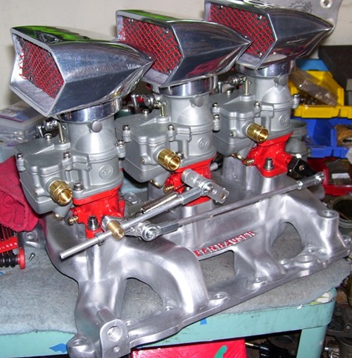

    Well, I received my 3x2 intake from Peter and must say this is really nice work, looks great..
    I got Peters permission to post some pictures of the work I needed to do to make the base of a 97 or 94 ventures be clear of any intake obstructions, air/fuel entering the intake. I first used a gasket, then I used bluing and bolted a Stromberg 97 bare base and scribed the ventures. I set it up on my friends BridgePort and machined all the ventures. You can the see the amount we took off. I also needed to do some filing in the plenum area..With this done there is no restrictions for the air/fuel to enter the plenum area..
    The 2" angle aluminum can be mounted inside the plenum area, welded or screwed..After talking to several performance people the difference would be minor at low RPMs, no difference at High RPMs.. My choice is not to put the aluminum in due to a couple of reasons, I don't want to get the intake to hot when welding,(have no idea what will happen to the intake flanges or the top flange, warping???), Screws, could come loose and OUCH)..
    I believe that this intake will perform "VERY WELL", in a mild street engine. Three Stromberg 97s at a CFM of 150 will work just fine..I would like to build progressive linkage and use the two outside 97s as primaries and the center as a secondary. If I were to use the center 97 as the primary not sure how the engine would like only 150 CFMs, might run lean..I don't know if the Desoto could take all three of the 97s at the same time..I WILL FIND OUT..
    I hope this info helps others..
    Again, this intake is extreme..Very nice work Peter..
    Duane..
  21. DEAN JONES
    Joined: Aug 14, 2008
    Posts: 17
    DEAN JONES
    from muncie in
    How about epoxy for the insert? Dean

  23. strombergs97
    Posts: 1,888
    strombergs97
    Hello, are you talking about the 2" angle and epoxy it in..Would you explain more..
    Duane.

    Well, I couldn't wait till morning so started last night with the linkage..Not a lot of modification to get it too work smooth and kick in the secondaries..Throttle plates on the secondaries catch up (2 to 1) to the primary and open all the way and of course close all the way..
    I really enjoy doing this...
    Peter, your intake is beautiful and will work very well..
    I tried to take some of the roughness off on the underside too see what the finish would look like..That aluminum is hard..
    Going to auto supply and get a thermostat housing, looking for a swivel type in case any issures with water hoses..
    Duane..:D

    OK...I'm thinking that 150 CFMs might not be enough fuel until the secondaries kick in????????? I think maybe running them all at the same time..Or outside 97s as primaries and the center as secondary..
    OK, need feed back...
    Duane..

  30. 38 mopar_fan
    Posts: 223
    38 mopar_fan
    Hi,

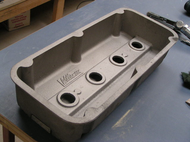

    A couple of Photos of the first valve covers out of the mould. Don’t have a final price yet as the guy doing the casting costing has gone on holiday for the week.
    Got the first blower modified manifold in my hands and going to start machining it this weekend but the way the financial markets are going looks like the demand for manifolds is gone.
    You can see the bosses to provided added support the blower and the injector bosses for those asking for them to be fitted.
    Going the pickup the top plate today to see how it all comes together
    Cheers
