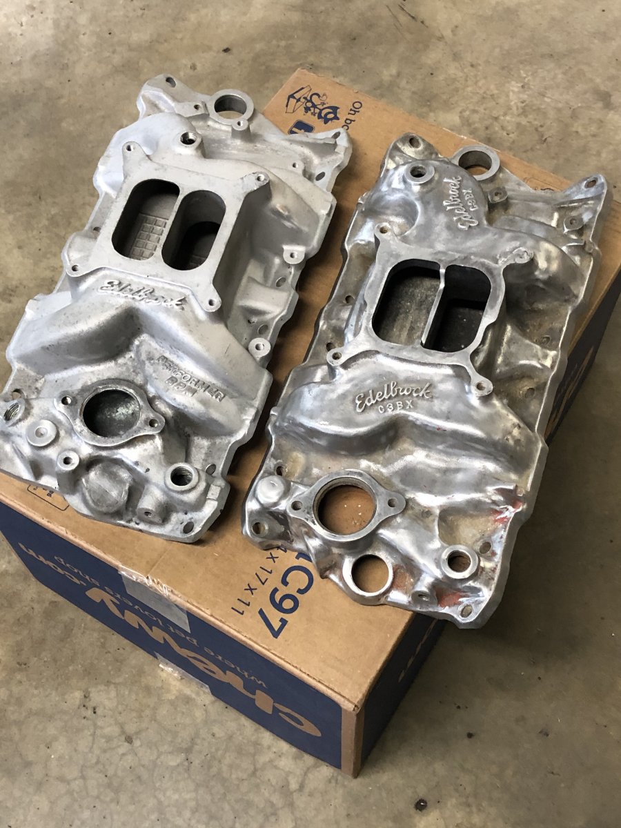

  9. C2E21163-9447-496E-A49E-984CBB295700.jpeg I’ve got a C3BX,,it is very similar to that one.
    Also,,,,a PerformerRPM,,,,,,here is a side by side comparison.
    The rpm is on the left,,,,although both are dual planes,,,,the rpm is a half inch taller.
    Also,,,you can see the port runners are contoured a lot different.
    The rpm runners are more narrow and taller,,,,where the C3BX runners are very wide and shorter in height.
    I ***ume the rpm ,,even though it was a dual plane,,,it allowed somewhat higher flow for more power up high ?
    Tommy

  10. Moriarity
    Joined: Apr 11, 2001
    Posts: 38,114
    Moriarity
    SUPER MODERATOR
    C3BX is good too. the three are about the same. there is no room to run an HEI dist because the runner runs too far back. But that is ok, because nothing ruins the look of a traditionally styled engine compartment more than a gawd awful giant HEI dist....
