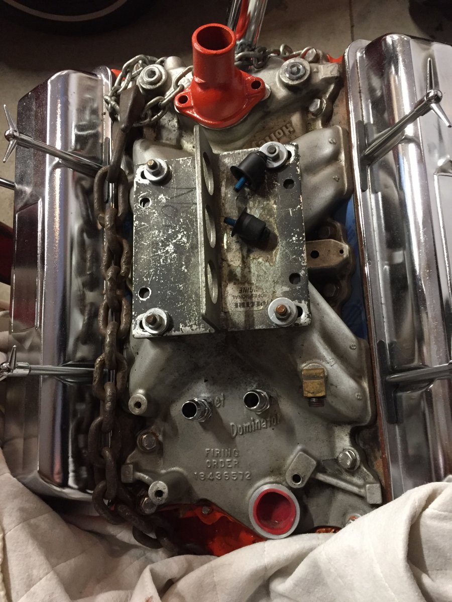

    Later model 350 block with an early Holley Street Dominator (single plane) intake that had the oil fill tube, swapping it in the 48 that has a Mr Gasket header crankcase evacuation system so tapped it for 2 ******s. IMG_3446.JPG

    From experience I can attest that the oil fill breather alone is not enough, I tried that on my old Henry J motor and it was trying to push gaskets, so you've definitely got to think that through if you want to run valve covers without breathers
