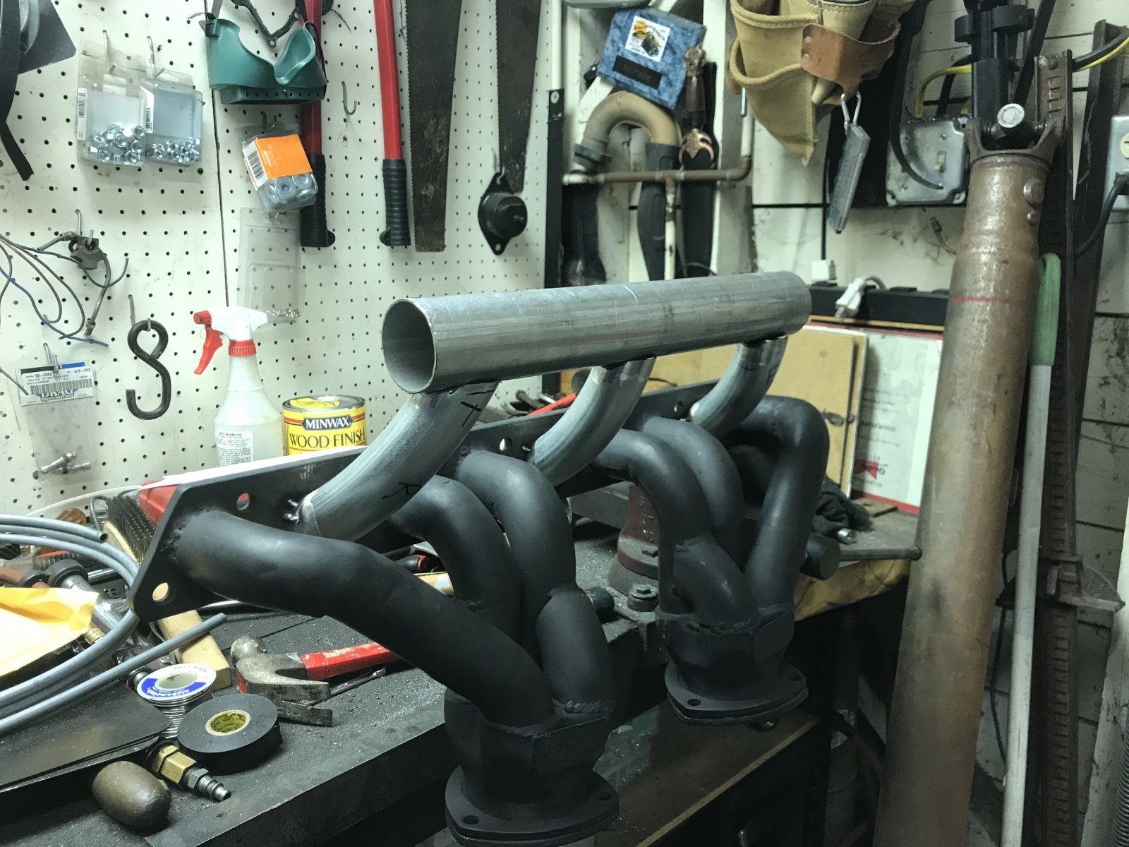

    @Stogy 's right, it's very much an experiment, and if it doesnt work, i'll try something else. It is largely an amalgamation of studying an array of period factory, aftermarket and homemade intakes for inline engines as well as some new ones being built that use a log style plenum. I think it might look a little bigger than it is, the tubing and plate i used was 1/8" wall, making the the interior height just a hair over an inch. The pair of Big 97 Strombergs should be about 500cfm, so not too crazy for a 320ci ohv engine. If i could have found one that i could have afforded, i would have tried to get an old Edmunds Custom one but it would have been an expensive experiment to see if it fit around the homemade exhaust manifold.

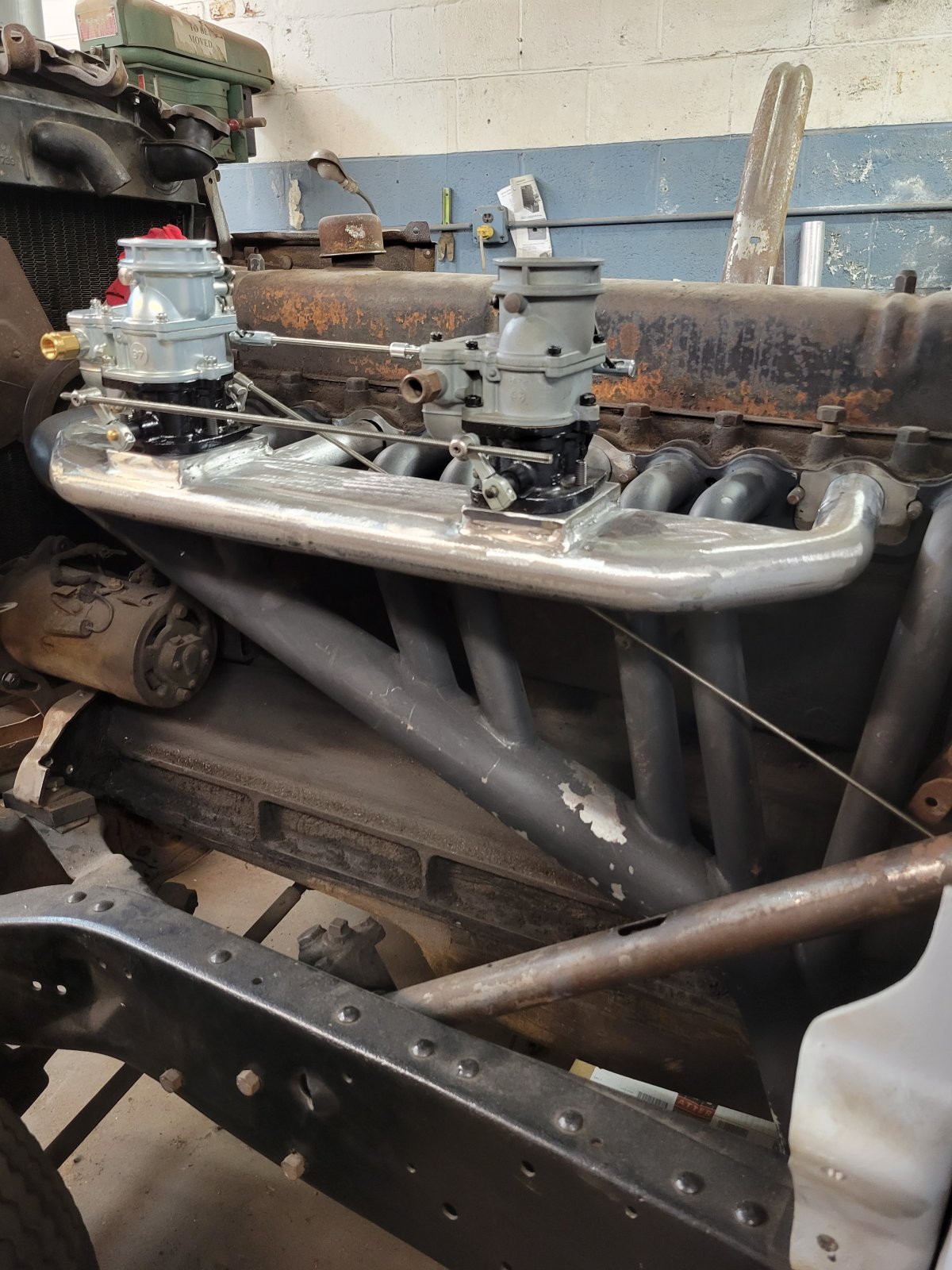

  11. Work In Progress
    Joined: Dec 14, 2010
    Posts: 197
    Work In Progress
    The one I made works surprisingly well...
