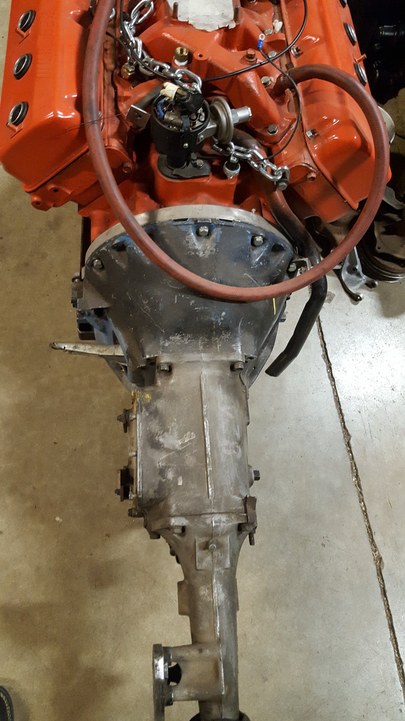

  10. I've answered this question at least 10 times on here with the same photo. My theory is always K.I.S.S. This is all Mopar except the adapter. No mix-n-Match and everything works as it should. Will-Cap adapter. Stock small bock bellhousing, flywheel, clutch and starter with an 833 bolted back in place. Hurst 4 speed shifter looks right at home in the Truck.
    I should add that I redrilled 340/360 flywheel to 8 bolt and it indexed right on the Will-Cap spacer. Simple as that. It lives in this.

  20. Additional information. There are several versions of an 833 unit. Mopar made 3 different ones. What LLoyd has is a GM style. Yes they are generally the same inside. No, they are not a direct bolt together across brand lines. It's not like a T-350 is a T-350 (in fact there is a couple different models of them also). LLoyds 833 will require the same adapters as any GM 4 speed to bolt up to your Hemi. His bellhousing helps a little but you have no way to mount a Starter motor. Better do some homework before you dive in.

    At the risk of taking this "off topic", Pist-n-Broke's approach can be easily updated for someone that doesn't intend to go drag racing and wants an OD trans. You will still need the adapter.
    You can use a some what easier to find bell, modern flywheel, clutch, and trans from a Dodge truck with a V6 (has a smaller flywheel prior to 1994) or a V8. They have the same transmission bolt pattern at the motor (except for one bolt that can be left out). Most of these use a hydraulic slave cylinder clutch release set up (which solves a lot of clutch linkage problems). You can use the flywheel (with the re drilled crank holes) and the clutch that matches the bell you have, and use factory replacement parts. That opens the door to the NV 2500, NV 3500, & NV 4500 OD 5 speed transmissions which all bolt up to the bells.
    The NV2500 is the "light duty" version. It has a very good gear spread, and can take some occasional light abuse. Probably not a good choice if drag racing is in the plan, but for a cruiser with an OD, its a great option.
