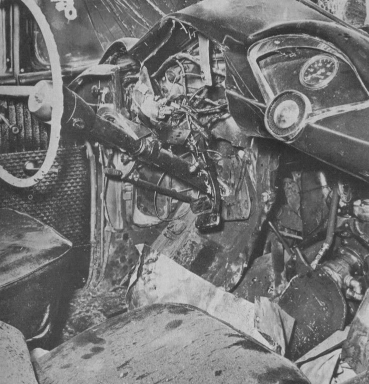

  17. 29Av8 i've seen that dash before at a stop light in town here, stock flywheel took out the dash and windshield no one was hurt,283 with a 4 speed

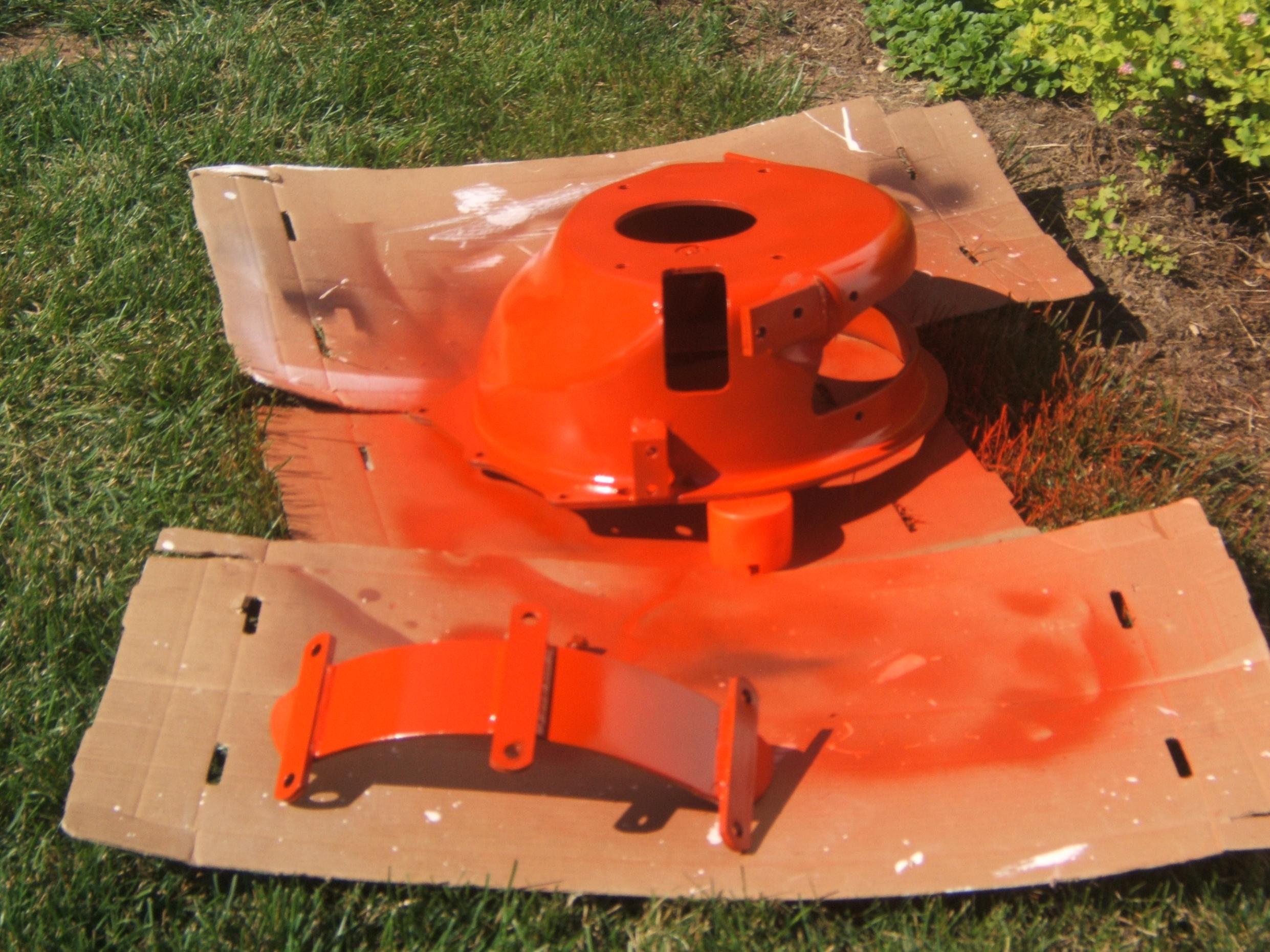

    I don't know what brand this is, found it on eBay years ago. It's now in my 37 Ford with 388ci SBC in front of Muncie M22.
    I don't know if it would pass current NHRA requirements, but I liked the removable inspection cover at the bottom. The opening was large enough to change clutch assembly later without having to pull the engine.

    The Pic. of the 55 or 56 Chevy dash looks almost like one that our 55 race car did back in 1969 , we did not have the $$ for a scattershield ,even though they were not that expensive. I would NEVER run a 3 pedal car W/O one no matter how many R.P.M. it might go to. I like my feet & legs to stay with the rest of me,and after the one blew on the ole 55 it made a lifetime believers out of us.
    Do yourself a favor,and install a scattershield.........block saver too if you can !!!
