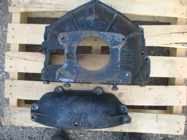

    I picked up an old Ansen cast iron NHRA bell a few months ago. I lucked out too - had all the correct pieces & ansen bolts & block saver plate.
    Not SFI, but I don't care. The hole is dead center, & the lower half removes.
    Almost need a trans jack to install it. I would guess it weighs around 75 pounds

    anyone using an ansen on chev? if so what does it take for flywheel and starter? 168 tooth?
