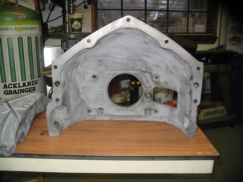

    I'd build an external shield that bolts to the bellhousing mounting bolts. We used to build them back in the 60's when we couldn't afford a ****tershield, and they perform the same function of protecting your feet. Just needs to cover the sides and top area, so if it blew it can only go down.
    Something like this, but with mounting tabs to attach under the bellhousing bolts:
  14. 1971BB427
    Joined: Mar 6, 2010
    Posts: 9,816
    1971BB427
    from Oregon
    That's actually a pretty simple idea, and worth the effort to avoid an incident. Making a steel shield that's shaped to fit the trans tunnel around the bellhousing and just bolted through the floor would protect you as well. Just let the sides hang down lower to protect your feet.

  18. stimpy
    Joined: Apr 16, 2006
    Posts: 3,546
    stimpy
    all it takes is that one time for a spring to fail or the pressure plate or a ring gear to crack . hate to say but a blanket will not stop a flywheel or pressure plate or cover, gears yes as they are smaller and lighter , not 30 pounds , only steel or heavy aluminum plate will as it disapates the kinetic energy as it deforms .
    the minimum I would say is look up the sfi specs for a rotary engine car flywheel cover .
    also when you build it you want air space between the metal parts and the car body as this allows the metal to have room to deform more ( like tank armor is built ) and expend the energy . remember its harder to cut a board holding it with your hand not supported than when its backed by the bench .
