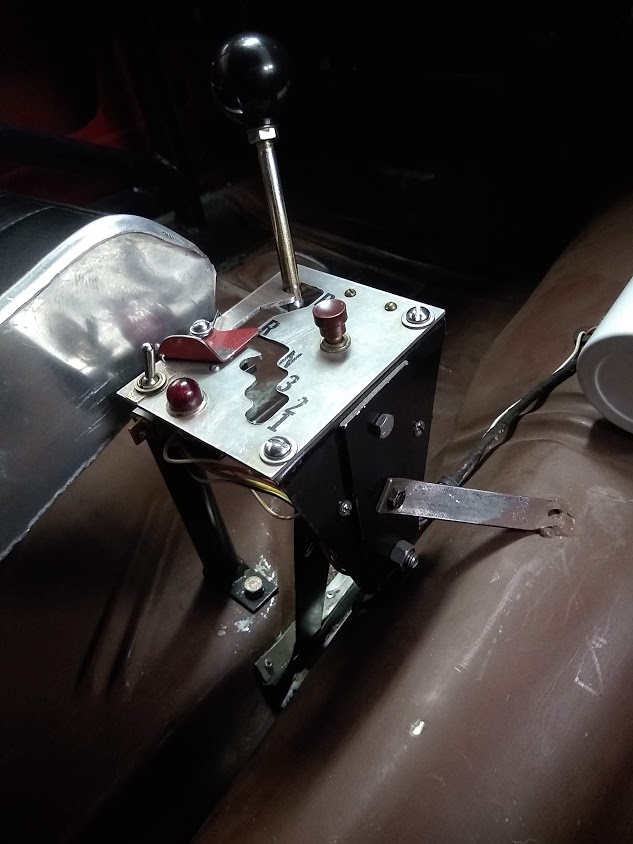

    33k miles on this one, full manual 400. Not a problem. Also has a switch pitch converter up front with a toggle switch, and a GV overdrive behind it with a manual engagement ****on and a tricky relay. So I get to do all kinds of fun things with the shifter.

    oh...also keep in mind that there are reverse pattern manual valve bodies, which are kind of tricky to deal with on the street.

    Does your turbo 400 have the extra neutral below 3rd gear?
    I see yours has the regular pattern.
