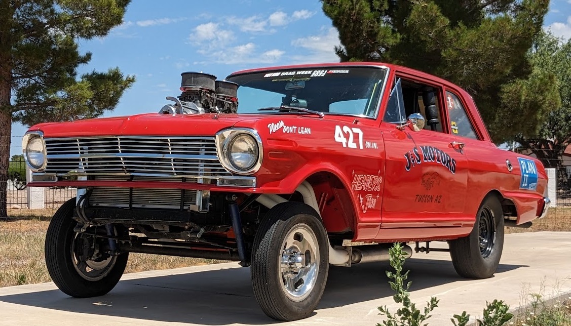

  21. mad mikey
    Joined: Dec 22, 2013
    Posts: 9,460
    mad mikey
    I run a SBC with over 6x95 HP. True street strip old drag car raced in the 60's
