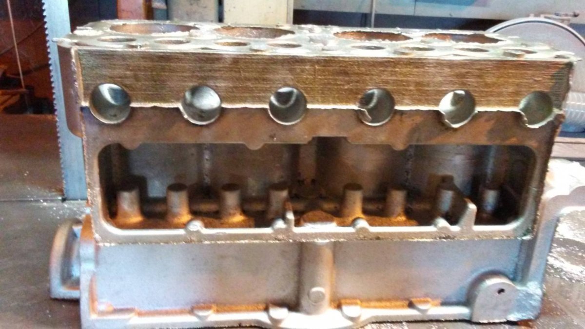

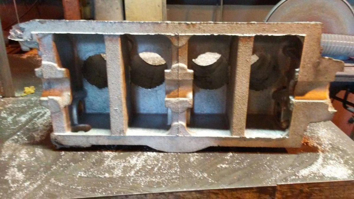

    Tod Buttermore's 1st 5 Main Aluminum A block
    17157406_264955803931103_6376037325350443283_o.jpg 17159268_264955813931102_4362539273424210264_o.jpg 17192055_264955840597766_5403687120700050108_o.jpg 17239915_264955847264432_3209218053756958259_o.jpg
  3. Tod's Alum block looks great and He was listening.

  4. RussTee
    Joined: Mar 25, 2008
    Posts: 1,241
    RussTee
    yes listened and has done a great job will await cost and avaliability of cranks

  6. waxhead
    Joined: May 11, 2013
    Posts: 1,172
    waxhead
    from West Oz
    Tod just said over on the FordBarn that he might talk to Scat about a suitable crank.
  7. Tom will be happy to make more, we have had no issues with them.
    Just pulled a crank out after two years thrashing, using the bearings again.

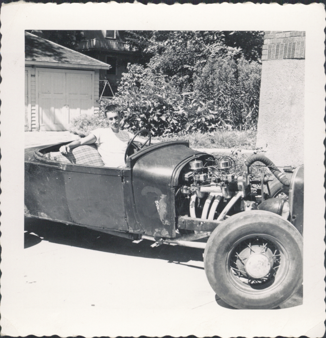

    You can choose #1. If your mag has an advance mechanism you need to set your engine to the number of degrees before top dead center you want to fire at, perhaps 7 degrees. This can be done easily by googling "degree wheel", printing out one about the diameter of your crank pulley and glue or otherwise stick on, then making a pointer from wire or whatever to fasten to the block or timing cover and bend to point to 0 degrees no matter where it is on the pulley. Then back the engine (CCW) to your 7 degees before TDC or 93 degrees on the degree wheel. Then assuming you have set the magneto point gap properly, put clean piece of thin paper or a .002 feeler gauge between the points and rotate the mag opposite the direction the rotor turns when engine turns (CW) until with a steady light pull on the paper or feeler gauge the points just begin to open.
    There are a bajillion Model A timing posts on the net, this is my down and dirty method from my first ride in 1950 below.

    Cool roadster. The Phaeton is going to have plaid seats too, as its my favorite color.[emoji4]
