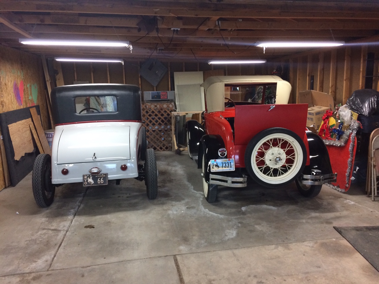

    It was a nice spring day today so I was able to drive both Model As. Took the wife and daughter for a nice cruise in the roadster then took the coupe out for a short spin. Have to take advantage of nice days this time of year. Snow is forecasted for my day off on Friday.
