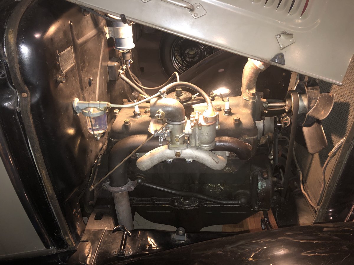

    This is as low as I can get the idle without stalling.
    Sound about right? Too high?

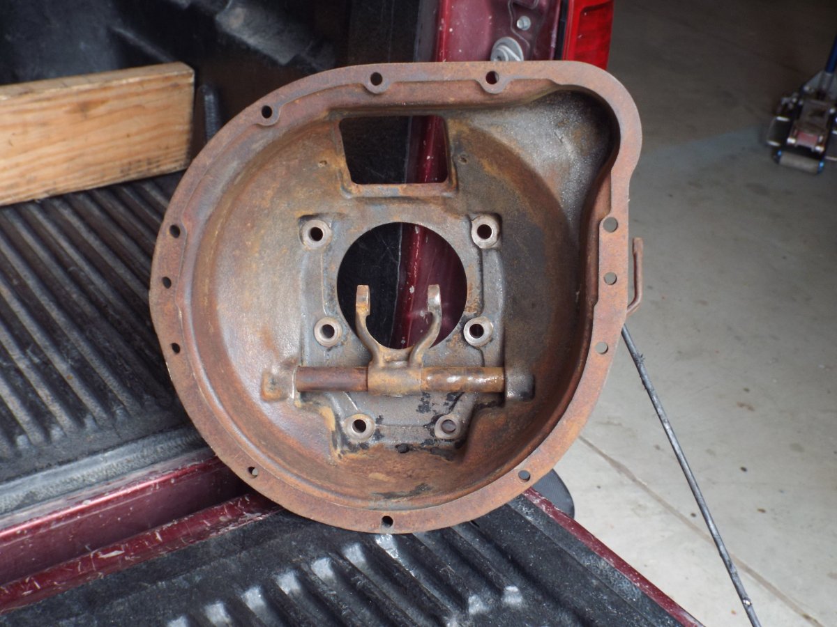

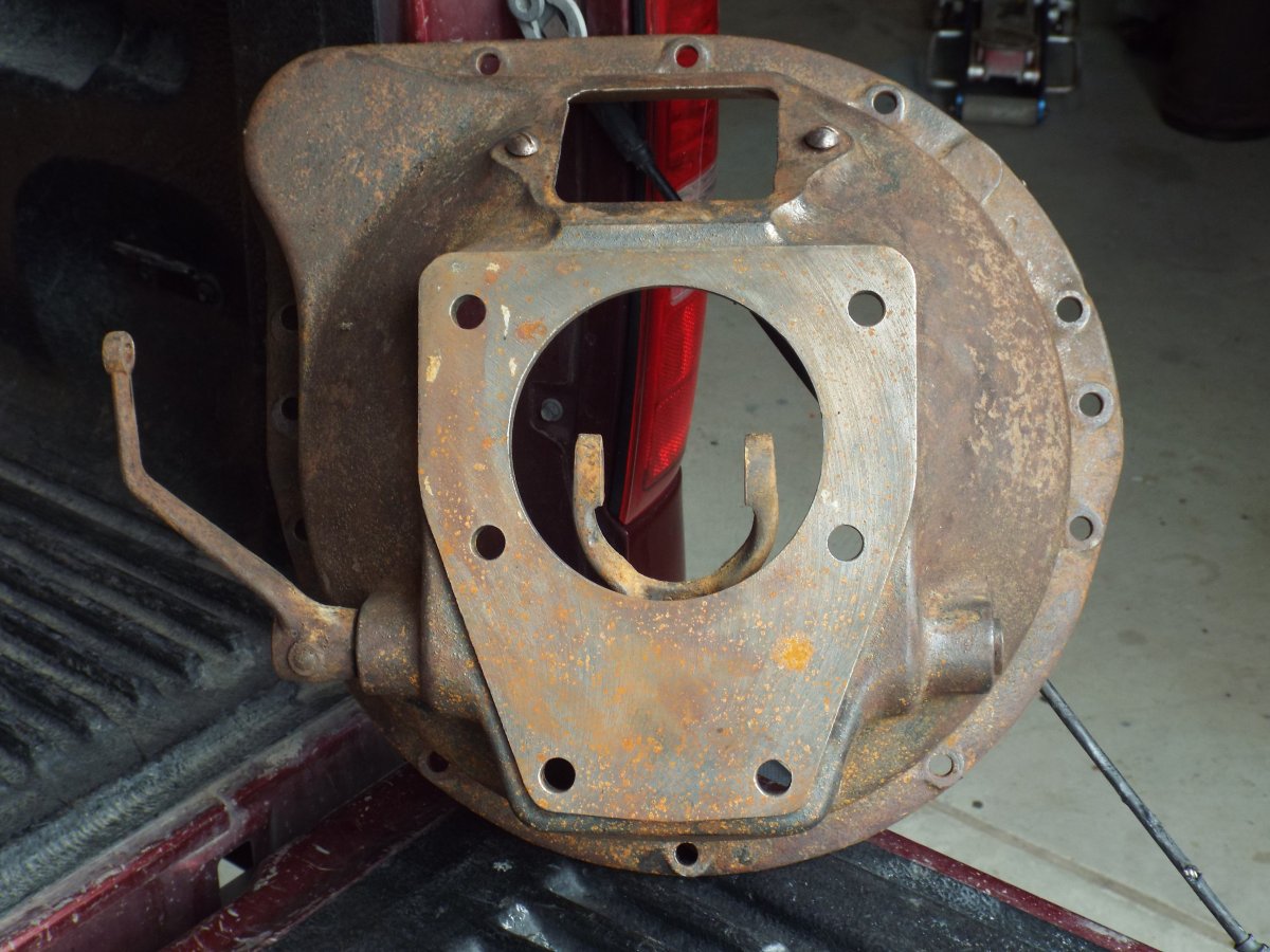

    Here are pictures of a BB bellhousing. 5 1/2" deep

    Your Winfield idle speed sounds perfect....I have the same setup, (Winfield SR-BB carb and manifold) for my Model A that I have not installed yet. Did you happen to record the number of clicks open from closed for the three adjustment screws? That will help me a lot to set up my carb when I install it.

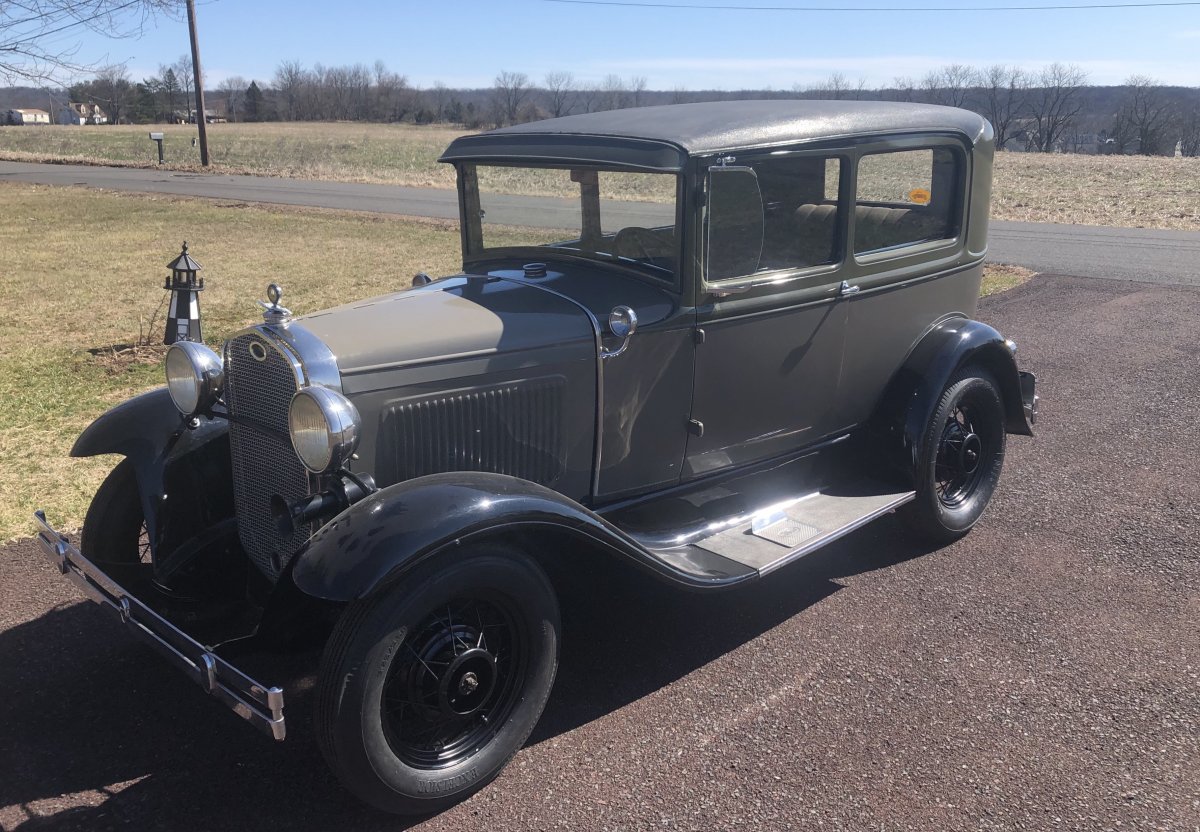

    Mine is actually an SR-B.
    I bought a few of them at the same time and eventually plan on selling the others. All matching and rebuilt.
    Anyway, took it out for a while yesterday and have determined that I need a fuel pump.
    Or if someone out there has a G marked float (gravity), I’d love to buy it from them.
    Anyway, I didn’t write down the settings.
    If you need the adjustment procedures.
    SR
    https://www.nwvs.org/Technical/2104WinfieldSR.pdf
    S
    https://www.cl***icandexotic.com/manuals/winfieldscarburetor.pdf
    I put some new wheels and tires on yesterday as well
    Need to get some caps.
    Old Dawg, Dannerr, winduptoy and 2 others like this.
  20. joemac05
    Joined: Jul 29, 2006
    Posts: 510
    joemac05
    I love it... Where would a person find wind wing windows these days
  21. studebakerjoe
    Joined: Jul 7, 2015
    Posts: 1,260
    studebakerjoe
    Joemac05, those look like brooklands screens turned sideways. I could be wrong though.
  22. Snyders, Macs, Brattons,...
  23. walls
    Joined: Oct 6, 2005
    Posts: 652
    walls
    They were on the car when I got it.
    They aren’t high quality, so I ***ume they’re from one of the common model A suppliers.
    One good thing about them is the curved mount ensures the gl*** stays in place.

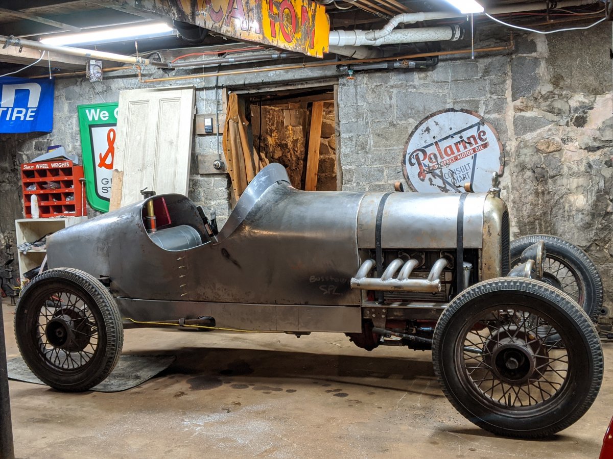

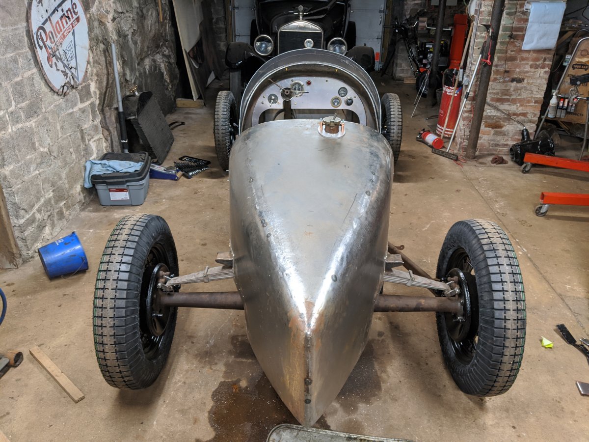

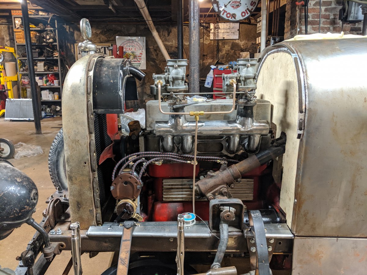

    IMG_20191108_202430.jpg 00000IMG_00000_BURST20191123155819309_COVER.jpg IMG_20200127_181328.jpg Hey y'all. First time caller long time listener. Here's my model T engine. It's equipped with a Gemsa OHV head, A crank, pressure fed, 9:1 compression. It's currently torn down and undergoing some changes I'll list soon.
  26. Shane Lach
    Joined: Mar 9, 2020
    Posts: 5
    Shane Lach
    The engine, built by Joe Gemsa, had an unblanaced shortened A crankshaft installed. The babbitt was hammered so I am having that re-poured. While apart, I am going to install a counter weighted full length A crankshaft due to other peoples experiences with shortened cranks breaking. At teardown, I found the T transmission beat badly. Multiple cracked drums and torn up bands. I made the decision to hunt down a Frontenac oil pan and model A transmission adapter. I hope to buy a crank, clutch, and send the block out for babbitt next month and get this car to drive this year. It has been a 2 year project thus far.

    Man, that looks just right. I like everything about it.

    I was about to ask what will you be doing to hold all that compression from hurting things down stream. ;):D
    Nice car!!!!!!!!!

    Thanks guys. This gem just arrived in the mail yesterday so soon I can finalize my driveline like shaft length and radius rod mounting points since I can see where the transmission tail will land. IMG_20200309_182126.jpg IMG_20200309_182636.jpg IMG_20200309_183701.jpg
