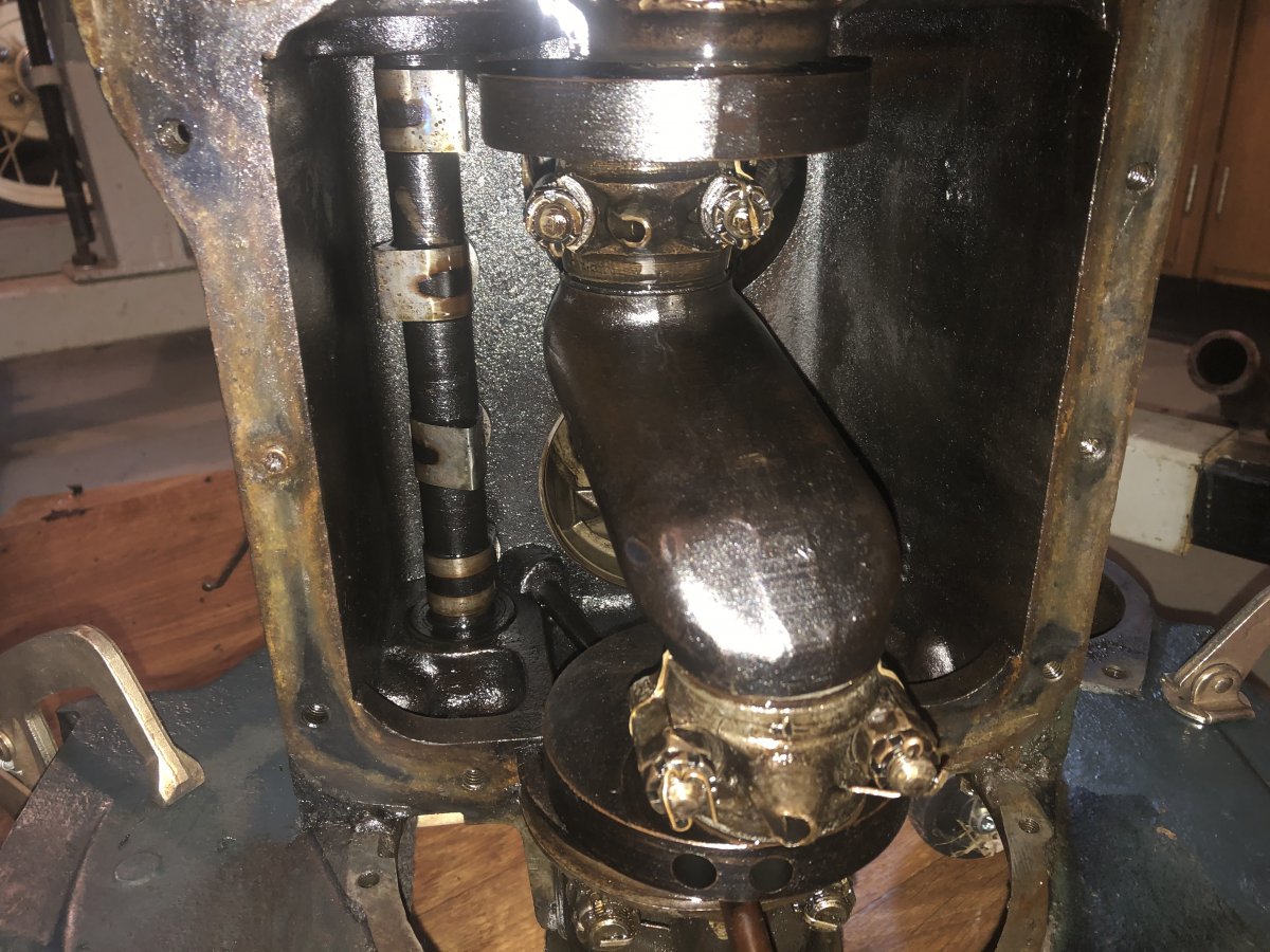

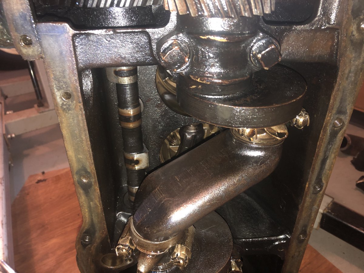

    Check the babbitt clearance maybe, adjust the shims if needed? I can tell you it's a pain to do that under the car. Looks good on the video and in the pictures.

    @walls I'd for sure check the drain tube on the rear main to make sure it is clear of anything to keep it from draining....that and make sure it is tight and won't fall off

    i would check center main !!! most wear is there . crank flex's and gets the center main ......

    I would check and adjust all the bearing clearances. That timing gear set needs to be changed too.

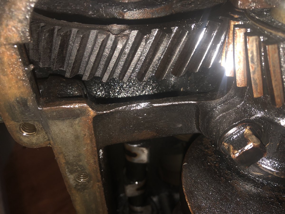

  6. walls
    Joined: Oct 6, 2005
    Posts: 652
    walls
    I was wondering about the timing gear.
    Has two chips in it.
    Suggestions on whether to replace it with the fiber or aluminum gear?

    I went with aluminum, and cheaped out and kept my stock crank gear. I know folks recommend buying the matched pair, but I couldn't afford it. Maybe I just got lucky, but mine runs nice and quiet, no issues so far.

    Anyway, use an aluminum cam gear minimally. Steel crank gear instead of fords 80 old cast iron too.
    If you are flush with $, pop for bronze and matched steel.

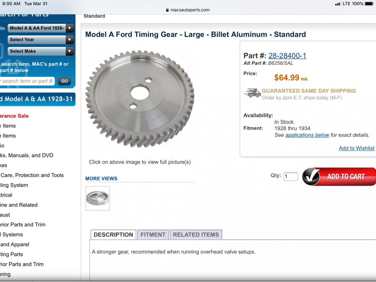

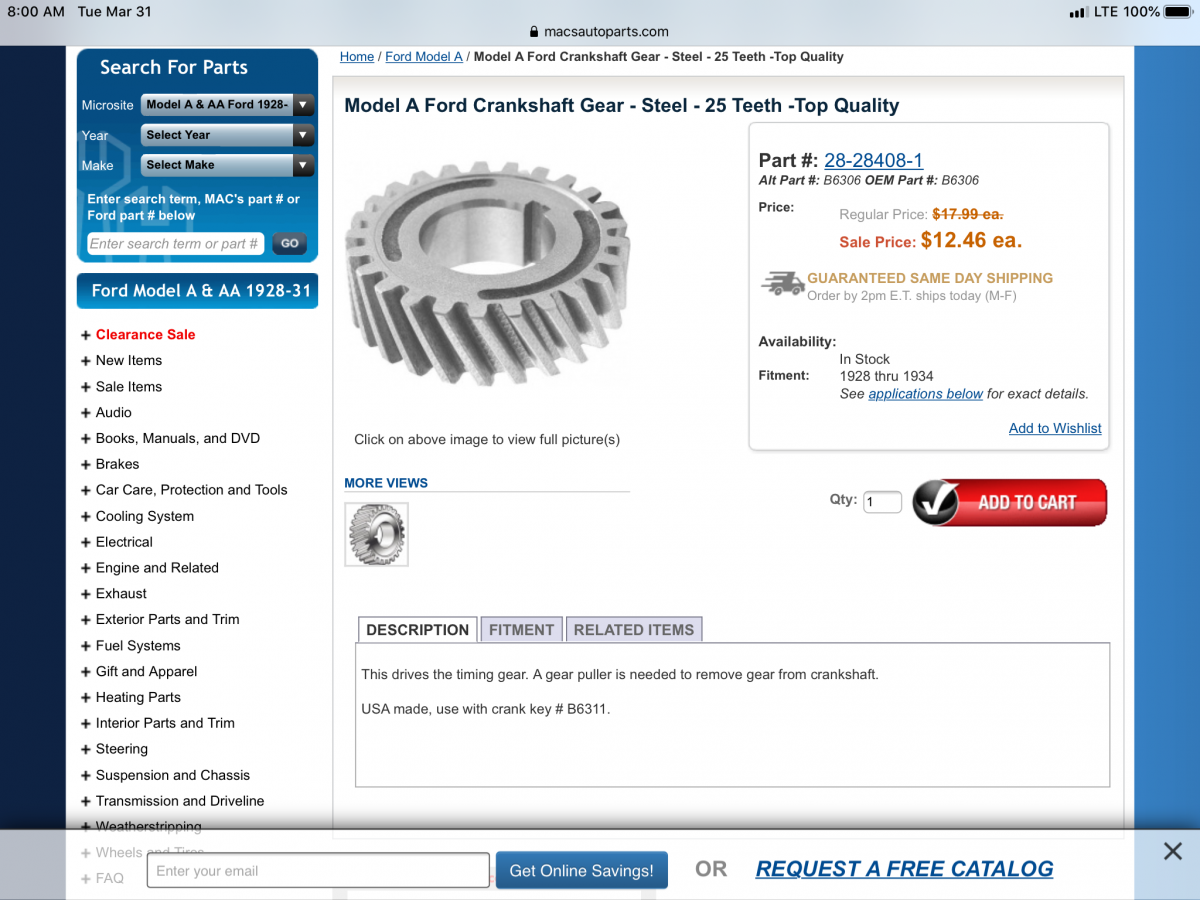

  12. walls
    Joined: Oct 6, 2005
    Posts: 652
    walls
    Yeah bad video, was trying to light the inside of the engine with a flash light while recording.
    Looking at the normal suppliers, no one sells a matched set.
    Figuring both are stock size, these should work, no?
    56AE6187-F888-4F49-A0AA-84A1239CD9F3.png D42C1190-0924-4E33-BFAF-A4BF1916A873.png
