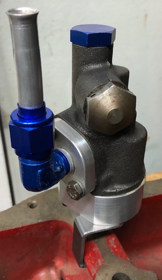

    Going to need set of pistons , an oil pump and set of head studs. What pistons do you use ?
    Q: are you making pumps yet ? Talked to Cliff !
  2. Happy Birthday!!
    Pistons, Ross custom design
    Pumps, yes, I have a few in the works, just not finding decent donor gear sets. I can use new Melling but the cost is prohibitive.
    John

    Cliff used 59 AB units. I would collectthat type for him. He had a box of partially worked pump parts when he quit. Maybe you dont use those tho ?
    “all pumps are not the same, even new”...he would say. Then he would show me voids in the cast iron ‘no good’ cases and gears. I should have bought a dozen then. Who knew what was to happen in our lives ! Oh well.
    If you get a spare made... let me know. This Burtz will be my last I’m sure. Stipe used to make an aluminum one. I used one many years ago in my Russian B.

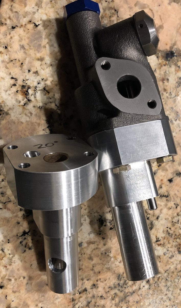

  5. Yeah, the pumps Cliffy could make were great, have used many. The supply is drying up and the castings are harder to find.
    What I am doing is using the later short pump and making an adaptor to invert the pump.
    This solves many issues including the casting issues. Now the issue is finding good gear sets to use.
    John

    You are a creative SKILLED builder, indeed !
    Looks that you are going to use to the original pick up tube and screen, eh ?
    Haven’t seen anyone else with this design. Looks bullet proof.
    What gears/years ?
    Some guys using chev gears.
  11. the pump is 49-53 I think, with gears.
    stk pickup can be modified but I like this better...
