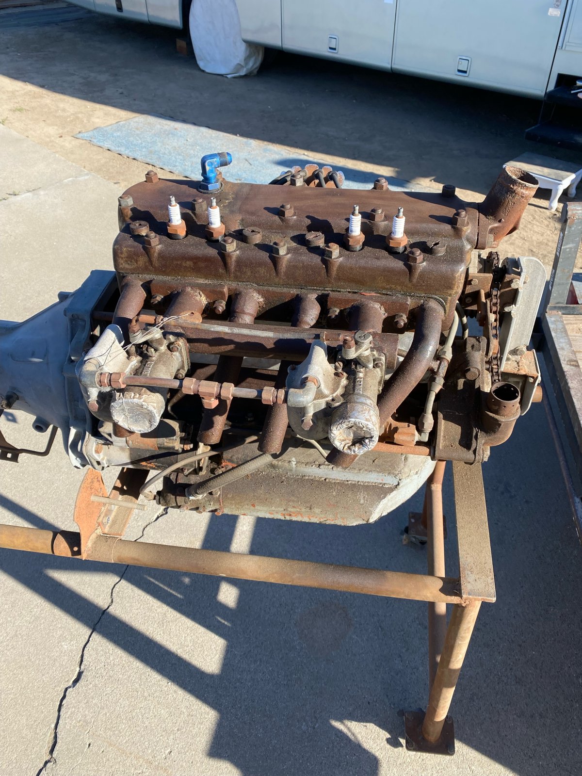

    Got mine out and about for the first time at the weekend. Took it across the border into the USA for an event. Feels good to be out and about in it!

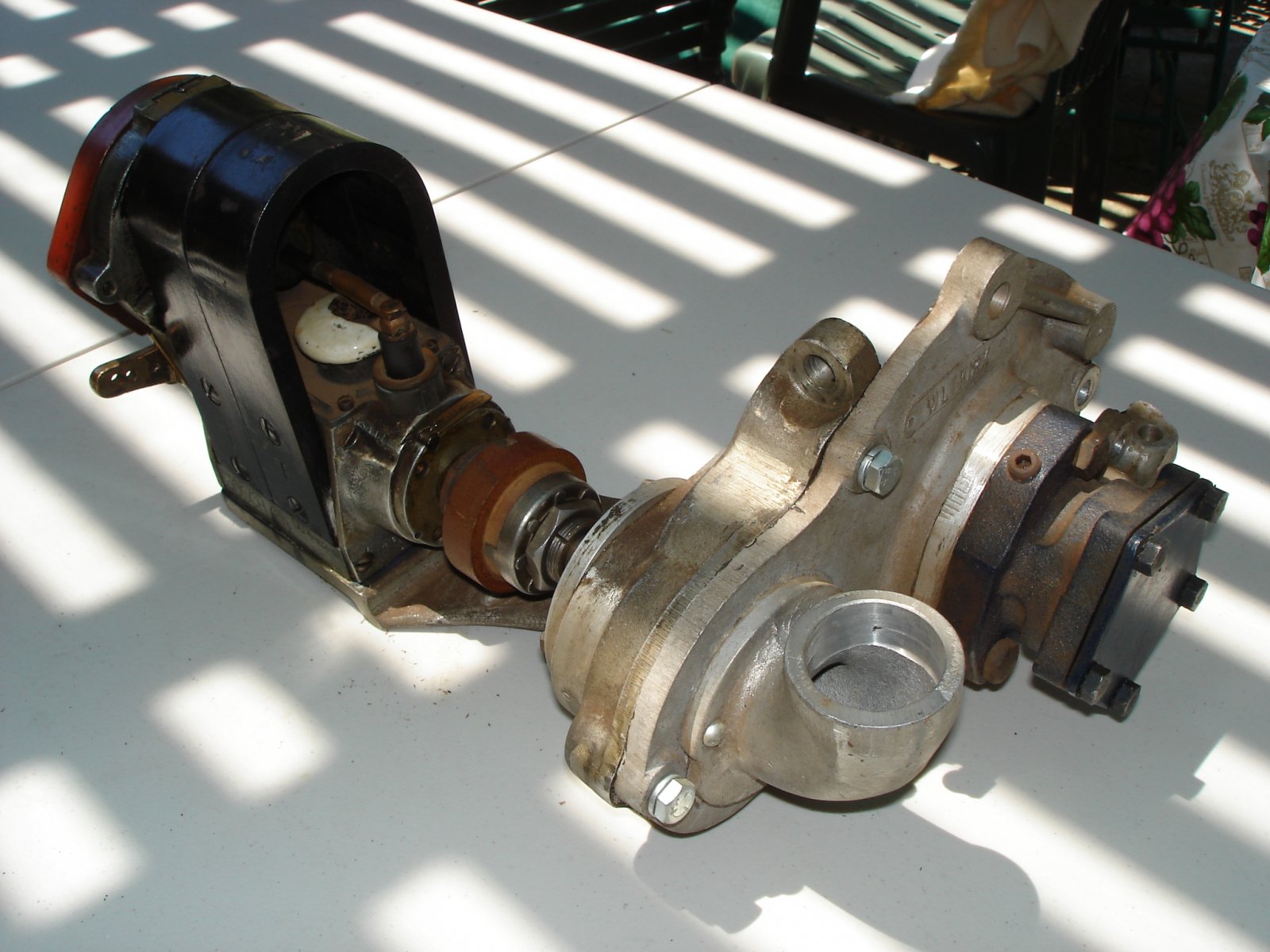

  13. Despite just getting the shipment of aluminum side timing covers, I am back to learning.

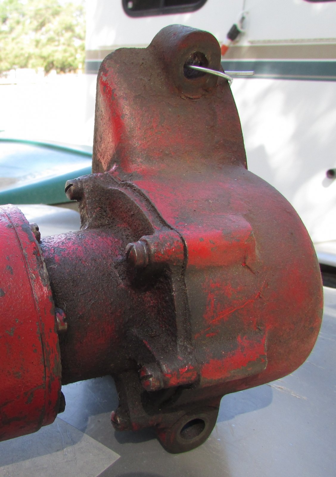

    Currently I want to create a side driven magneto. From what I've been told mags like to be driven at crank speed. Does anyone have any photos of a side drive that I can use as reference, or any advice? Ideally I would love to reproduce something similar to the "SM" Smiley Martin magneto drive.

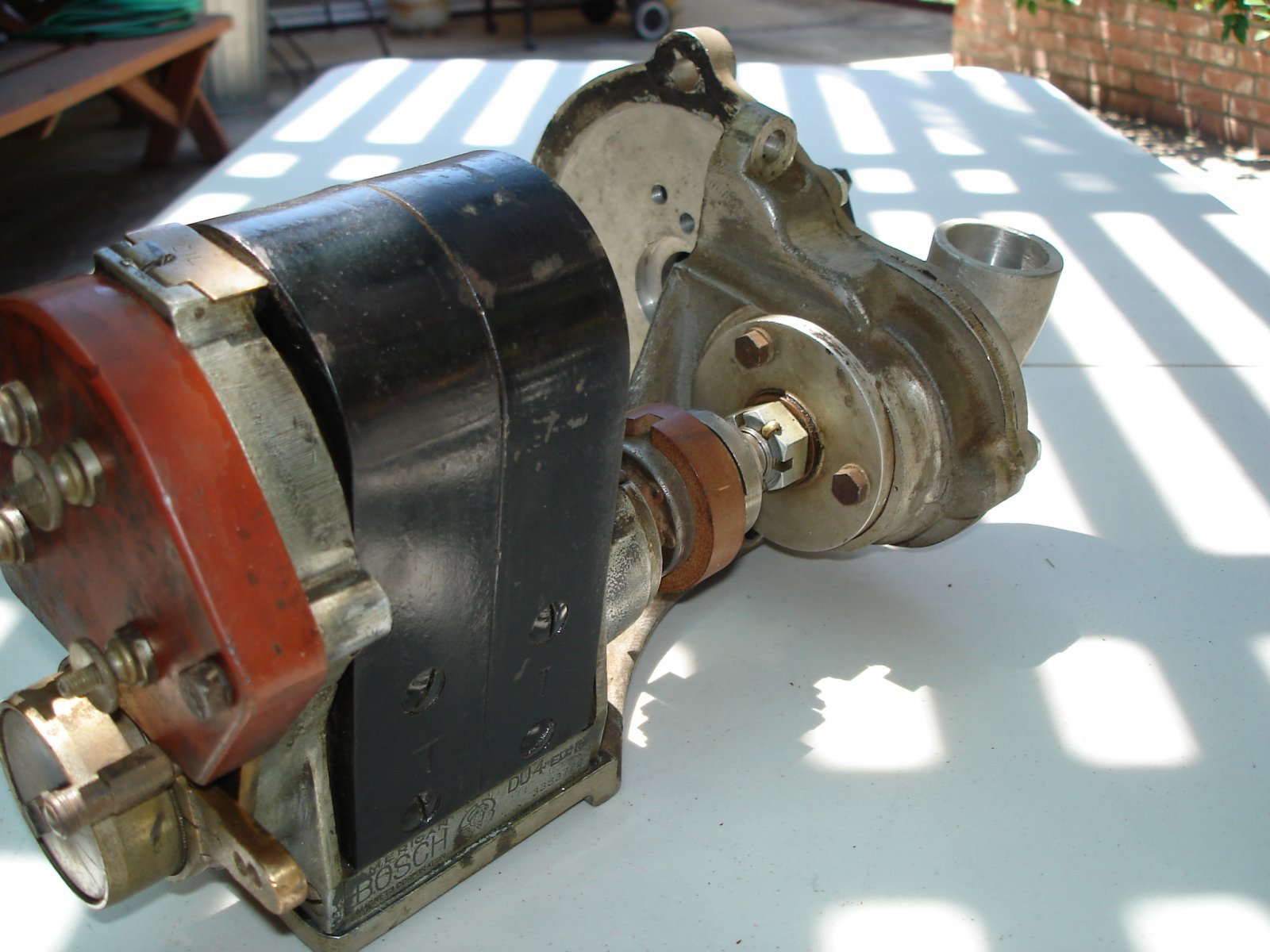

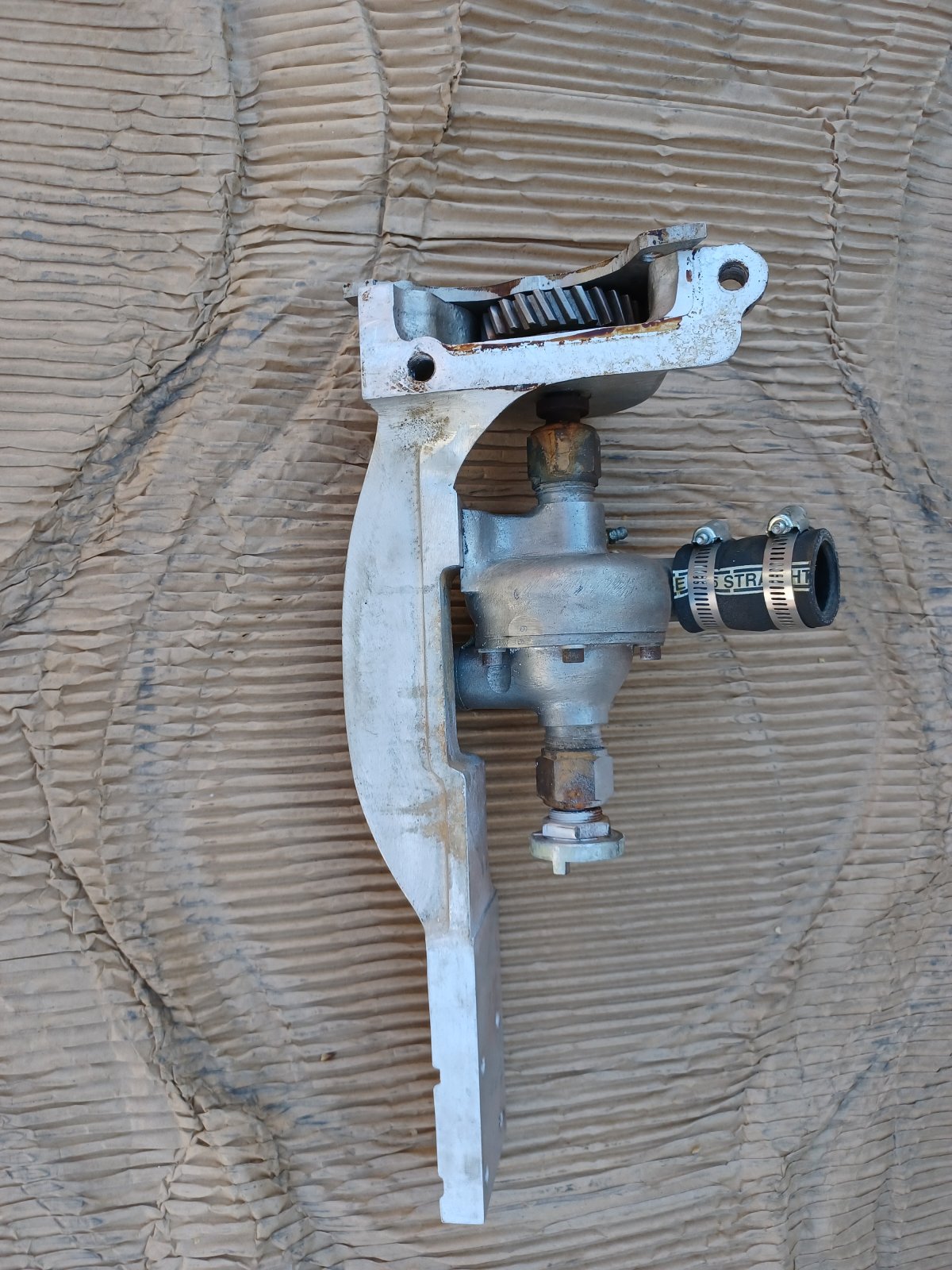

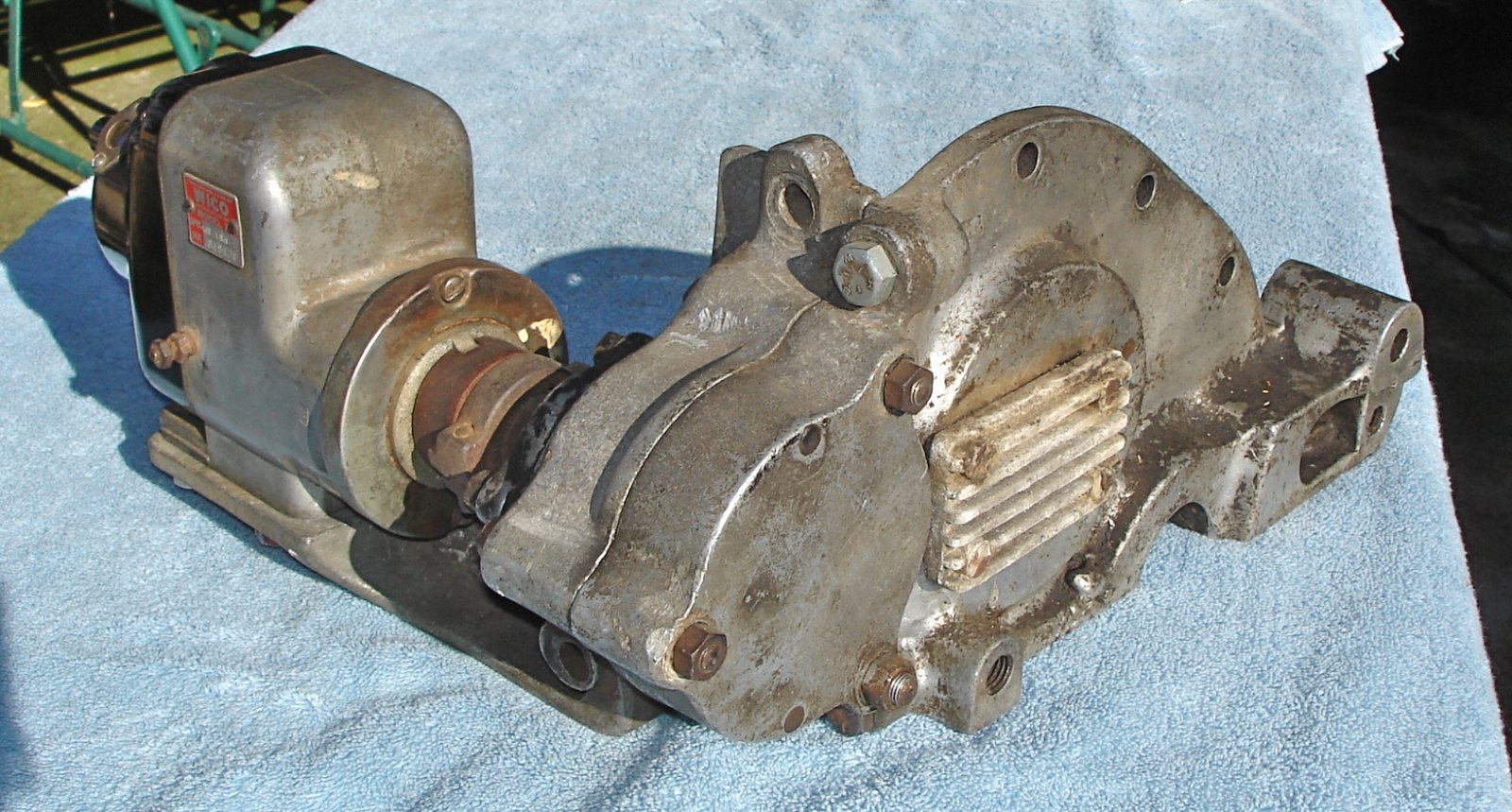

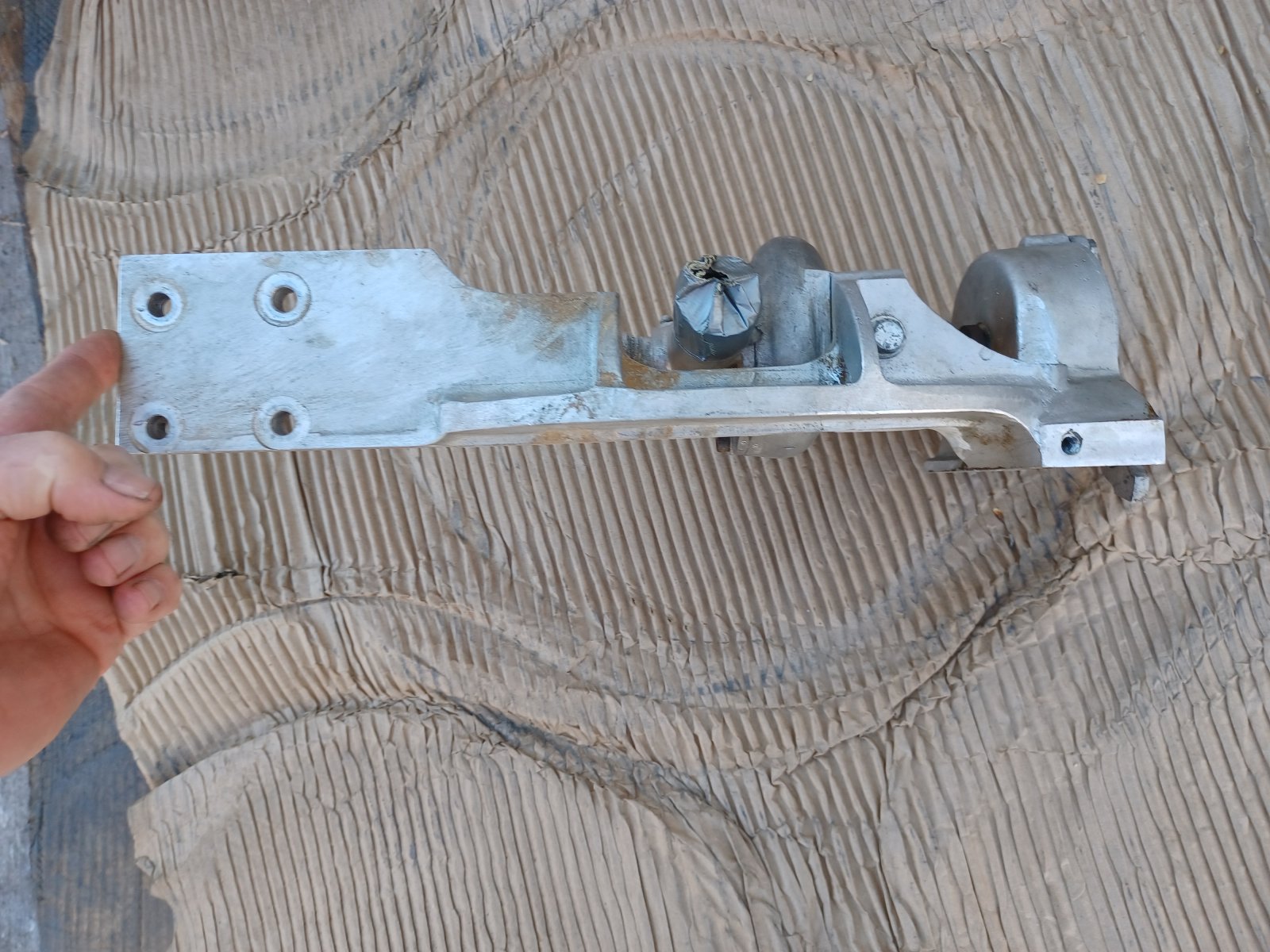

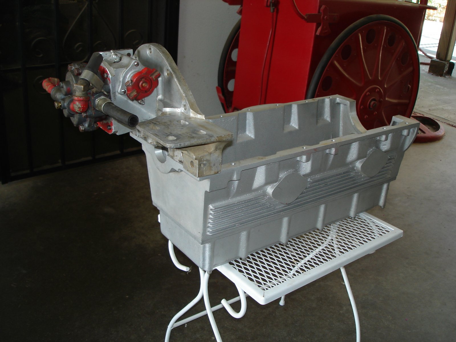

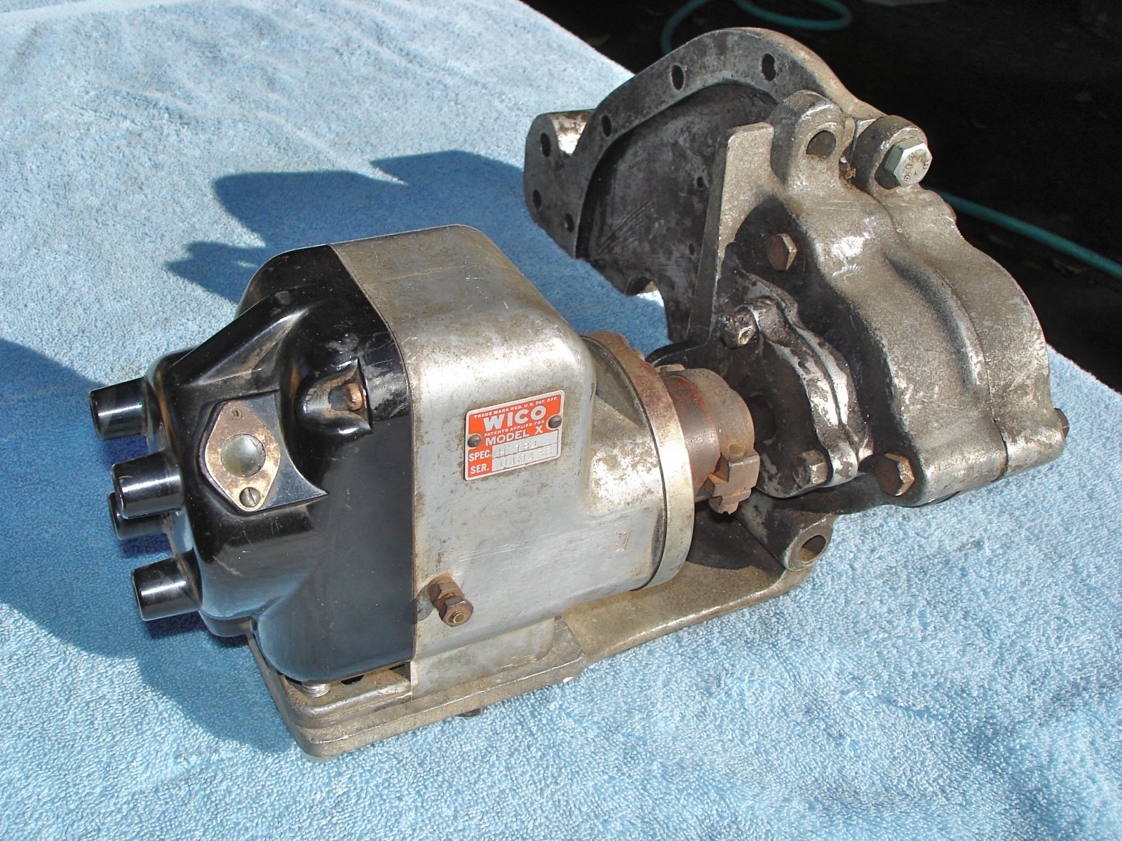

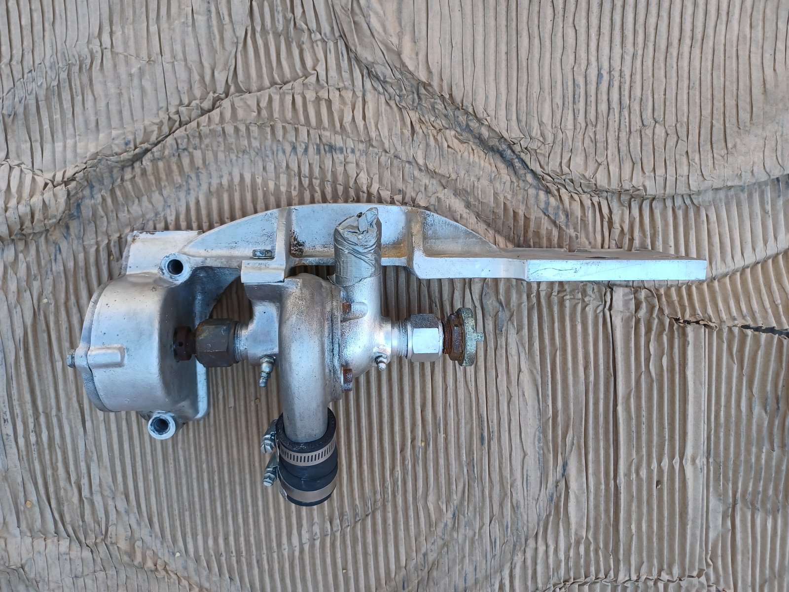

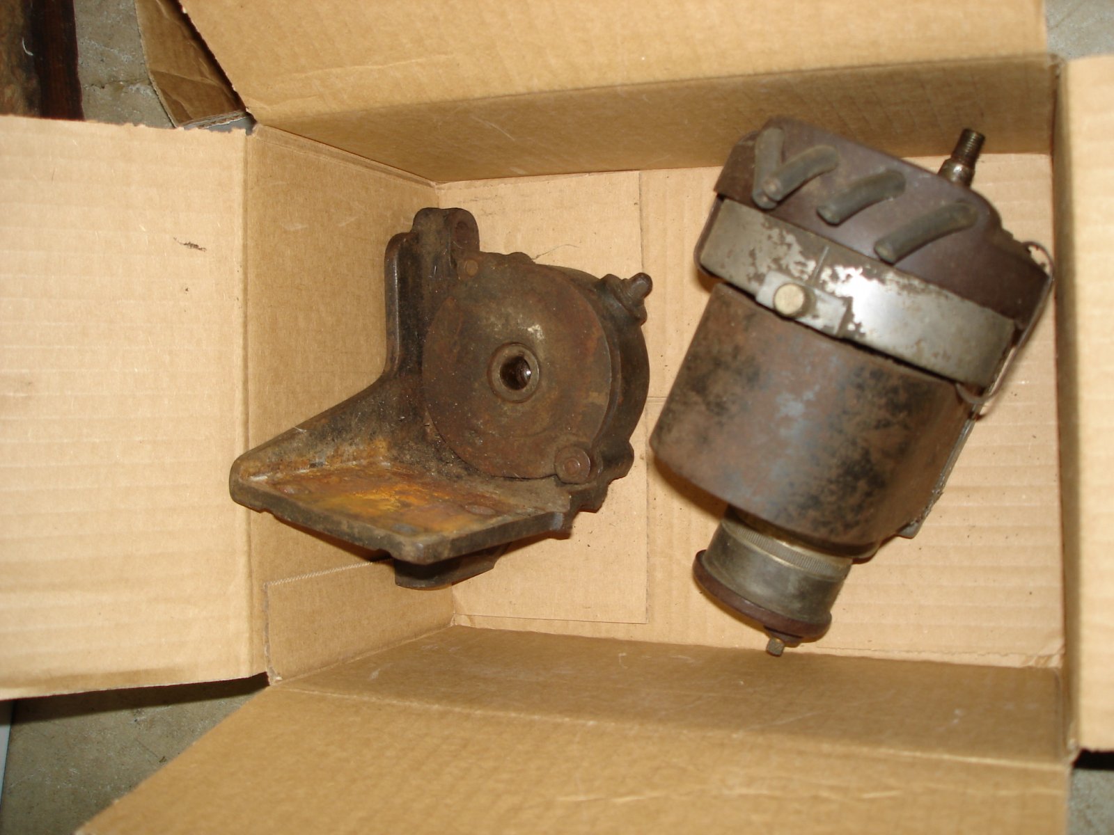

    Some inspirational pics for Retson of mag drives lurking in my shop. fullsizeoutput_e2.jpeg fullsizeoutput_155.jpeg DSC07530.JPG DSC07539.JPG DSC05159.JPG DSC06487.JPG

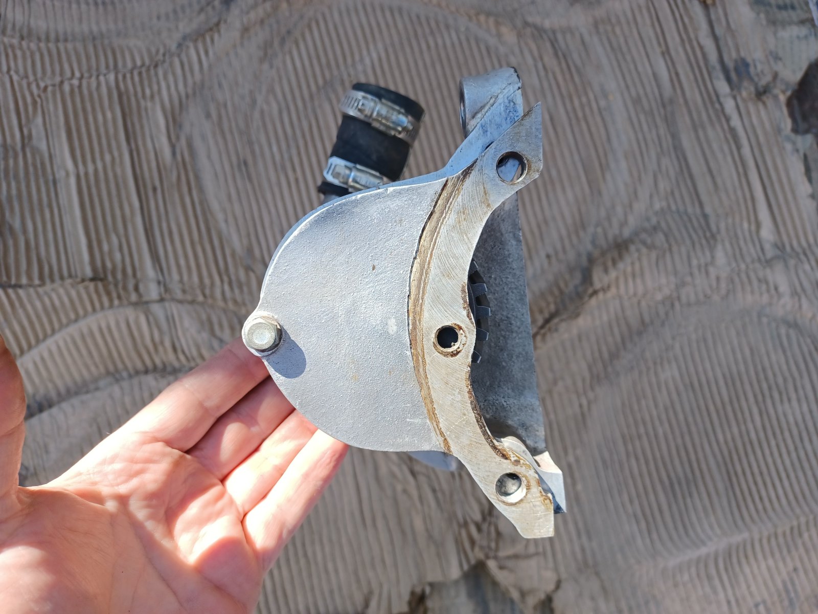

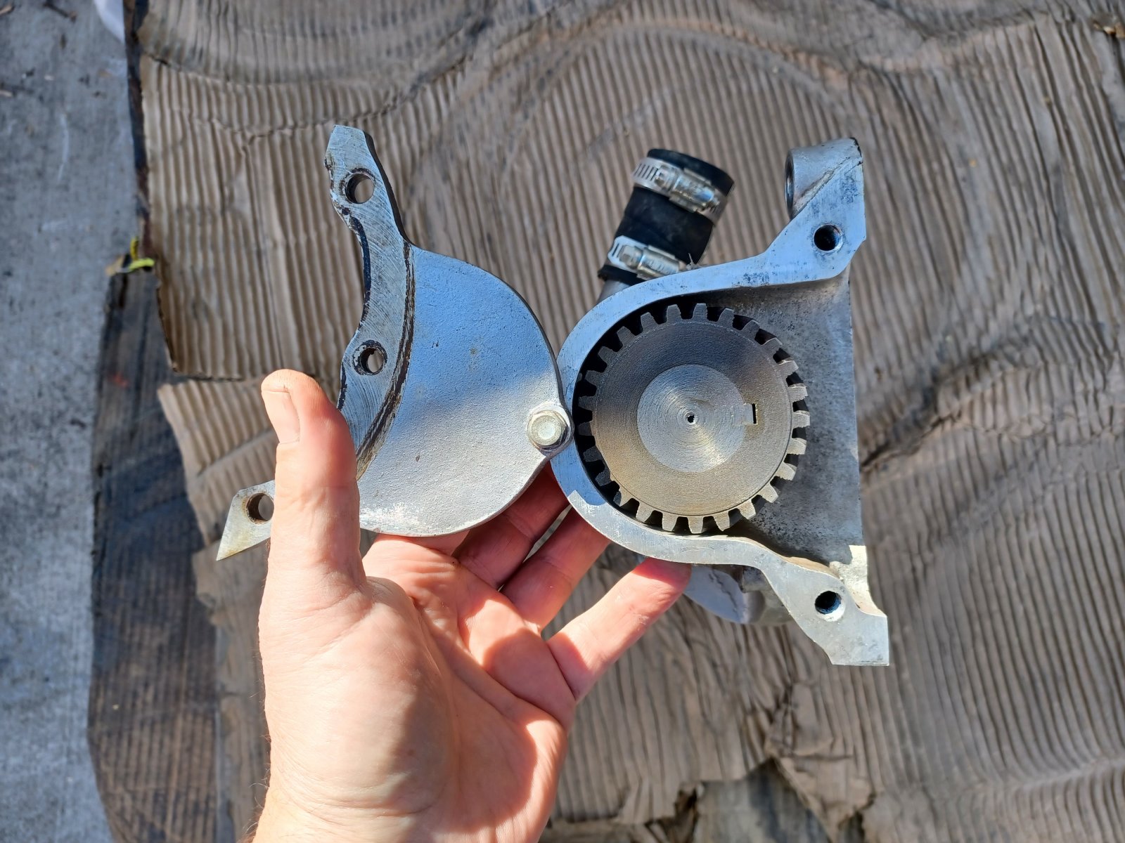

    This side drive is for a Model T. The spud is roughed out and takes a full width T crank gear. The gear and bearing are a press fit on the spud and the bearing is pressed into the aluminum casting. Most people put a keyway in the spud for the crank gear. The bearing that is on the spud was partially tapped on to check for size.
    DSC06584.JPG DSC06594.JPG DSC06596.JPG fullsizeoutput_13cc.jpeg fullsizeoutput_13cd.jpeg

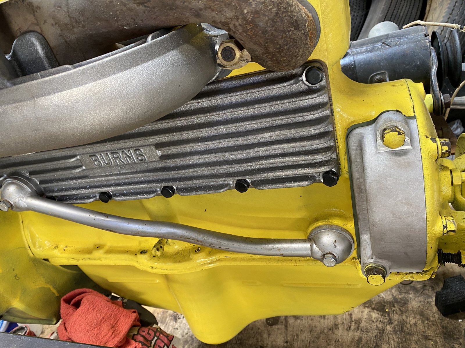

  24. Despite having a dirty ugly engine, the new aluminum side timing cover fits quite well!
  25. Dustyp489
    Joined: Feb 1, 2008
    Posts: 223
    Dustyp489
    Is the oil line painted to match or is it aluminum

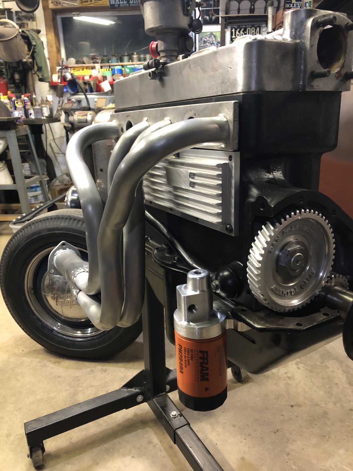

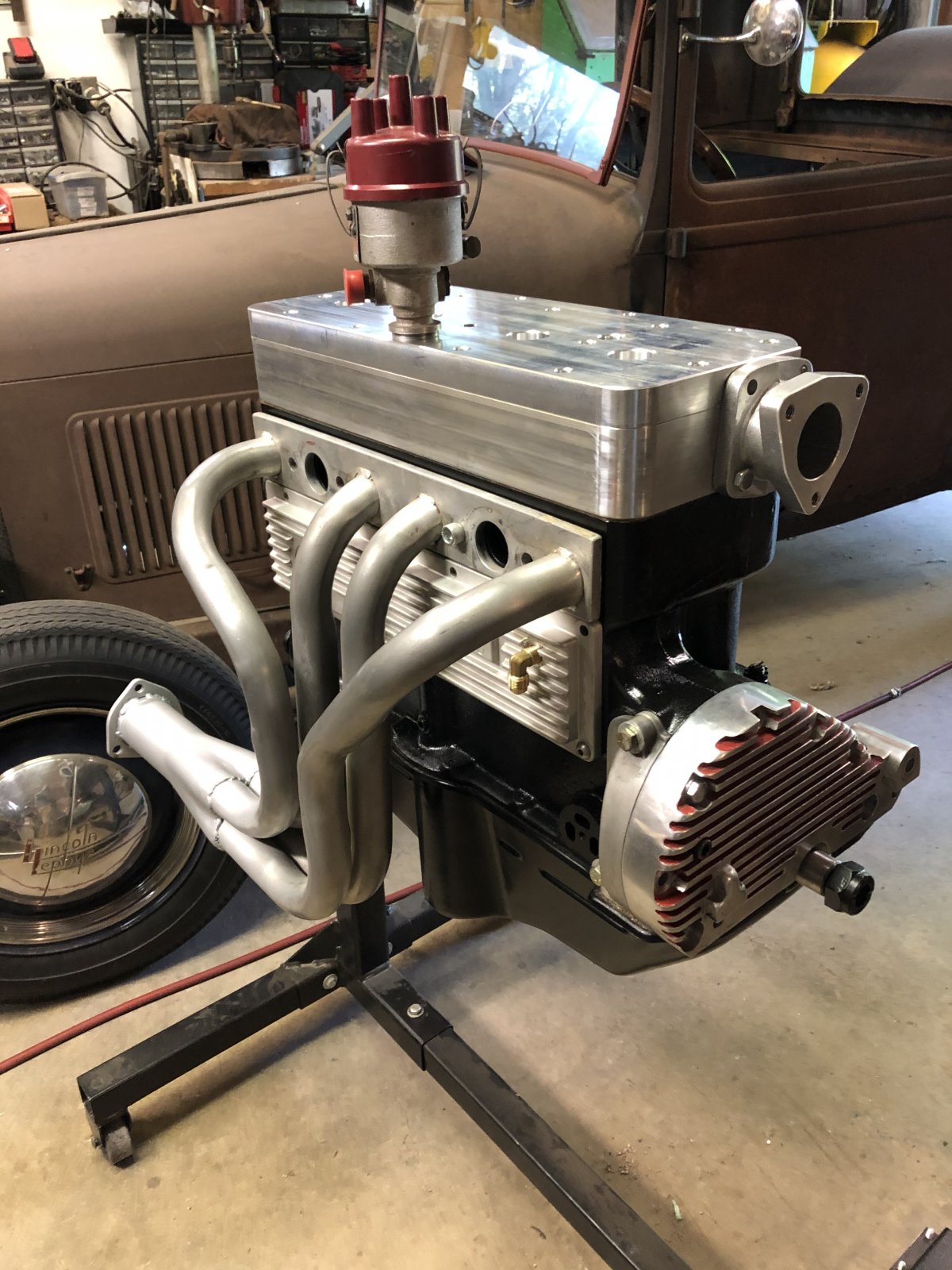

    Making progress on my Burtz block.
    20220313_173029.jpg 20220313_173013.jpg 20220313_173101.jpg 20220313_173114.jpg 20220313_173136.jpg
