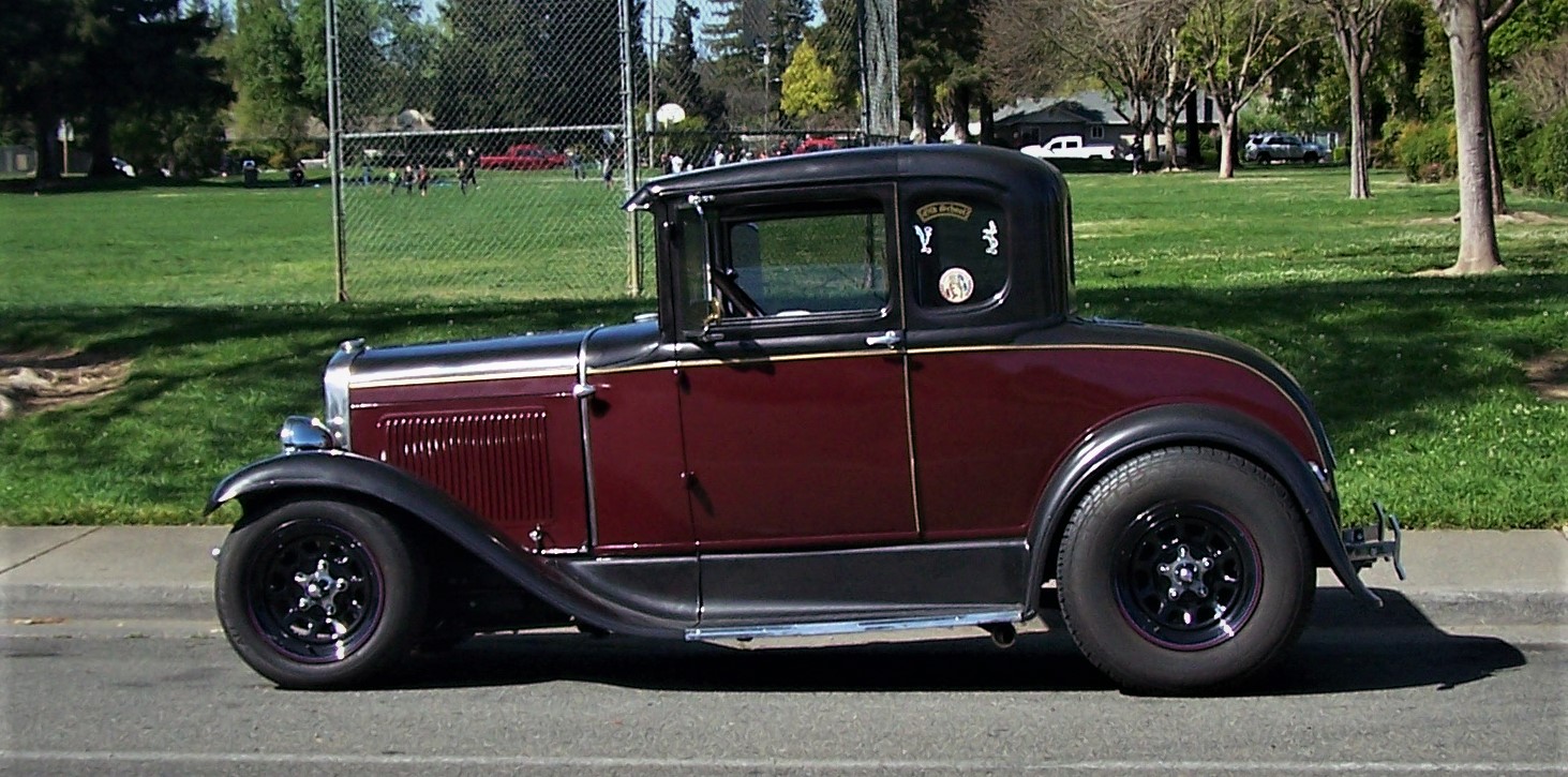

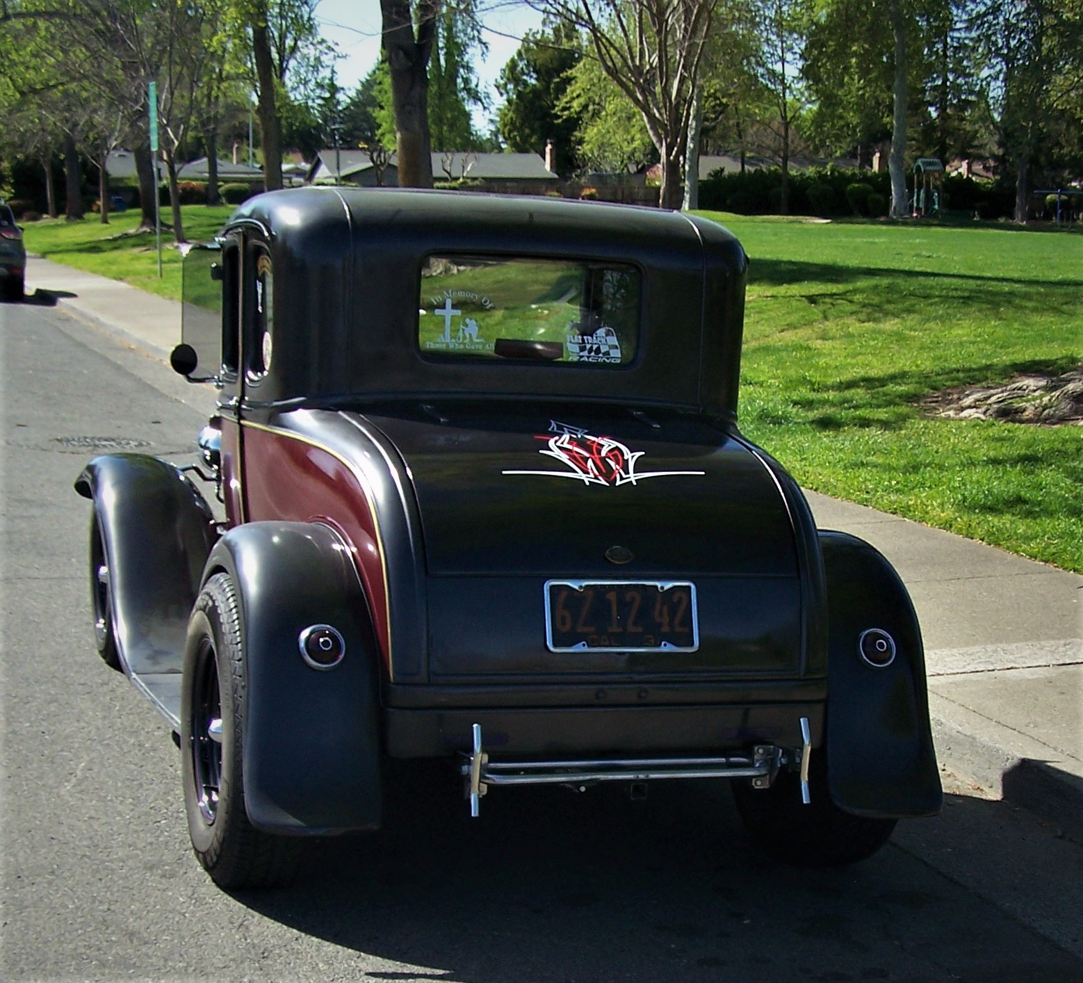

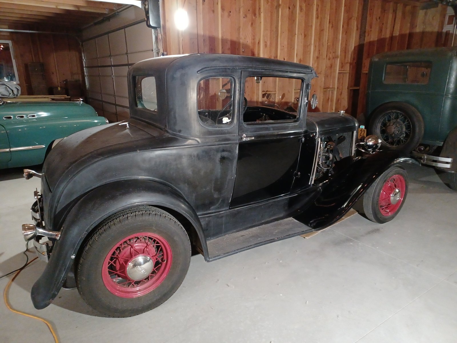

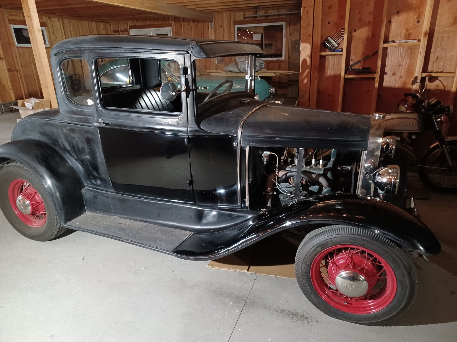

    I joined the Coupe Club on Sunday.

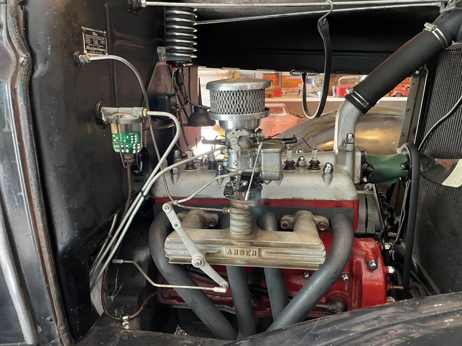

    Hey guys, since my gravity feed is traveling down to the electric fuel pump on the frame, should I still open/close the fuel shut-off valve inside the car or can I leave it open now?

    Pull the line off the pump outlet and find out.

    If you are using the original tank why do you need an electric pump?

    From everything I have read, many have experienced problems such as the carburetor acting like it's starving from fuel once the fuel level in the tank drops below half full. The fellow I purchased the intake and carb from had it on his Model A and told me the same.

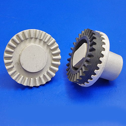

  17. After doing a little bit more research, I believe I plan on running a Wico Model X for my side drive magneto.
    As far as adapting to the shaft ***embly, I'm looking at options for couplers.
    What I've found is a Vernier Coupling ***embly with 27/28 teeth.
    Does anyone have any advice on if I should go this route, or continue searching? I know there were some cool br*** ones made in the 1920s.

    That is actually a Pratt and Whitney coulpling. I recall seeing them available from a supplier in England at one point several years ago. Making the mating halves is pretty easy, as the teeth on the rubber insert is a straight cross section, so the slots are simply a round bottom radial slot.
