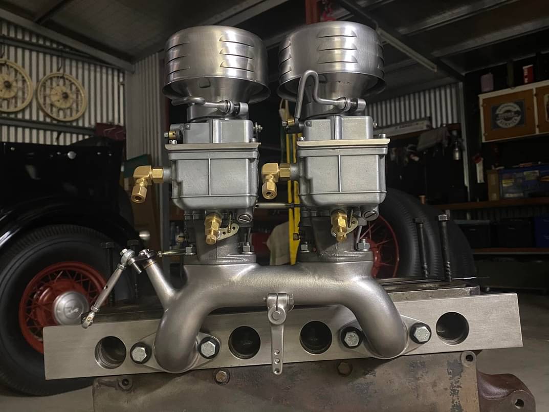

  24. Outback
    Joined: Mar 4, 2005
    Posts: 3,392
    Outback
    from NE Vic
    An intake a friend made recently img_4_1710471687303.jpg img_3_1710471665470.jpg img_1_1710471639409.jpg
  25. Dan from Oakland
    Joined: Jan 16, 2009
    Posts: 248
    Dan from Oakland
    Outback! OK yo win the prize for the week.... that's beautiful- the weld elbows are perfect- mild steel or stainless?? Really nice how you added the throttle linkage mounts.
    Old Dawg and Outback like this.

  27. hotrodA
    Joined: Sep 12, 2002
    Posts: 7,353
    hotrodA
    @Outback
    Wow, that’s impressive! I can use it for inspiration in building mine for the Alexander.
    Thanks for sharing that, it’s top drawer quality.

  30. Outback
    Joined: Mar 4, 2005
    Posts: 3,392
    Outback
    from NE Vic
    He & his brother do some exceptional work. @Dan from Oakland it's all stainless. & Will probably be painted!
