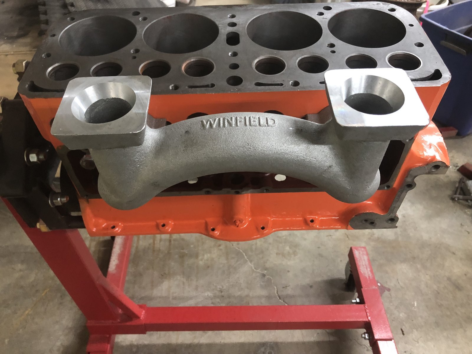

    Did you cast that Winfield intake or is it an original casting?
  4. 4bangerbob
    Joined: Jun 29, 2013
    Posts: 152
    4bangerbob
    from AB, Canada
    I got it cast from permanent mold, also got single cast, to fit A through size D carbs.
  5. Dan from Oakland
    Joined: Jan 16, 2009
    Posts: 248
    Dan from Oakland
    So, cast in a sand printed mold? Looks very nice........
  6. 4bangerbob
    Posts: 152
    4bangerbob
    from AB, Canada
    No; wooden mold, cope and drag with core for the internal runners.

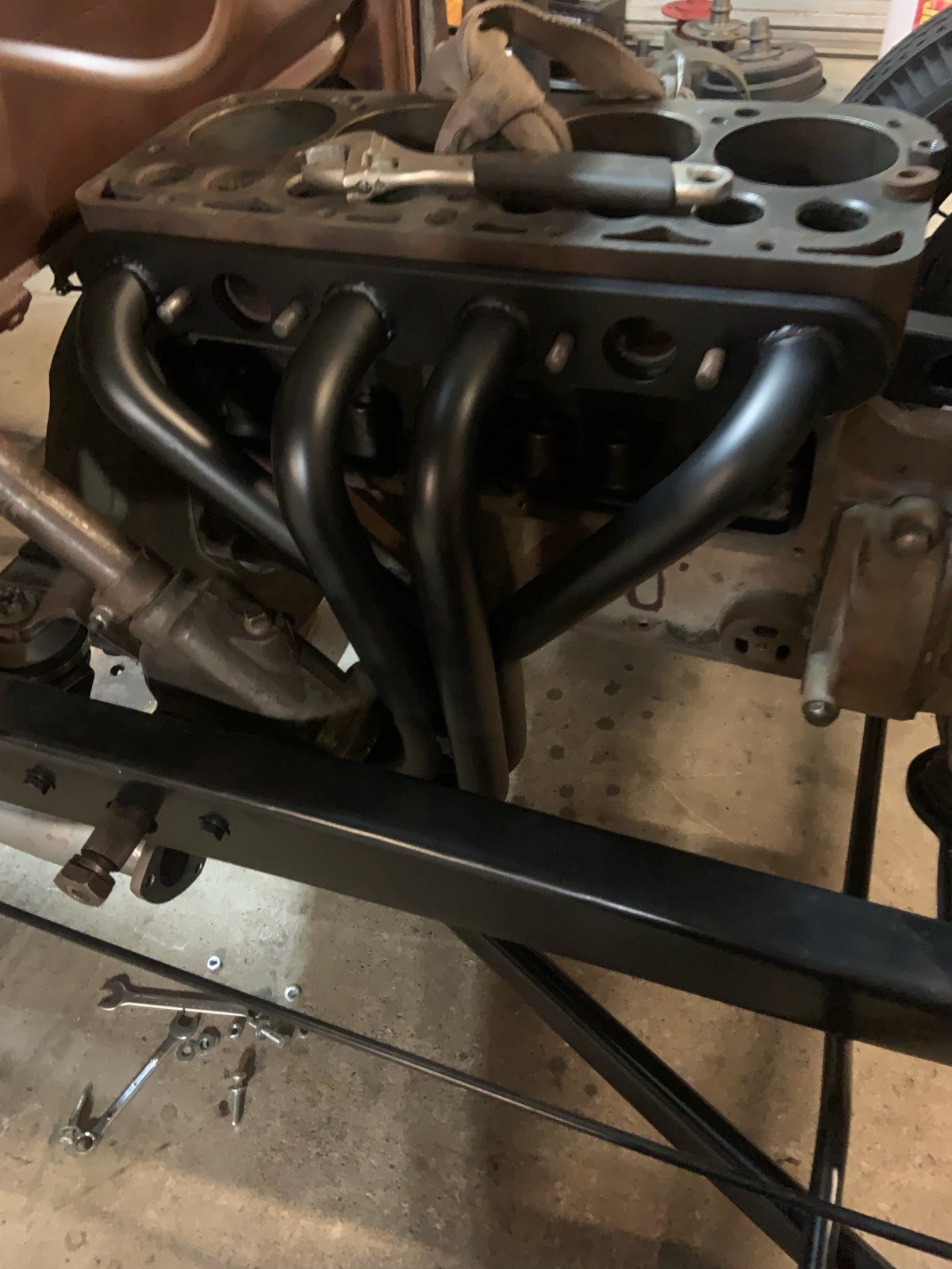

    Working on my intake and exhaust this last week... 1/2 way mocked up.

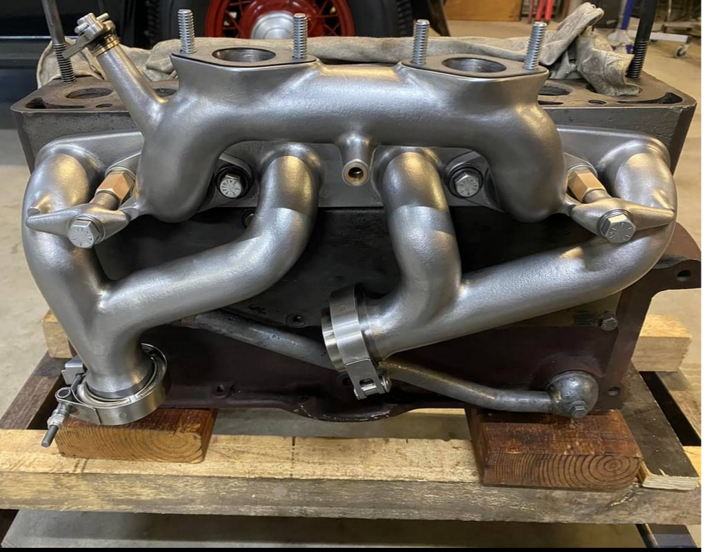

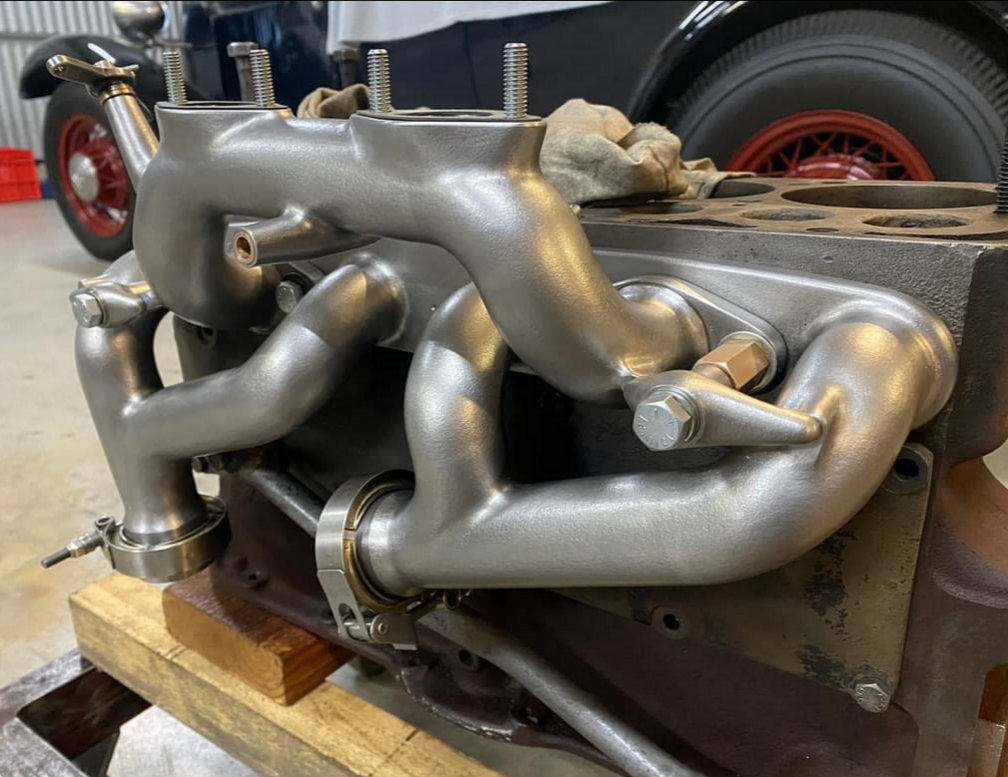

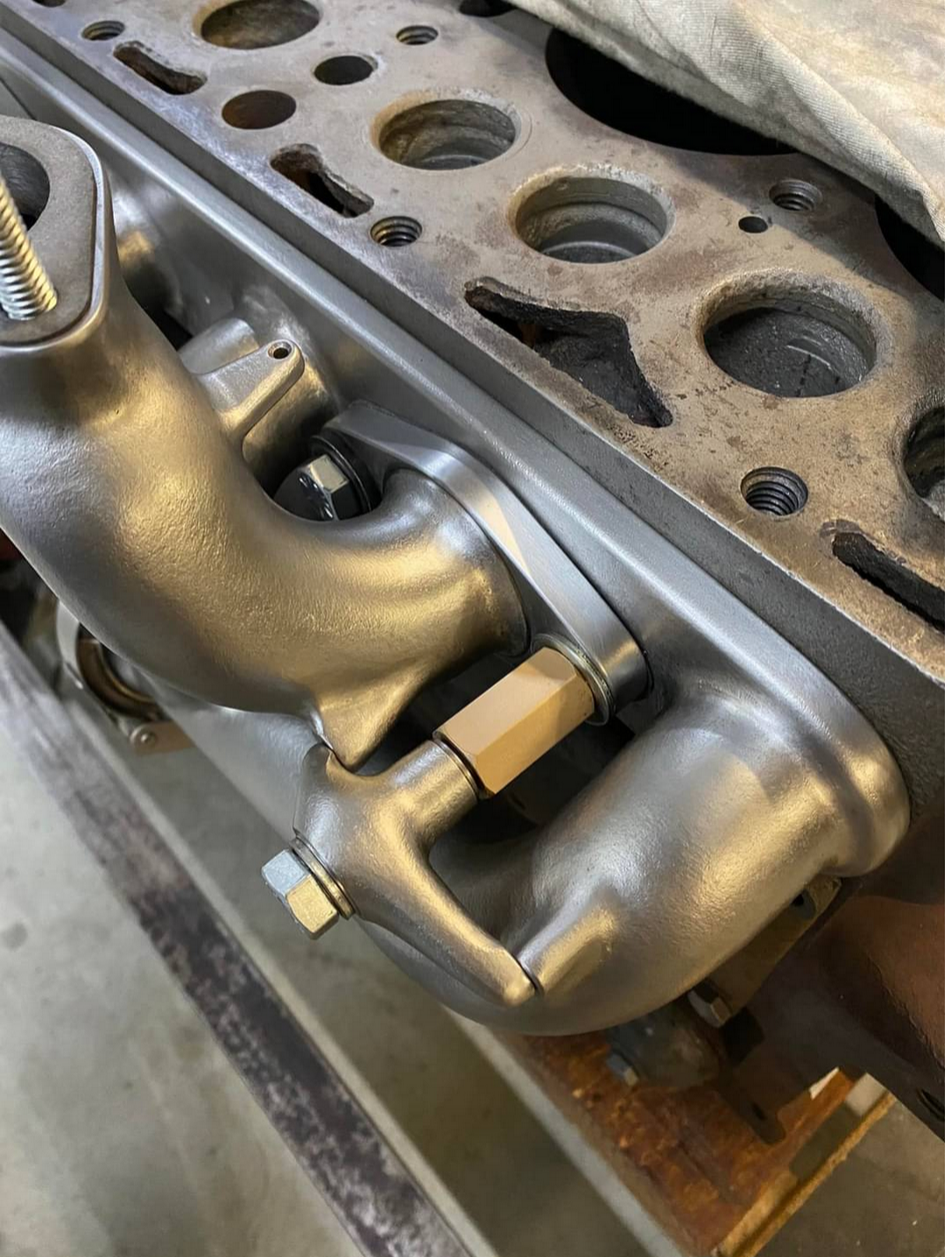

    & Now the pipes to match the manifold, lovely work Screenshot_20240326-190551.png Screenshot_20240326-190622.png Screenshot_20240326-190526.png

    Again fabricated like the inlet manifold! Hrs & hrs of work.
