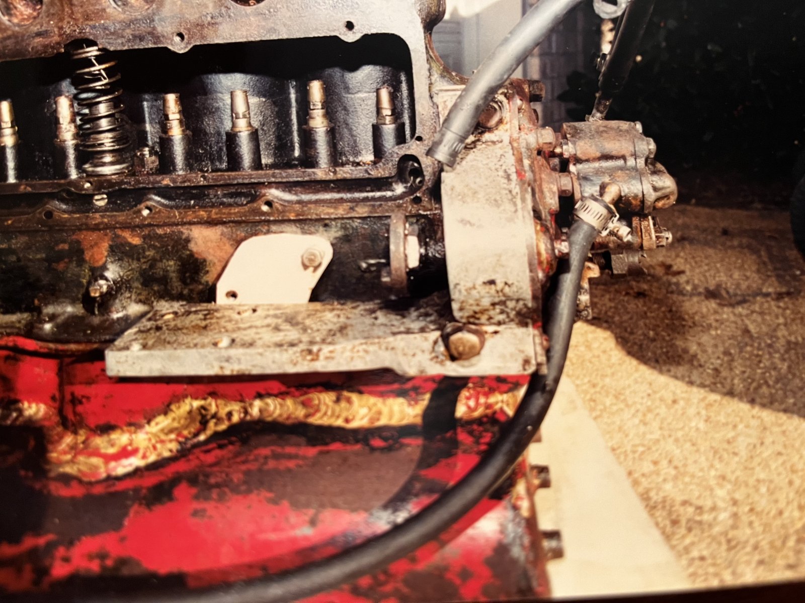

    I've used this American Bosch mag on one of my side drives. I prefer it because it has a lever that adjusts the timing manually.
    https://www.ebay.com/itm/2671168370...9bTJY9TVDeCsKGKpnOiZVchw==|tkp:Bk9SR4bjybqsZQ

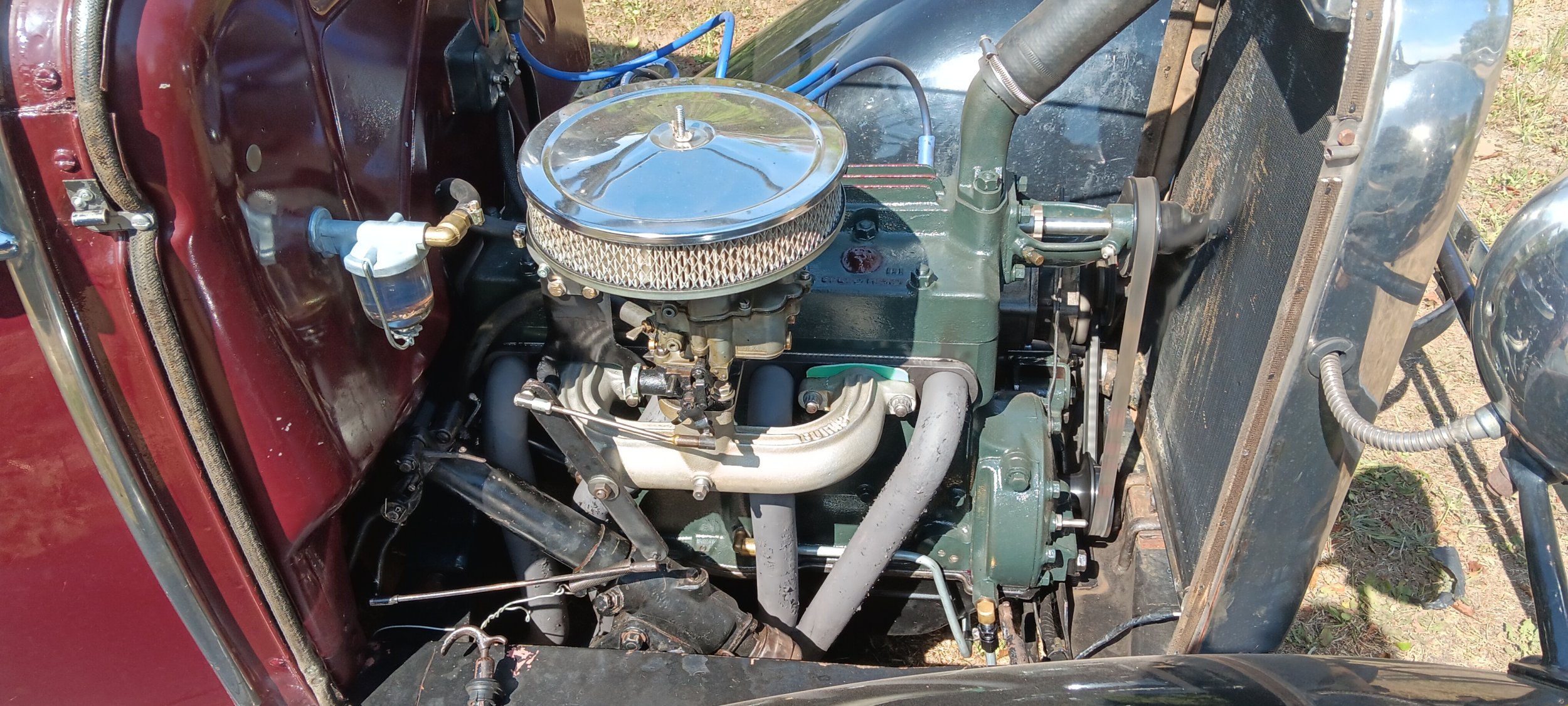

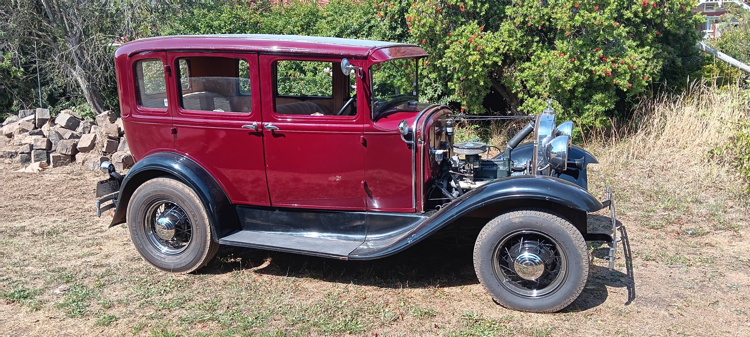

    Hot rod sedans are plenty of fun, I've just got mine running with a hopped up burtz, mines right hand drive so I can't answer your question about the header, but I can tell you I haven't had any overheating problems with the previous hopped up banger and the current burtz since I went to a pressurised radiator, some 16 wires with 7.00 rears and 5.50 front tyres its sits ok on stock suspension but I do have a 34 axle for it and plan to pull a couple of leaves to get it sitting better
    Here a quick video of it running, the burtz is pretty healthy, it's got a lionspeed 7.5:1 head, burtz 340 cam, burns intake, larger holley 94 from a y block and a home made 4 into 1 header that works pretty well, it will pull 55mph in second with a stock transmission, 3.78 gears, I've had it to 80mph so far but chickened out due to stock brakes, but boy is it fun, I've had fun this last month of summer
    Deutscher, jet996, Outback and 4 others like this.

    @Star 351 at 80mph, braking would be fun!!
    great going
