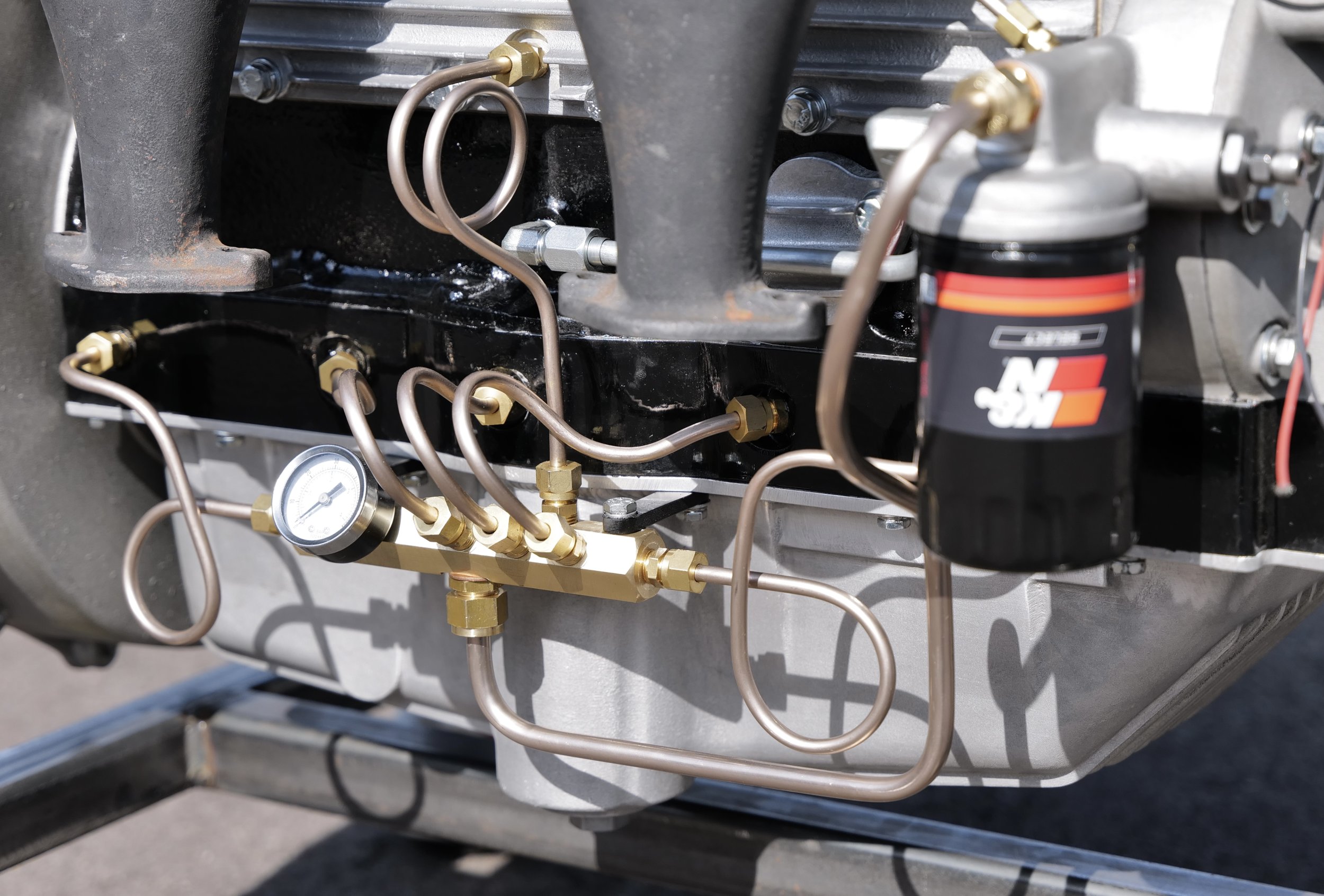

    Is anyonse running a hardline from a B fuel pump to dual downdraft carbs? I am looking for options. The header cooks my rubber line. Good thing I checked it before I did the Spring start up because it was hard as a rock and was cracked on both ends. I suppose header wrap is also an option?

    Jim, I do. It's a copper coated steel line so I dont have any of the loops for vibration. Been there a couple of years now with no issues. If you notice there is no line from the sediment bowl to the pump. I replaced that hose with a steel line that follows the body down to the frame where I have a flow thru electric pump that I use for priming. That pump uses rubber hoses on each end to absorb whatever movement I have between body an engine. Its tucked in along the frame rail so no issues with heat from the header.

    That is what I was considering. Good to know it isi good with vibrations. I was considering putting in a few coils if I could get them to fit and look right (like you stole it off a still). Is that a compression fitting where it comes out of the fuel pump?

    With out looking I believe they are compression fittings.

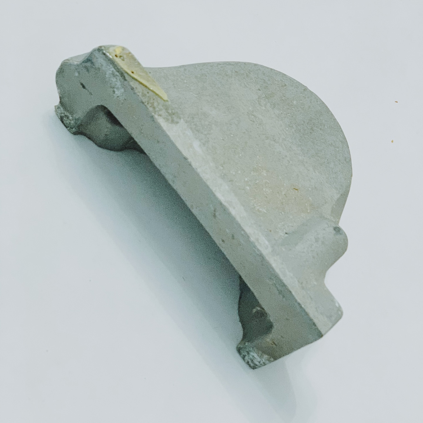

  11. I've got quite a few rough castings that will need to be machined. If any of you guys want one, give me a shout! I think $50 a pop seems fair. Here's a more-so completed one I'm working on finishing. 467814372_18029650367596101_527167825746845210_n.jpg 468004889_18029650358596101_726352897412504516_n.jpg

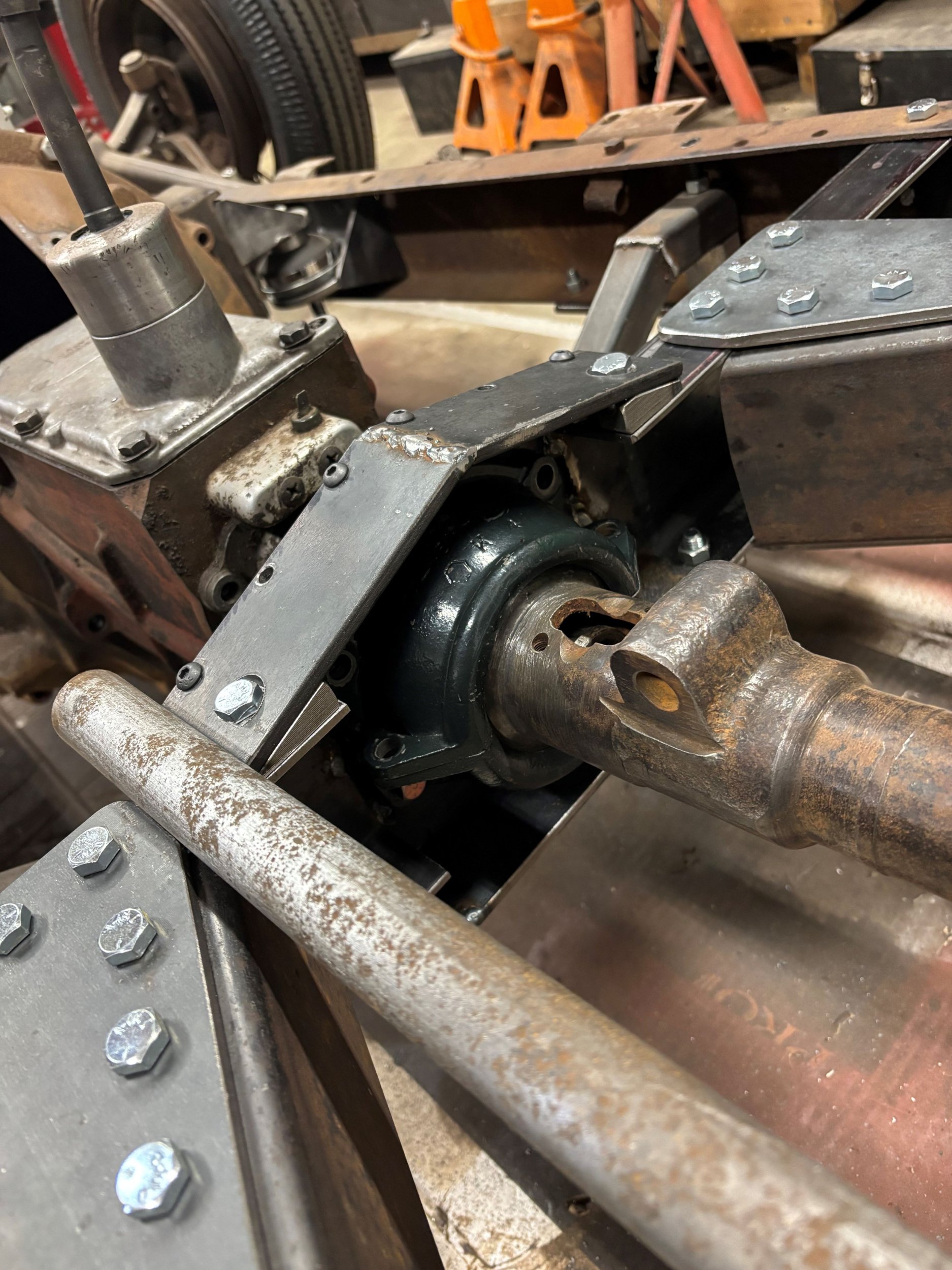

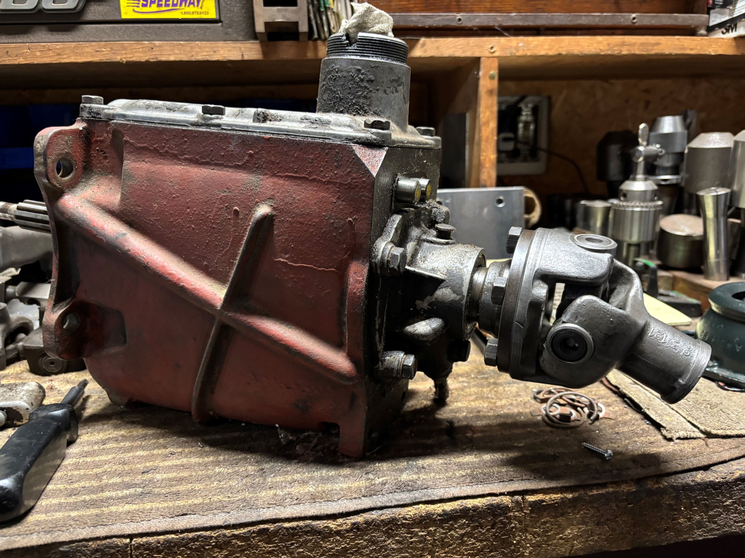

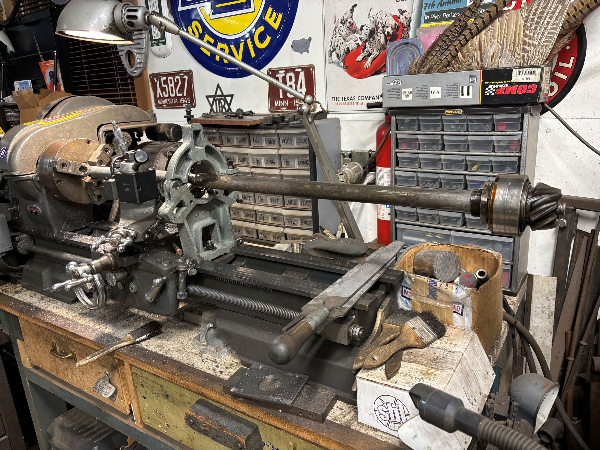

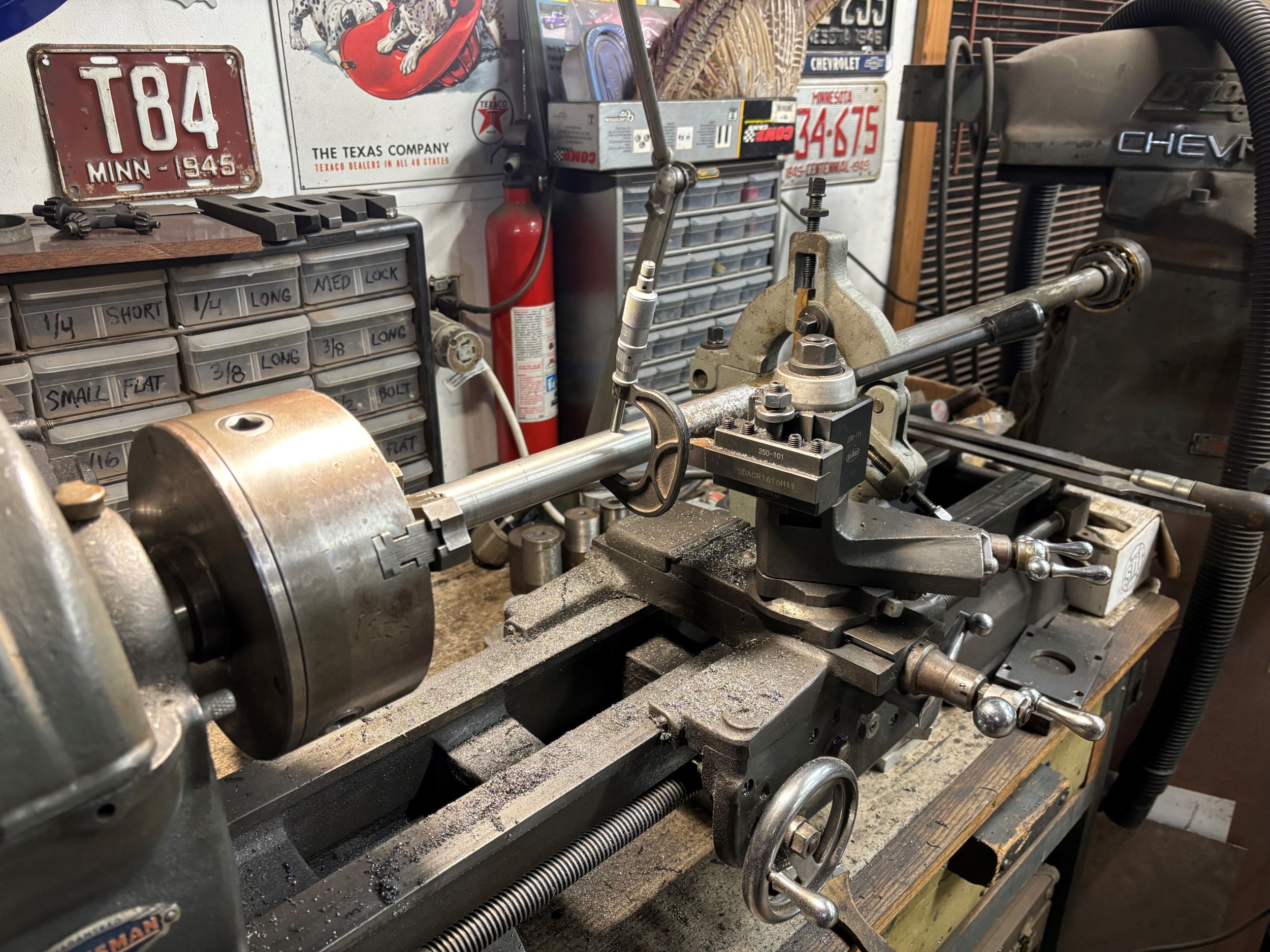

    Random pics still gettin stuff done on this pile using torque tube on this one Torque tube 1.jpg Torque tube 2.jpg torque tube 3.jpg lathe 1.jpg lathe 2.jpg trans 1.jpg
    mvee33, skip65, 5280A2 and 8 others like this.

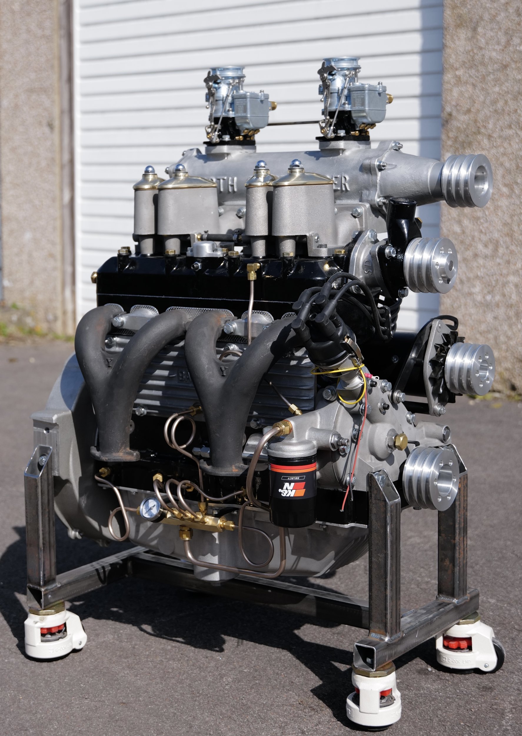

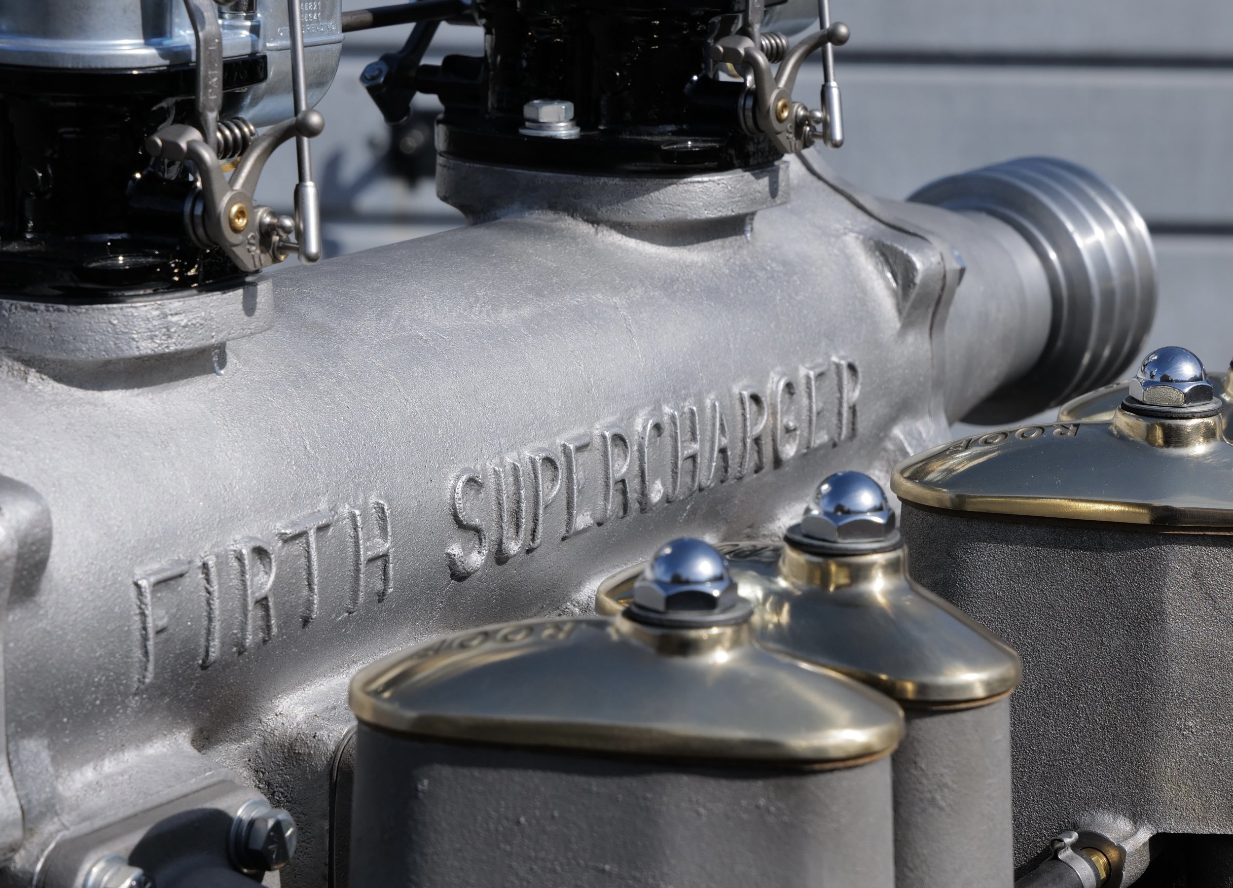

    I finally manage to build this one up.
    1934 AA block with Burtz 5 bearing crank fitted via a girdle. Burtz rods, RaceTec pistons, Jim Brierley dual grind cam, Roof 101 head, Rotoshim oil pump and cam gears, bespoke Firth Speedshop supercharger, Stromberg 81 carbs, Burtz flywheel and Yapp pan and front cover.
    DO01000425.jpeg DO01000424.jpeg DO01000430.jpeg DO01000434.jpeg DO01000429.jpeg
    Flatdash, 40 Olds, adam401 and 24 others like this.
  14. alchemy
    Joined: Sep 27, 2002
    Posts: 22,776
    alchemy
    That one has everything, and then a little more!
    nutrocker and Outback like this.

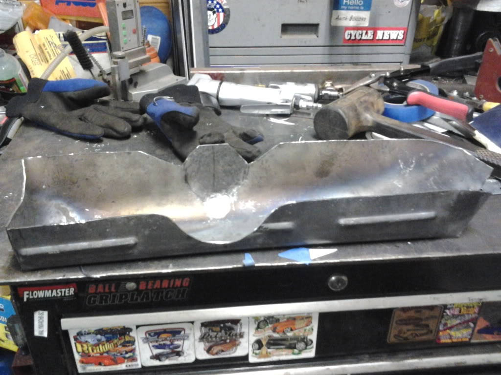

    Here is what Milodon used to do to his oil pans
    jet996 and 282doorUK like this.

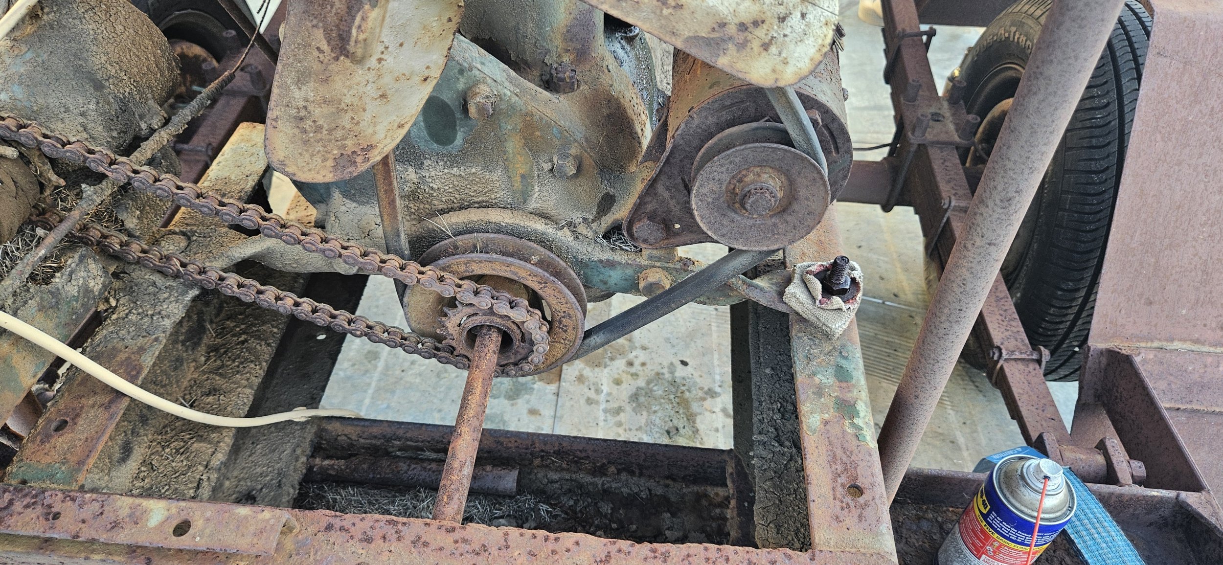

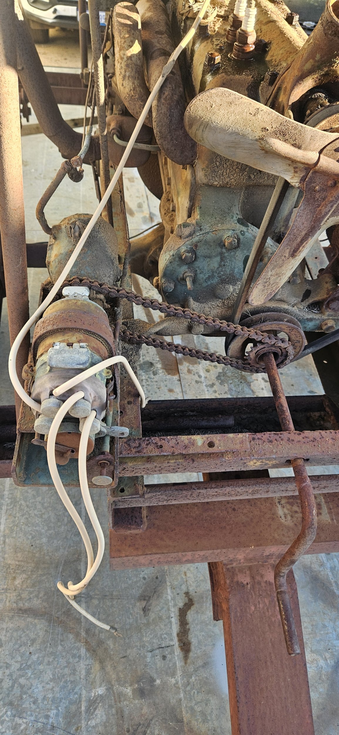

    I also took the day to go pick this old welder up today, as I'd been looking for an engine to build and this came up. Visually I know it's a B, and has a C head, I'm ***uming it's from a BB by the bell housing. Turns over by hand with good compression, does seem to be well looked after. What are my chances it's a counterweighted crank?
    A few closer shots...
    Doesn't appear to be a diamond, not even sure we had them down here though, shot of the Magneto setup below
    Any insight appreciated

    Pull the cover off the fuel pump hole and see what you have for a crank if your curiosity is killing you.
    I think I'd pull the lifter cover (because it's easy) and if it's not completely buried in sludge put it back on and see about getting it running.

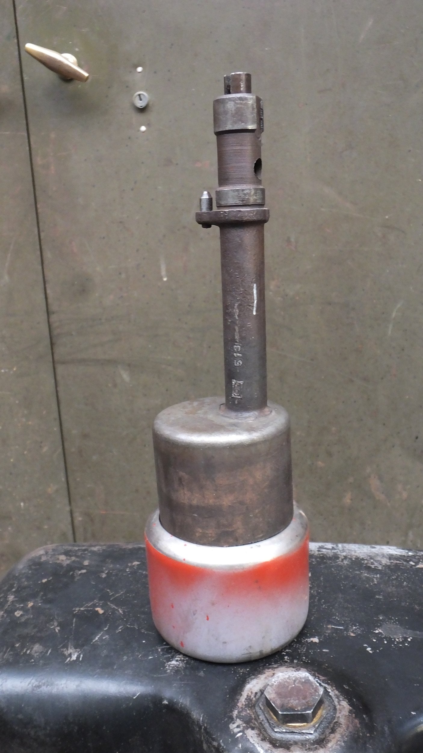

    Meanwhile today I was clearing a bit of bench space when I spotted an old pump and a forgotten small stainless steel bowl laying together beckoning to me, unbelievably they fit perfectly together!
    Hmmm.. thinks...if I weld the bowl to the pump shroud on my re-con pump, then cut the bottom of it off, it will extend the shroud down. The bowl being wider than the shroud it won't restrict the flow around the bottom of the pump where the gauze is showing, which would happen if I just welded two shrouds together.
    So I fired up the CAD equipment and prototyped an oil pan extension, my idea being that the pump will work as normal, but the oil being deeper around the pump it would take way more centrifugal force to move the oil away far enough to allow air to get ****ed in under the extended shroud.
    I might have made the pan extension a bit too deep, and I've got a feeling I'm missing summat, it can't be that simple, your thoughts would be appreciated.
