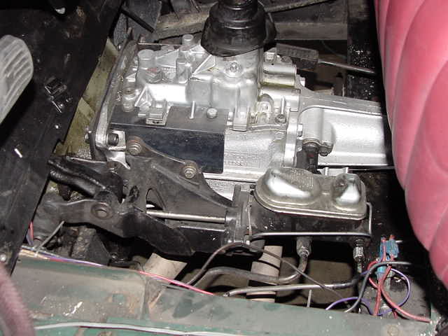

    hey I have another question what is the shortest transmission with over drive I can adapt to the back of an A banger? I dont need provisions for petals so a AA bell housing is fine. I also dont need a reverse gear if it is possible to remove for space. just want it to be short and at minimum a 1:1 top gear but OD is preferred. Would like to stay shorter than a T5 but that may be my last choice unless there is a way to shorten one and remove the tail shaft.
    this trans will be used mounted directly to a solid mounted rear. so im open to any custom ideas.
  10. Flat Ernie
    Joined: Jun 5, 2002
    Posts: 8,406
    Flat Ernie
    Tech Editor
    The Jeep 4x4 T5 is probably the shortest. It has a stub where it bolts to the transfer case & would probabl work well for what you're trying to do.
    The ratios aren't great (it's got the 4.03 1st gear set), but can be swapped for any other NWC T5 ge****t.

    Here is the KJeep 4x4 T-5 that I am using in my RPU with the addapter I built for the closed driveline. I swaped out the Jeep gears and replaced 1-4th gears with a set from a S-10 2 wd trans to get a 3.76 first gear and closer ratios throughout. Works great. The Jeep trans is 10" shorter then the 2wd T-5.
    [​IMG][​IMG][​IMG]

    I used the A bellhousing but now I wish I would have used the AA. I didn't need the pedal mounts and could have used a 2" shorter set up. I made an addapter plate to mount the trans to the bellhousing made from 1/2" steel plate. I am also running a hydraulic throwout bearing.

    That is a nice setup what clutch setup and throw out bering and such you using? because im going to have to run a hydraulic setup
