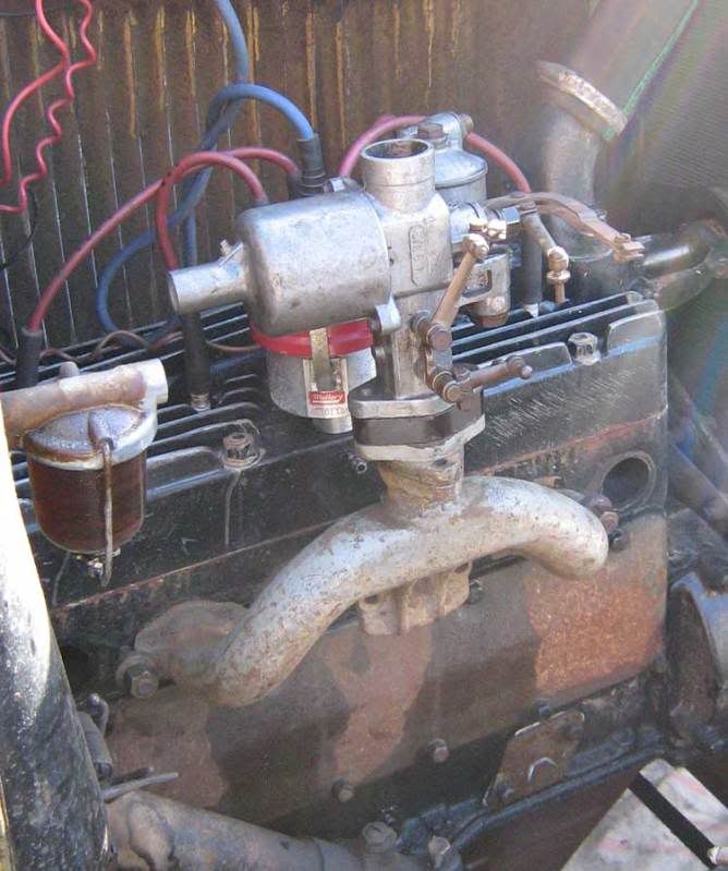

  5. They came in all shapes and sizes! Here's my 1-1/4" downdraft mocked up on a manifold from a B engined generator....
    I may just try it out. It's a smidgen bigger than the Tillitson! But if I really wanted to go much faster I could always start by throwing away the body...

    Be interesting to see how you check the dashpot oil, Phil...

    Well I finally did it! After driving my almost stock A bone several thousand miles last summer, I put one of those Weber carburators on it for a little more umph and sun of a gun my rods now sound like my garbage disposal. Had a to make a decision about what to do this summer and decided to put a fresh motor that was scheduled for my roadster build and has been sitting on a stand for several years into my stocker. If all goes well, it will be back in motion in a week or so and I'll be thinking about a replacement for the hi boy roadster.
  21. WOW thats RED against the black and body colour!
    What jet size would you run on a twin 94/97 manifold like that?
    I ask b/c I am running a single 94 and its a little rich, but have a twin carb and want to run that, but i am a little gun shy of running it rich all the time.
