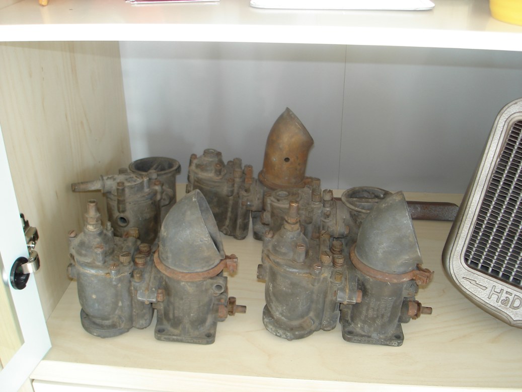

    Hi there banger brothers.
    Not really only banger related but I know they most often show up in the banger threads. My latest find is a couple of Winfield carburetors. The two ni front hvae SR bowls and CC bodys. Then there is one more just like them but missing the air horn. The last two have S bowls, one with BB body and one with D. The D is missing the fuel inlet and air horn. But other then that they look complete.
    I will probably try to trade for matching pairs and also I need to find an intake so I can put them on a banger. But the look good on the shelf too.
    //Magnus

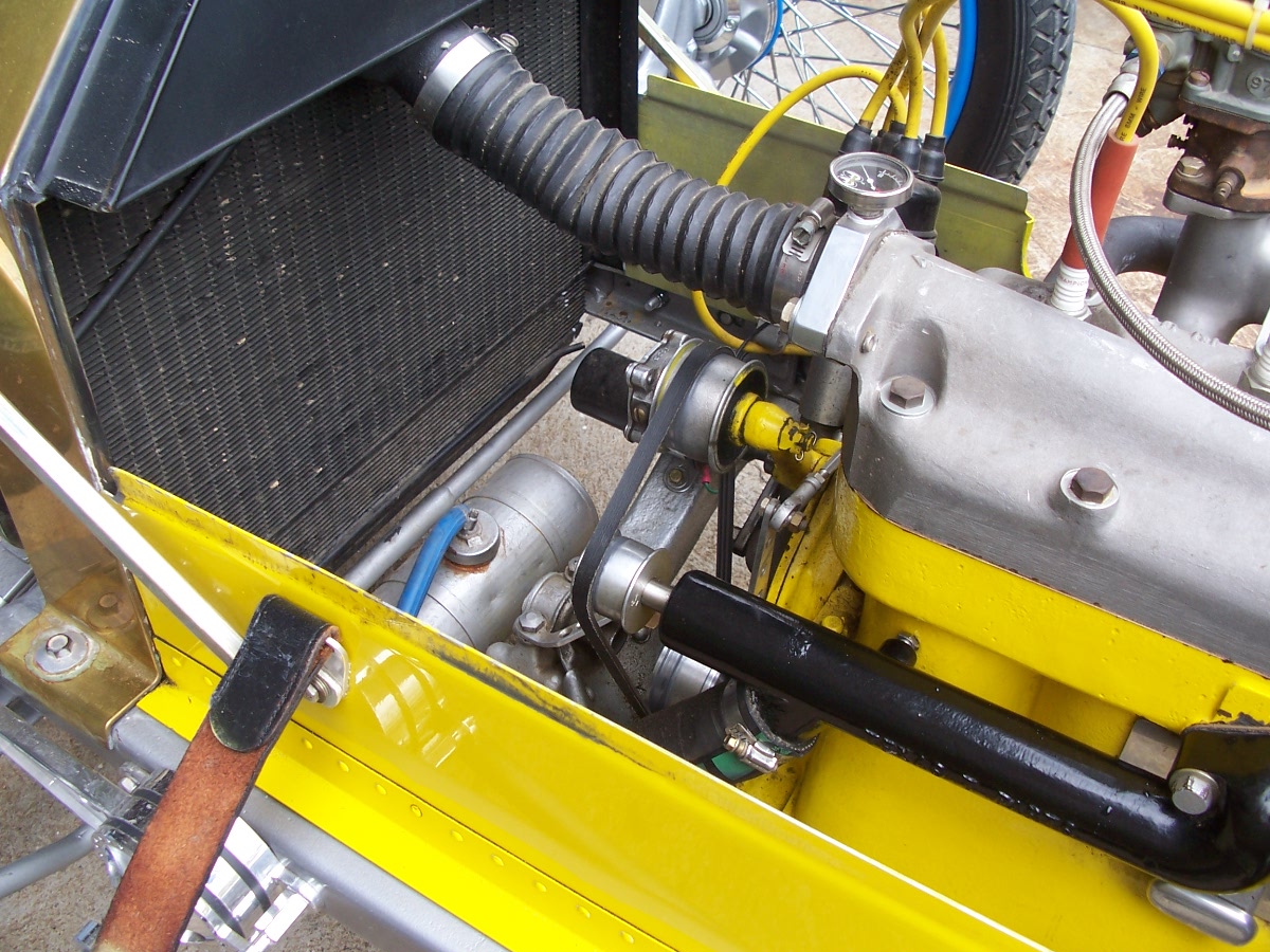

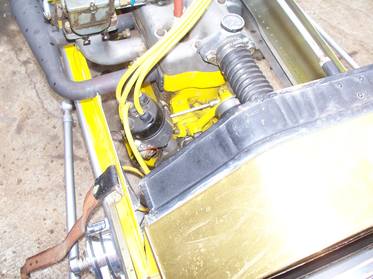

    Hey fellas,
    I thought you might enjoy a little banger p*rn. Dave41 snapped these and sent them to me to post on Moe's T Sprinter thread and after seeing the pics, I knew I needed to share them here too.
    This is a tough little car, I'd love to have one like it!

    I like BANGER P:eek:RN..... Thanks Brent
    The hole thing is kick ass but the timing tab is so cool. If you have more pics or info don't be shy:D

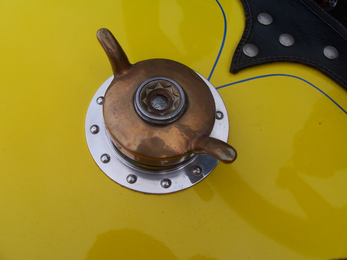

    Wildfire
    Thanks for pointing out the timing tab - beats the wire one I made on my A.
    I also like the gas cap gauge. I like it a lot.
