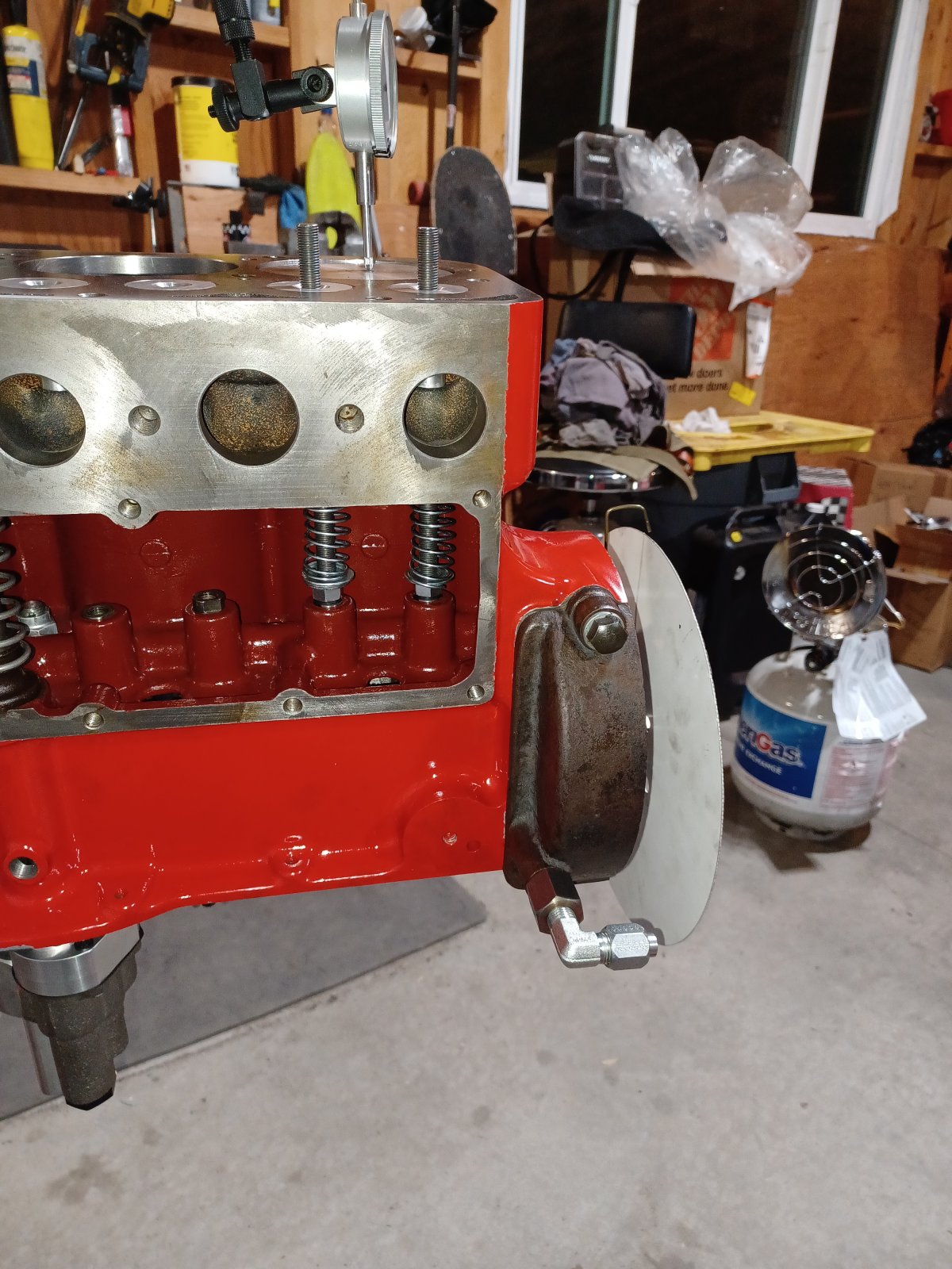

  2. C0E7E67D-43C1-44BB-8CC1-B0FA19EA17E6.jpeg Been progressing my Burtz build over at my friend Craig’s workshop - RKE, that make the Rotoshim shocks.
    Took it home at the weekend and treated it to a dusting of paint.
    He’s been a bit busy himself.
    A friend of his who normally builds phenomenally quick drag bikes (he has a twin supercharged twin triumph engined bike in build at the moment) was let loose with his polishing mops…
    They’ve whittled some mains caps whilst they were at it and Craig is currently building tooling in readiness to line bore the block for shells. Guess I’ll queue up a pair of B blocks behind that one.

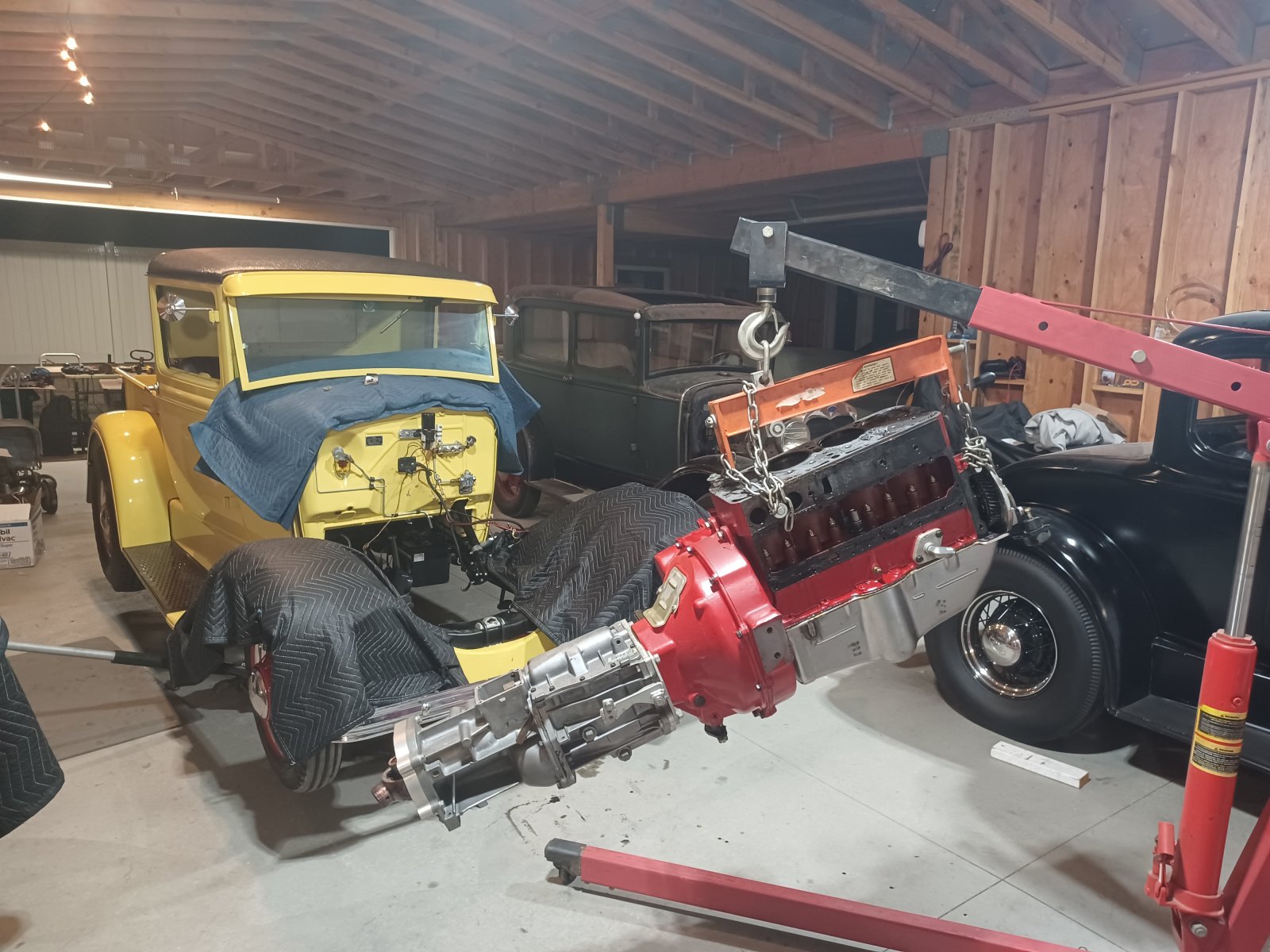

    First time checking into the banger threads, I just picked up this T with a supposedly rebuilt engine and a bunch of other parts. In looking around quickly it seems that most talk is about A and B motors, does anyone do anything with T motors? I'm not sure what my plans are for this yet, build it up using the T frame, axles, motor, etc. Or I also have enough parts to build an A ch***is and just drop the body on that. Either way, it will be a while, I've already got a bunch of other projects that need finishing first. I probably shouldn't have bought it, but it was close to home and the price was right, so why not. I guess I could always flip it if I decide to not build it. Time will tell I suppose. IMG_20230221_171916221.jpg IMG_20230221_171919302_HDR.jpg IMG_20230221_171926744.jpg IMG_20230225_141446517.jpg IMG_20230225_141831583.jpg

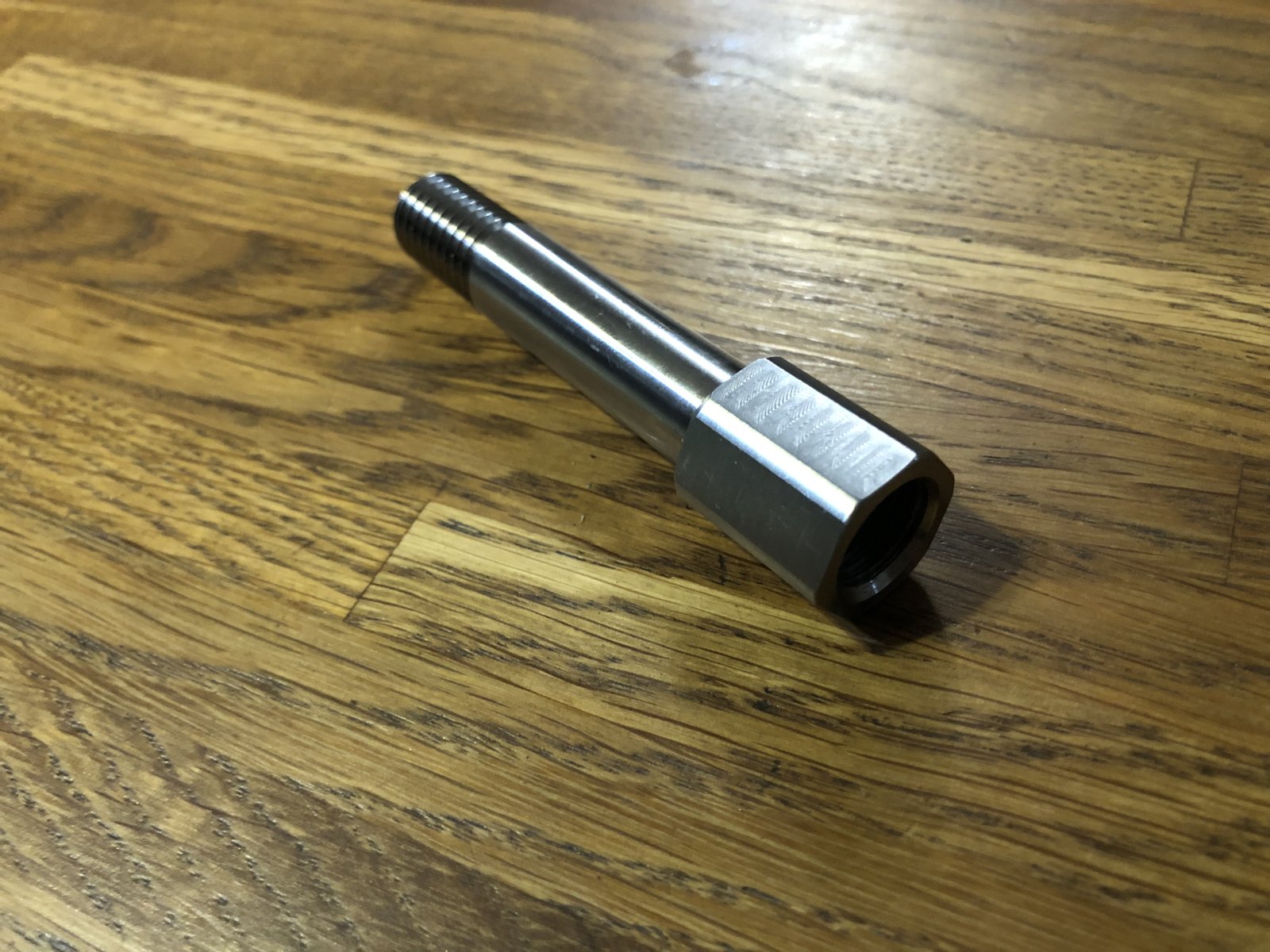

  14. Have you fitted an external filter? Any pictures of that side?
    This is the bolt I’ve had made to fit the side cam gear cover. 1/2” UNC, 5/8” hex with a 1/4” BSP female thread and an 8mm reamed hole down the centre to feed the oil gallery. F3E64343-4CD8-46DE-A205-B2FAFDE28DFE.jpeg
    Old Dawg, G Baese, Jet96 and 4 others like this.

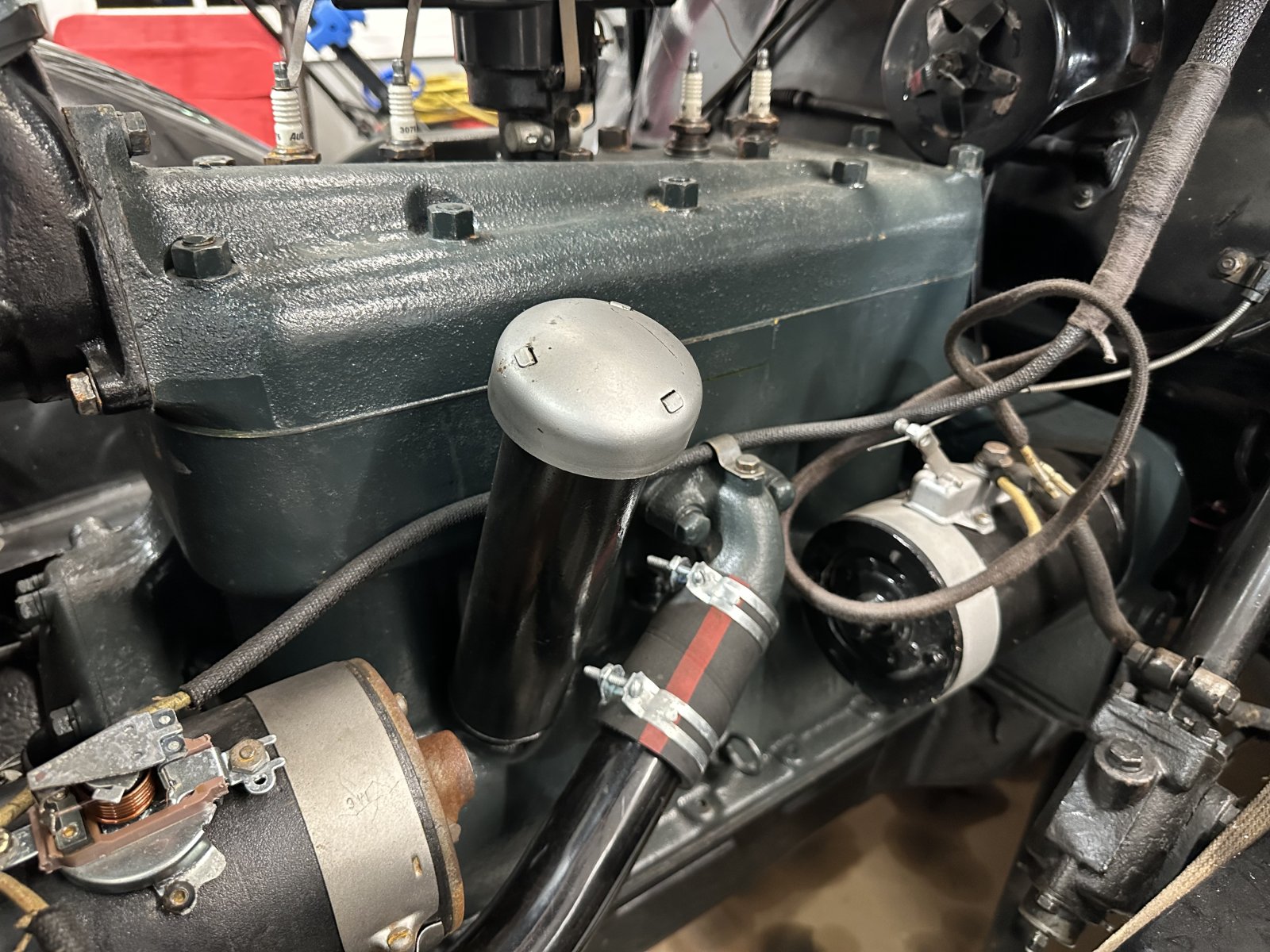

  22. Similar. I have a Mocal filter bracket that I’m figuring out where to hang. The pressure relief is built into the pump I’ll be testing for RKE. I’m fitting an early sump so I’ll be able to drop it out the bottom when the want to check it over. 45AA85D1-DF5A-4A6B-B599-188D00C4ECE2.jpeg

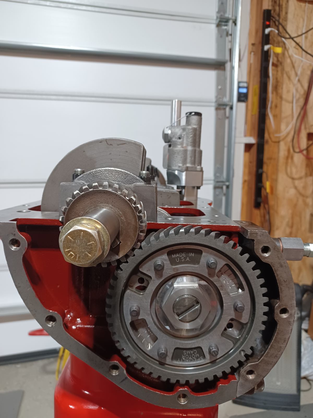

    In case you haven't seen an adjustable cam gear and John Neilson's oil pump.
    GuyW, Old Dawg, burl and 5 others like this.

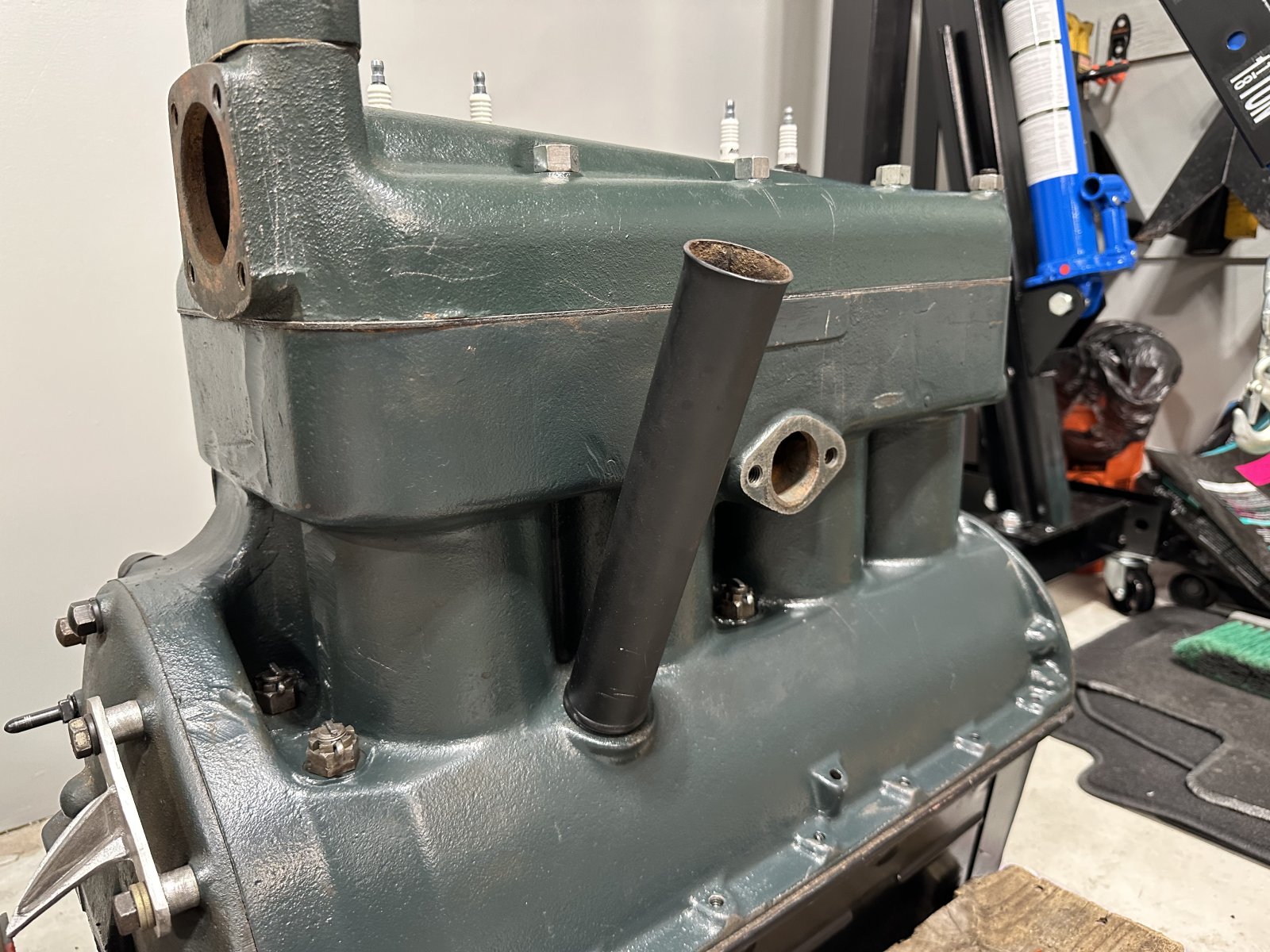

    My engines have different oil fill tubes. One of them is 1 1/2” in diameter and needs a cap the other is about
    2 3/8” in diameter. Are they for different years?
    Should I buy a cap or a different fill tube and cap? C038B13A-037D-431C-B1BA-22FE4A28669F.jpeg F0BCB364-8357-4D9F-B5C2-5B686811F7EA.jpeg

    They look like very nice pieces. I ***ume the cam gear is used to degree the cam. Do you find the cams are right on? Do you advance the cam a bit?
    winduptoy likes this.
  30. Crazydaddyo
    Joined: Apr 6, 2008
    Posts: 3,381
    Crazydaddyo
    The smaller tube is Model A. The larger is Model B. I have found no advantages to either one.
