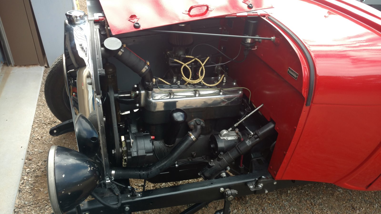

    IMG_20230306_130134189.jpg Donovan Head motor in and running...have tuning to do but it runs real strong. Believe it needs more valve spring as it hits the wall at 3400 RPM...
    metalhead140, Jet96, Old Dawg and 8 others like this.

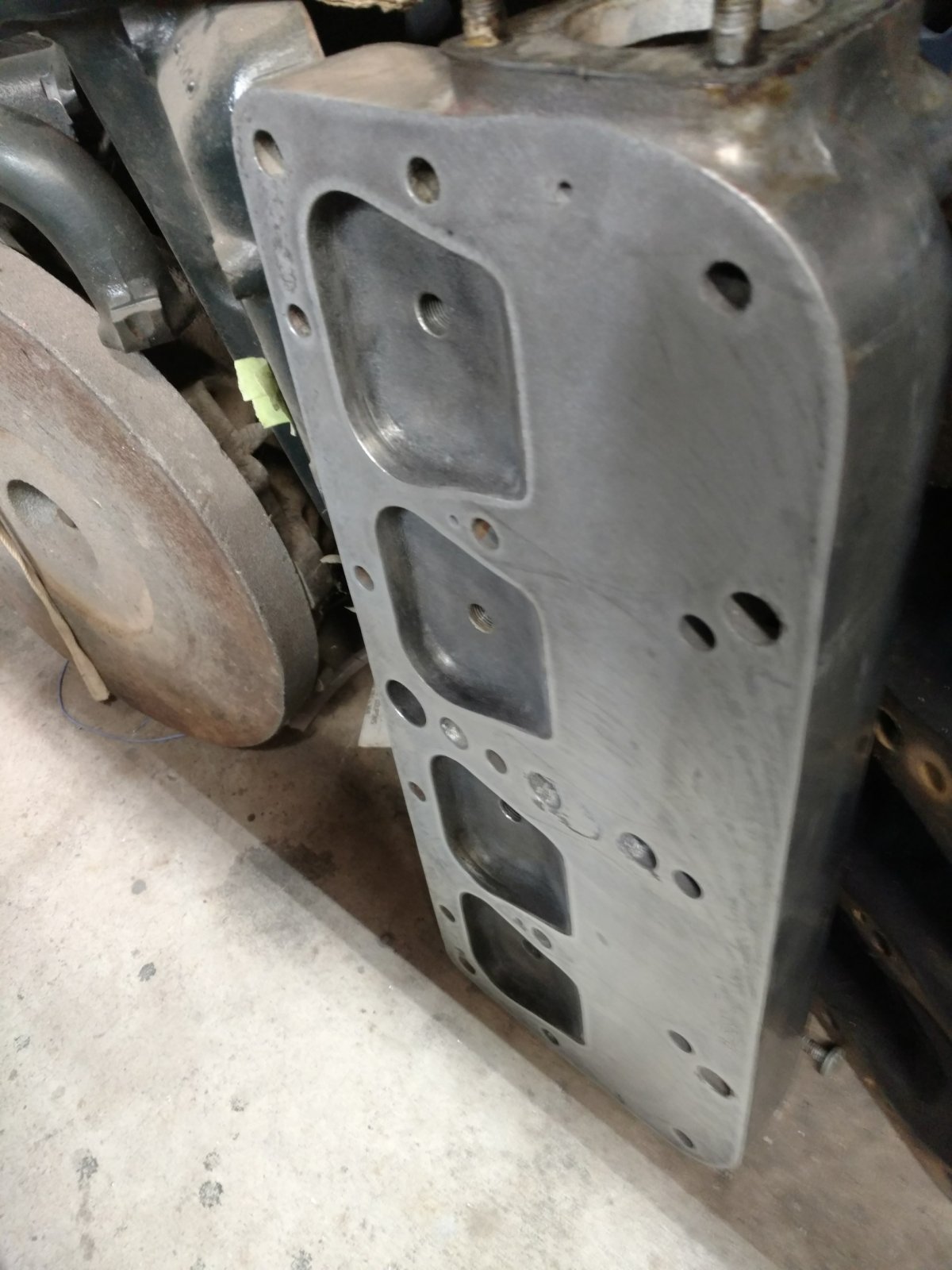

    What does the combination chamber look like on the Donovan head?

    Yikes! What comp is that running!

    Does that head require a zero deck height? I ***ume if the head was fly cut or at least my understanding of fly cut, that the piston could have a positive deck height?

  12. Looks very much like super Winfield head
    Not sure about CR but reducing the chamber too much will choke off the airflow

    9.4 CR figuring in the gasket thickness
    The piston tops were cut down to achieve a deck height that is zero at TDC.
    Yes, very similar chamber shape to the Winfield. I have my concern over the lack of airflow and that as to why the thing starts falling on its face around 3300 RPM. A set of stronger valve springs will answer that question. They are stock, no shims now. Thanks for the feedback....I will share the outcome of the spring change. It runs like a scalded ape up to that engine RPM so I have hopes and if not, their is head work. I've got Joe Abbin and his flow bench as a resource.
