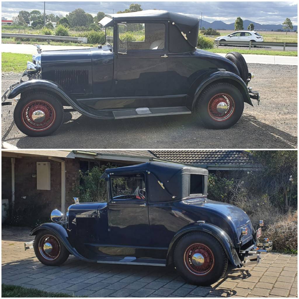

    Today was a success ended jetting both carbs up to stock jets and made it much happier, adjusted brakes (repro Lincoln brakes), cleaned the plugs, locked out the choke levers and few other bits and pieces, hot idle it has 30psi of oil pressure and 40psi above idle, driving around with the vacuum gauge hooked up it has 14-15 inches of vacuum at 60mph and cruises along quite nicely at 60-65 mph (3.54 gears and no od, b trans with v8 gears) it definitely has no problem keeping up with modern traffic, we are quite happy with it right now, dad @phill is taking it for a journey tomorrow so we'll find out how well it does then

    What size tires are you running? It sits just right.
    Star 351 and Outback like this.

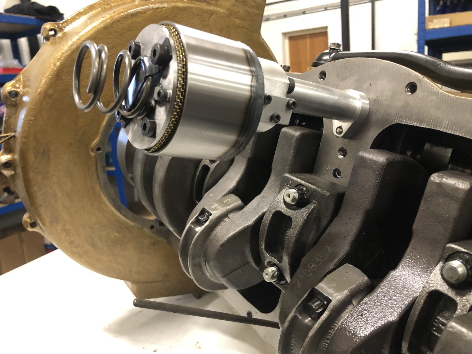

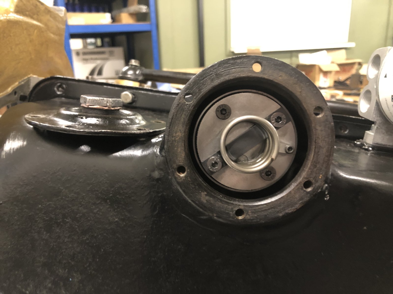

  7. Trial fitted a new oil pump from RKE (the same company making Rotoshim shocks) in the Burtz block tonight. Pressure set to 30psi.

    7.00x16 5.00x16 Stahl sport radials

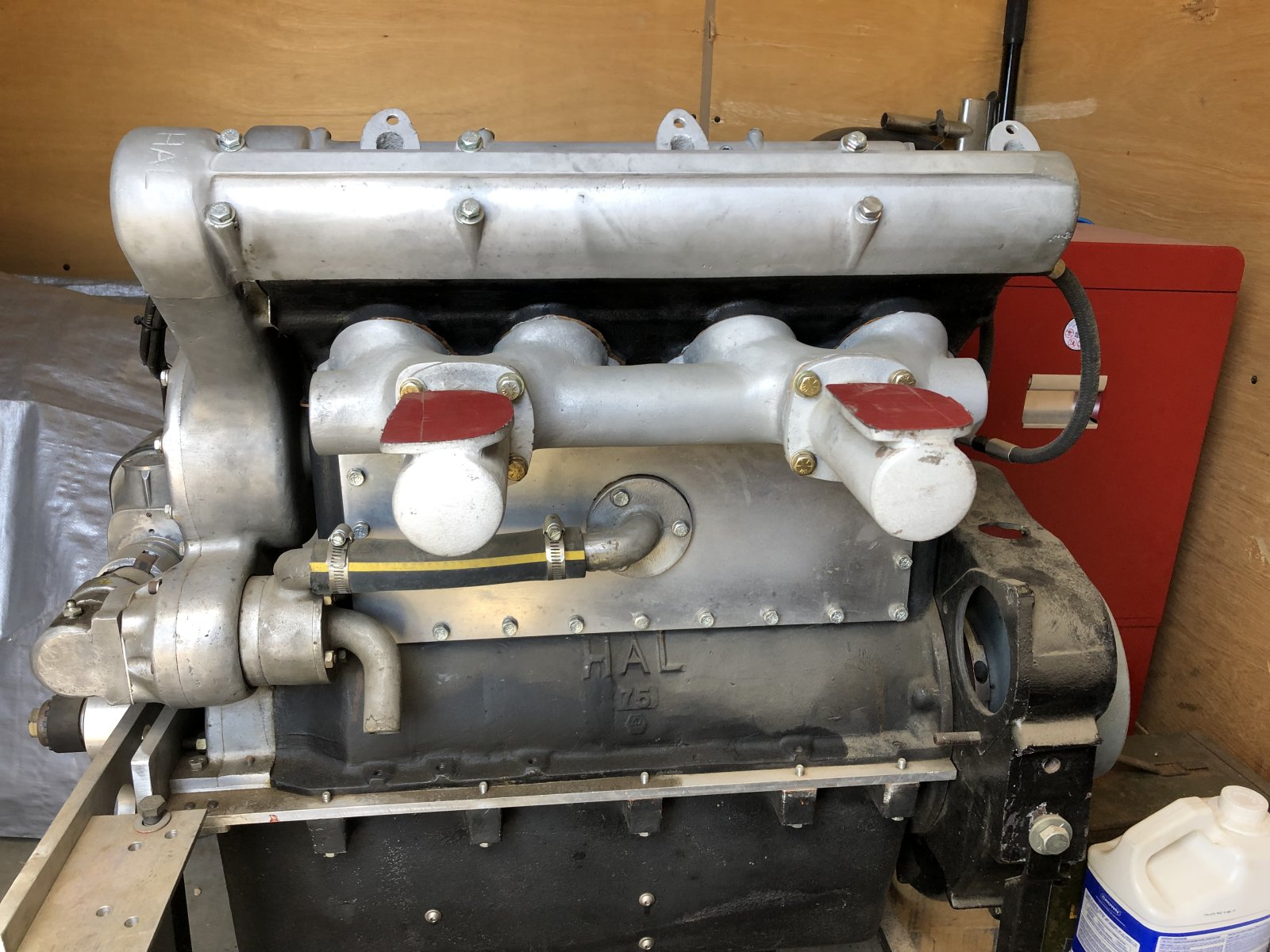

    I finally have some new "bangers" to share. I am looking for any more info on either one that may help with getting them going eventually.
    The D.O. HAL is on a 5 main block with gear drive cams. These always intrigued me as there is one in the local museum ( www.emmr.org ) called the "Offy Killer". That has always stood out to me as a neat deal to have a somewhat Ford based engine that was compe***ive with the big offenhausers. The engine needs checked over and some adjustments before it is ready to run but it seems to be complete and has had some freshening up here and there at some point.
    The S.O. McDowell is a complete basket case project. There is nothing in the block and all of the other parts are just loosely bolted together. This is a chain driven cam. It's a 4 port head which seems to have been redone at some point along with the cam and bucket ***embly. But all of the chain drive parts will need work along with the oiling and water systems. Everything appears to be there to make it go aside from some parts in the angle drive for the magneto but I think it will end up with a side drive setup instead anyways as I'd like to try to put it in a 32 Roadster. If anyone has a side drive with water pump that they'd part with, let me know.
    I'd like to find any info that may be out there on these related to timing them, etc. I've only had them a few days so it's all new to me having only really ever dealt with flathead 4's before.
    Thanks for any input - Zach

    We have a couple of those HAL's at work, what size is it? 116ci?

    I haven't measured myself but supposedly 212", it's a full size one, not midget.

  12. The HAL measured 4”bore and 4.25 stroke when checked last year
    Good to see it out in the daylight

    Do you know anything about the gear tower? There's some lash issues with the gears that seem to need attention before trying to run it.
  17. No
    Did not dig into this motor
    It could be partially chain drive
    GuyW, Stogy, Jet96 and 3 others like this.

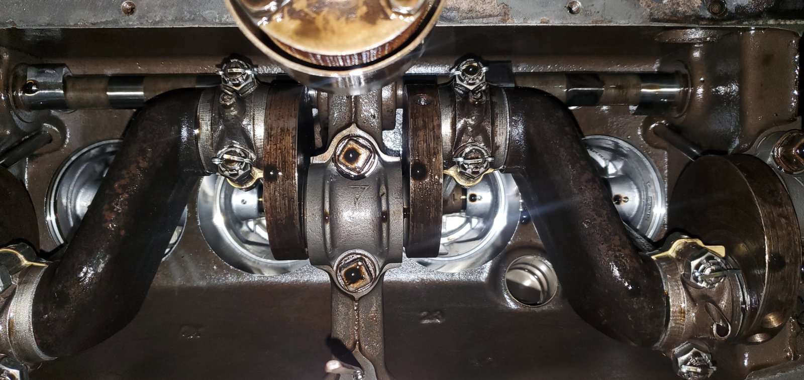

    Absolute new guy here, our first model a. We bought this a couple months ago and in the paperwork was a non detailed invoice for a rebuild written on a legal pad, tried to track the guy down but he p***ed a year or so ago. We pulled the oil pan to get a look at what we could and mostly just wanted to see it first hand as we have never worked with one before. My question is what is the br*** on the rods/mains? Are they shims for the babbits? Also, is there anything in these pics that jumps out to any of you experienced guys.

    The br*** things are bearing shims- usually laminated- you peel laminations off to tighten/adjust the bearing clearance. The ones on the rods should look like the #4 rod. Looks like a few of the others were not inserted all the way in for some reason. I would loosen the rod caps on those rods and push the shims all the way in and then retorque the rods to 50 ft-lbs.

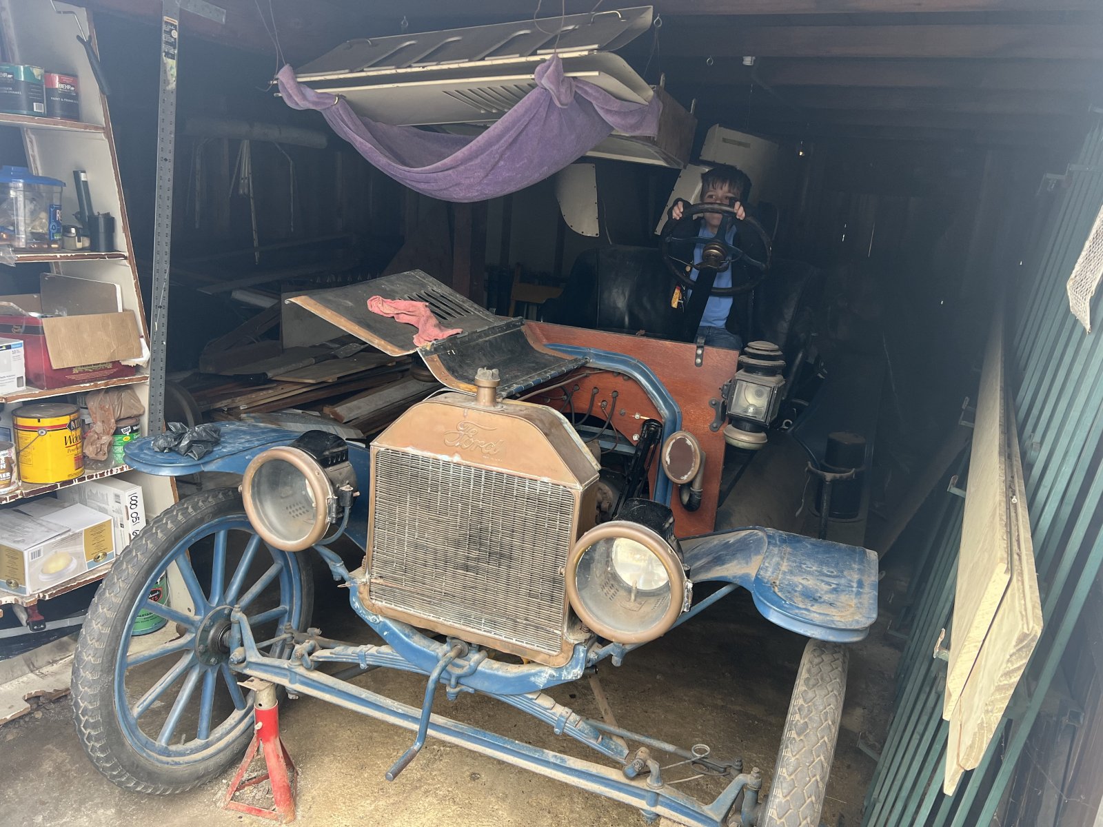

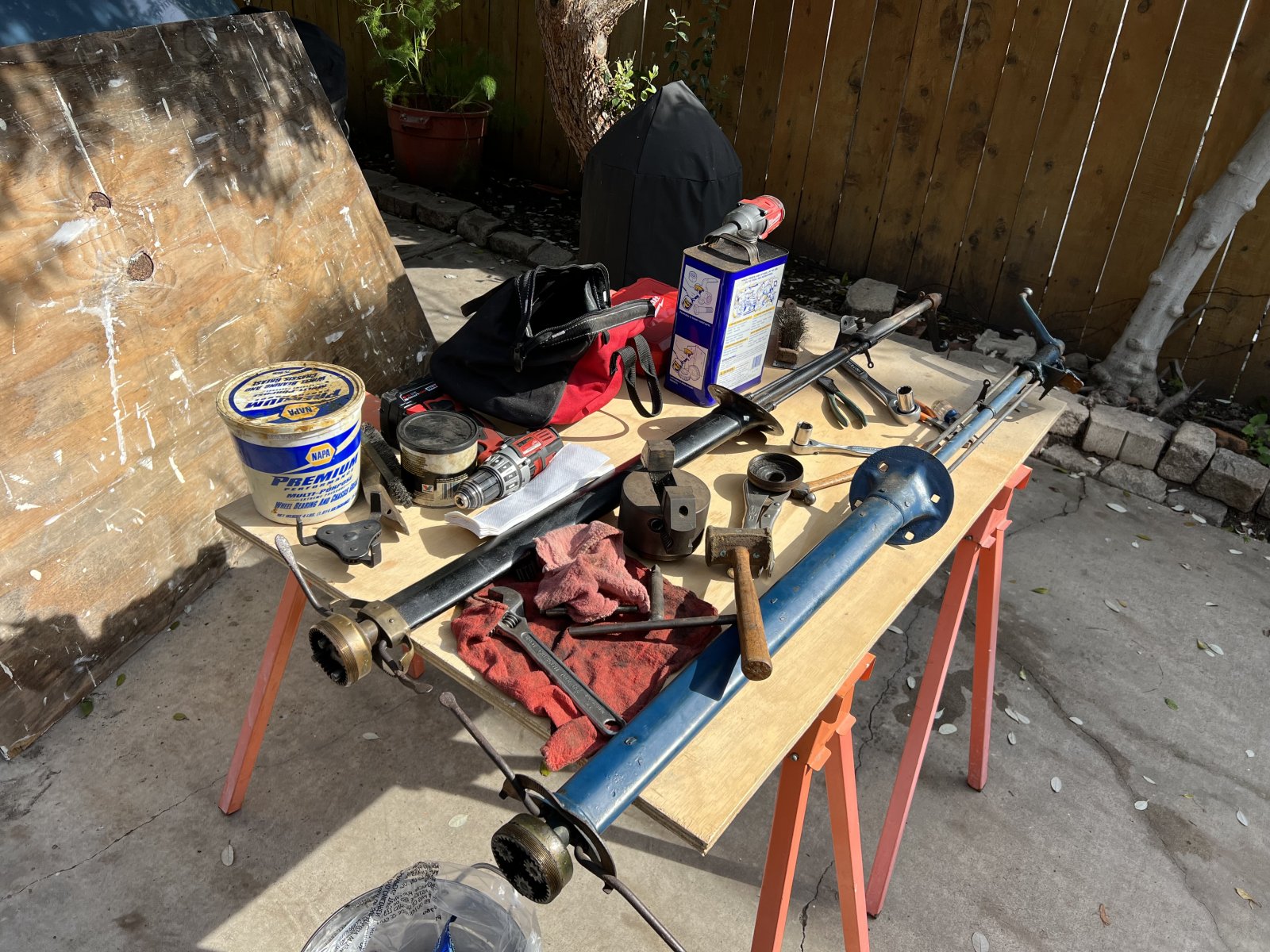

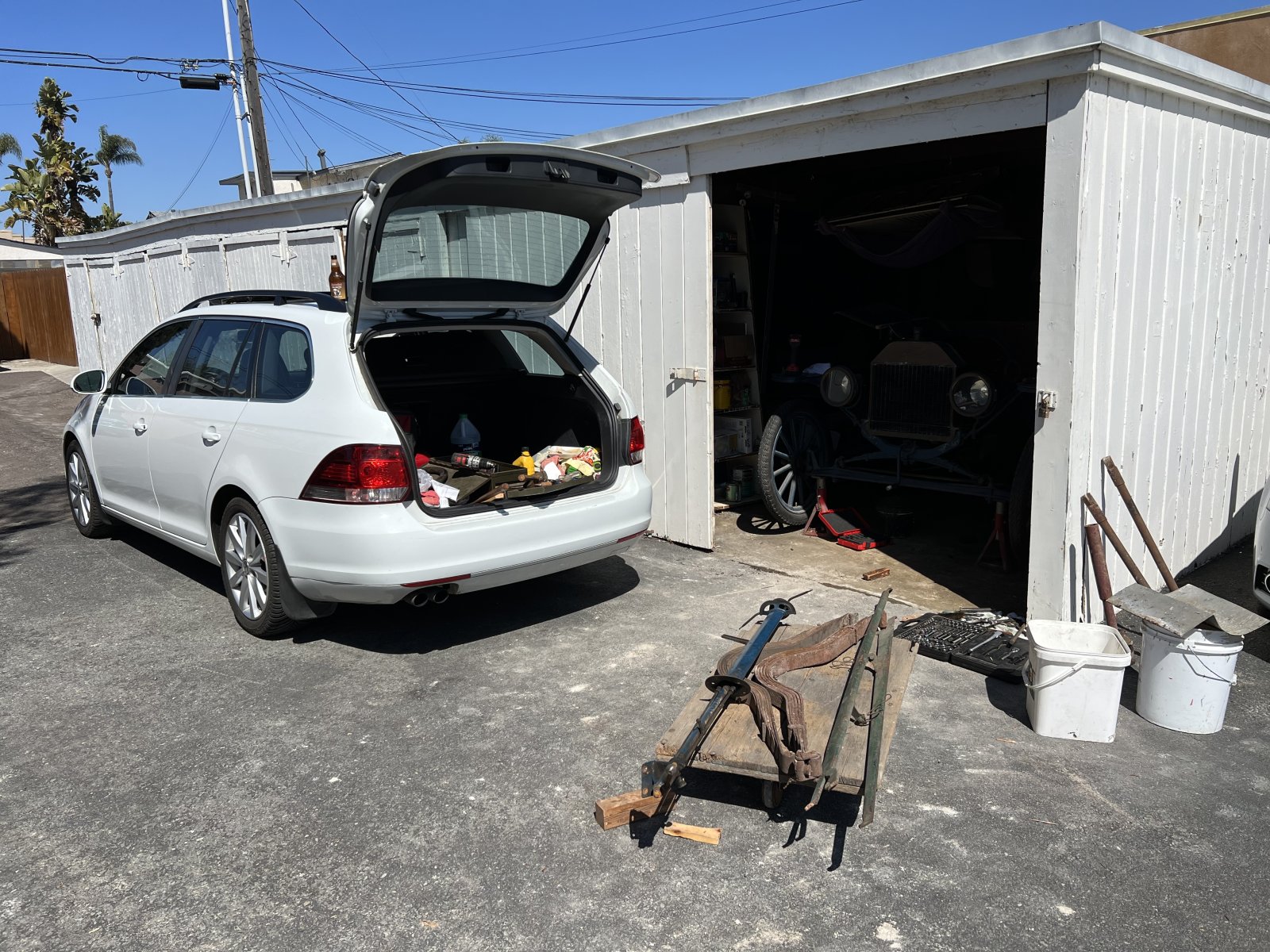

    Parts from the pile on to the car. My father built his T when he was about 12 or so. He was out for Thanksgiving and saw an early T column I had in the pile, mentioned he almost bought one at a swap meet. Said he should just use that one. Fast forward, my son and I drove out from Tucson to install it. Learned why it was so cheap...someone mangled the **** out of the br*** bits with a mallet. Bit of lathe work, swapped a few parts and in it went.
