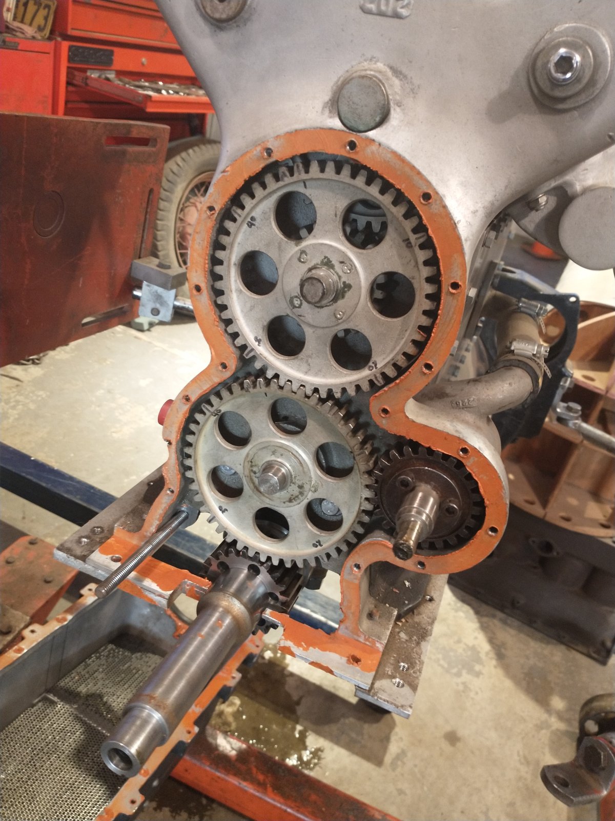

    Bad news on the HAL front.... unfortunately looks like this engine will need to be completely gone through. I noticed some odd lash in the upper part of the gear tower. Seems the cam blocks weren't fit correctly to the head and the idler gears are shot. The exhaust cam was so loose you could turn the crank almost 10 degrees before the cam moved. intake cam so tight that the tips of the teeth dug into the base of the idler. Looks like those 4 upper gears will need replaced and in the process of this happening there is metal shavings from the gears throughout the engine... with some help it looks like I found some ready made gears that can be modified to work. thankfully the rest of the gears seem pretty darn nice still. Pulled the pan and looks like a cast crank, not billet. It does have the nice tubular rods like an Offy though. Appears they hit the aluminum pan rail adapter a bit... At this point I don't trust any of the work with signs of shoddy craftsmanship all over.... so starting at square one I guess..... Overall its still a good engine to start with and not easy to go find another., just going to need a good bit of going through and more money invested before its ready to run.
    here's some photos if you've never seen inside one of these.
    ya win some, ya lose some.... IMG_20230318_070830845.jpg IMG_20230318_070853415.jpg IMG_20230318_103140567_HDR.jpg IMG_20230318_071952316.jpg IMG_20230315_151318937.jpg IMG_20230315_140601663.jpg
  4. UGH, it was delivered here as a "rebuilt, ready to run" motor for my Buddy.
    He took off to NZ and it sat thru Covid in the trailer.
    It looks like we dodged a bullet here, sorry to p*** along to you.
    Those gears look to have been run for a while like that and should have been howling pretty good.
    Hope the cams are not too beat up, everything else can be easily fixed, cams take a little finesse.
    I was just looking thru some do***entation, all A/B motor DOHC and cams are chain driven.
    Hope you get this running, John

    Thanks John,
    Almost looks like it was ***embled knowing it had the bad idlers and the rest pretty good but then the incorrect shimming at the cams caused it to eat those gears a bit too when fired for likely just a short time....probably because of the noise I ***ume. Luckily it was loose enough to not hurt the big center idler. Stripped holes and other work just seems it wasnt done by a very tedious person so I'm going to check everything out. A good excuse to learn more about them rather then just run it ....
    The actual cams are still real nice, just the cam gears too the hit.

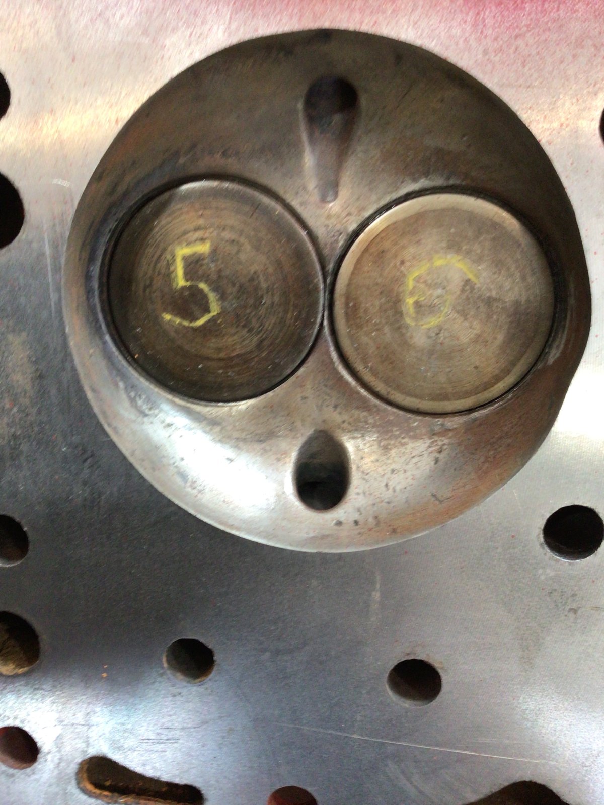

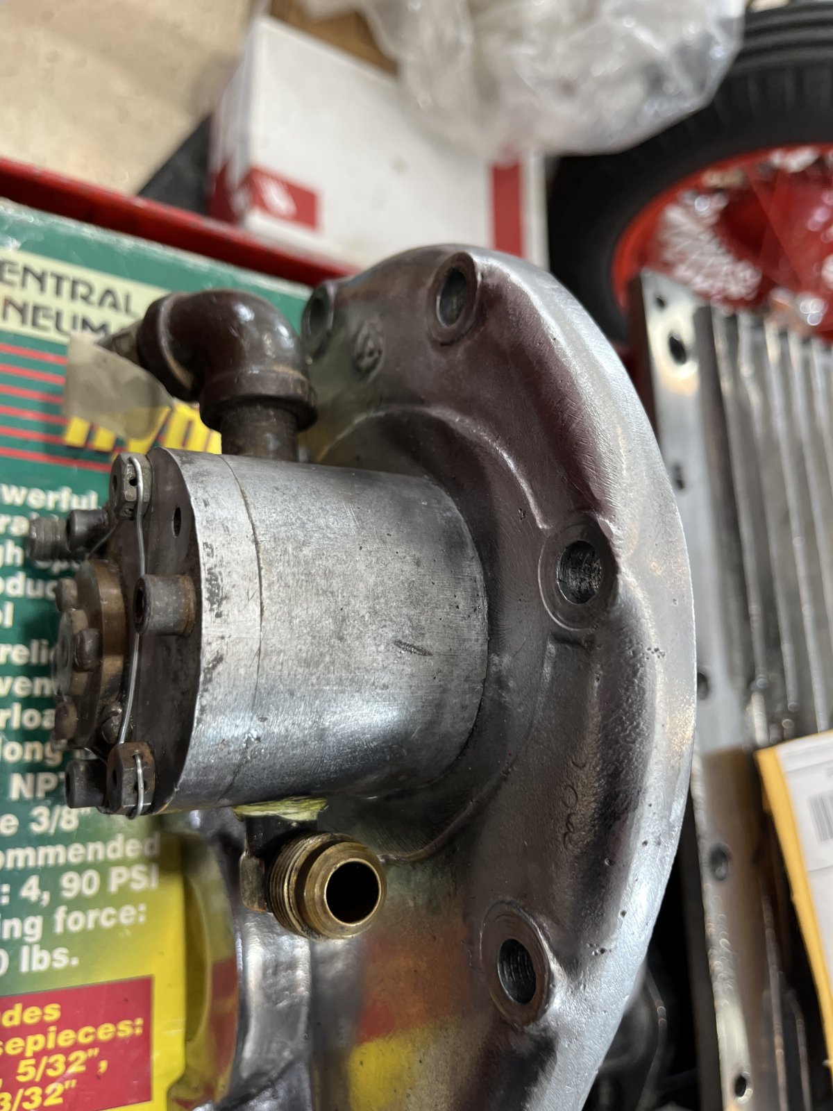

    I took the engine out of our 30’s Flat Tail Race Car to freshen it up, and thought some may find the parts interesting. Pictures attached.
    1. Race Car, B Engine McDowell OHV.
    2. Front Drive Oil Pump driven off Cam Gear. Pick-up tube in Pan covered by a screen, Output to Regulator, then Oil Galley beneath Side Cover. Oil P***ageways to Mains enlarged.
    3. Side Drive Magneto. Don’t know brand.
    4. Piston Dome at TDC. JE Piston Number is X99, 4” Diameter.
    5. Head Combustion Chamber. Valves are 1.75 in.
    6. Strengthened Front & Center Main Caps.
    This engine is much different for me. Progress is slow, trying to not make any mistakes. Going to check Pistons-Head-Valve Clearances this week.
    - 1AB0CF27-1DB2-4D1A-8DB7-AF599C011E40.jpeg 532F8A6A-B2B5-4727-88F8-47FA81E604A6.jpeg B97A5674-D21F-40B3-A78E-B7DA4E84B639.jpeg ADC4EEF5-48F2-4295-B024-F1594E8CEA7D.jpeg 5CDC09AC-6694-4C60-938E-724DDDEC6F29.jpeg D942532E-EF4D-42B2-9A45-126A869CF110.jpeg

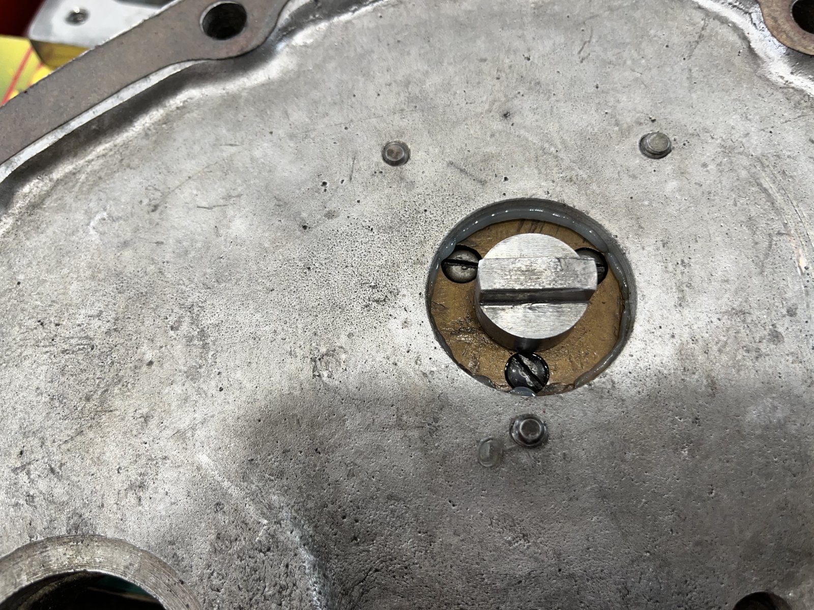

  20. That's fascinating! Do you mind posting more photos of the cam gear / tang, and the back of the timing cover?
  21. 29 Speedster
    Joined: Aug 2, 2011
    Posts: 197
    29 Speedster
    from Colorado
    The Timing Gear Cover is special made aluminum with machines mounting location for the pump. The interface to the timing gear is just a slotted shaft, the fixture on the gear bolts to the timing gear.

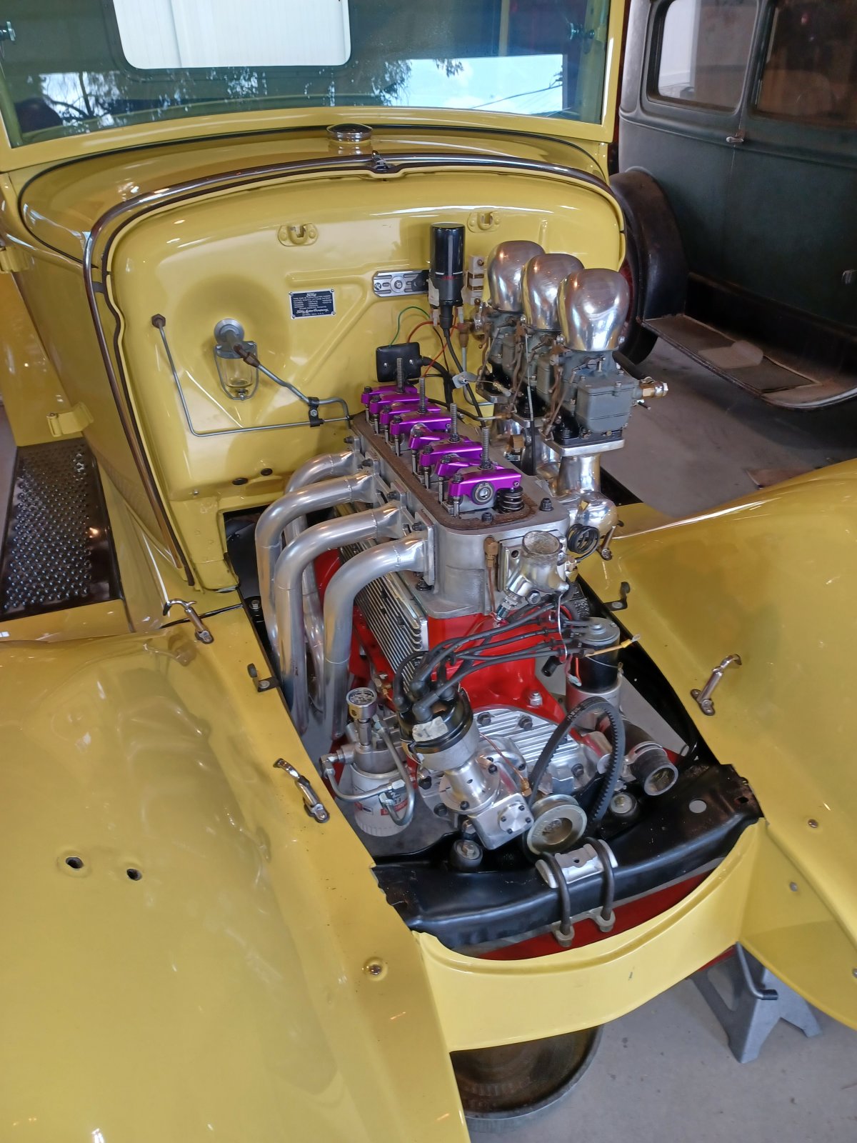

    Dropped off a cam core at RedLine Cams in San Jose today… now I just have to wait! Until then, I’ll be building the exhaust, oil lines, and throttle linkage
