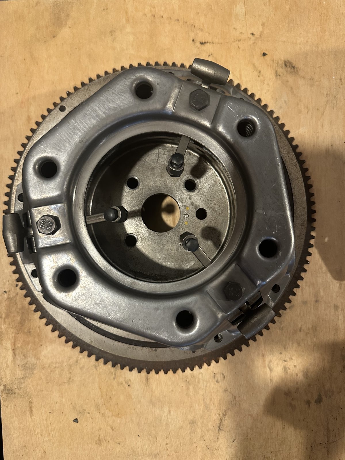

    Shops specializing in drive lines have special shouldered, hardened bolts for this application. In fact I think the bolts are a stock Ford item for "modern" flywheel/clutch ***y's.
    GuyW and 4BangerDean like this.

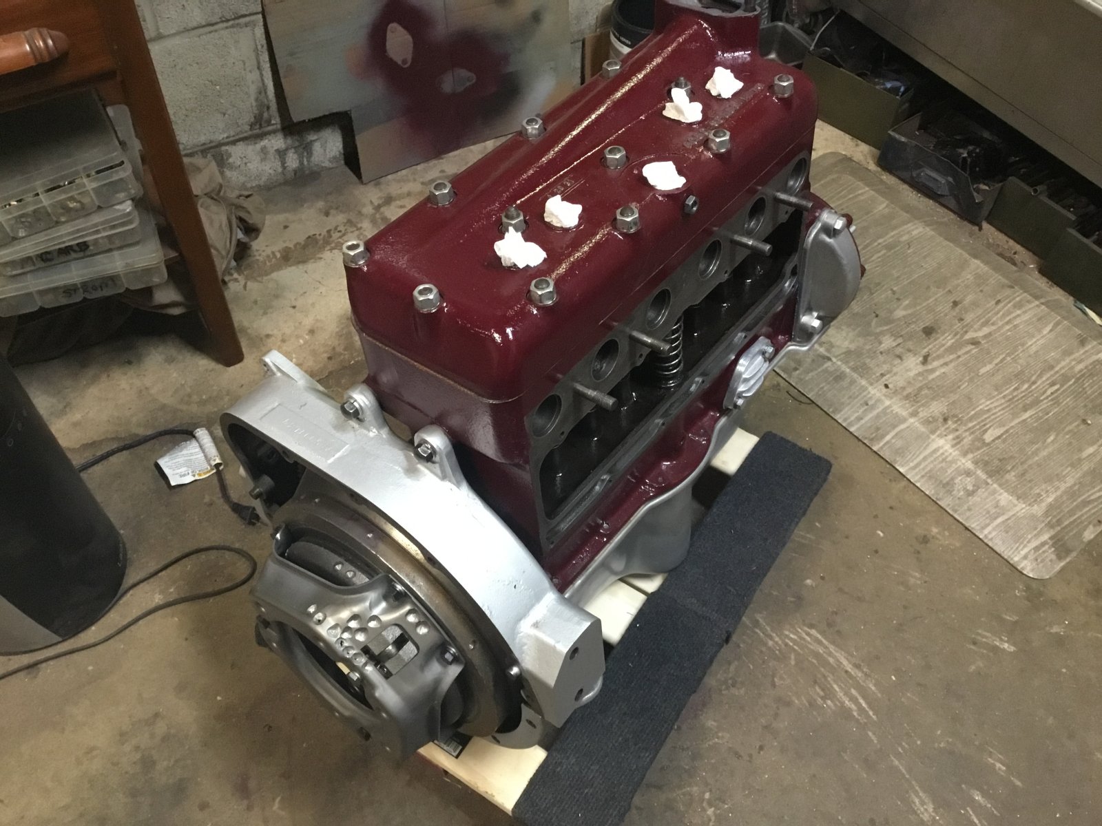

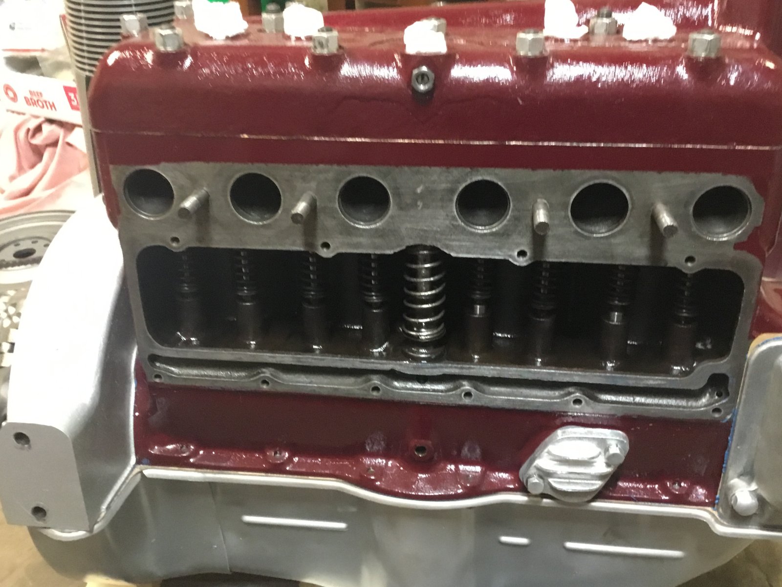

    Ok, needing some help. Inserted B motor toasted the rear thrust washer. Got replacements from Mikes and they are the wrong size.
    So it looks like thickness is correct. .25" What I removed was .2145, yeah that worn out but was not giving any issues.
    The Id is good. 2.00 " and what I removed was 1.94
    The OD is way out. 2.88 and what I removed was 2.59
    Does anyone have a way to get the correct size. Or do I need to tear this motor down all the way and open the rear thrust surface cutout up to accept these washers?
    I don't have a lathe or machine shop in my garage so I am a bit limited.
    Any help is greatly appreciated.
  12. AZ_Nick
    Joined: Nov 29, 2015
    Posts: 45
    AZ_Nick
    That's probably the old Continental Diesel thrust washer that was commonly used before the AER stuff came along. I'm away from the shop right now but someone one here or a search will turn up the part number. OD machine surface is not that critical as long as it captures in the machined pocket. You could scribe an arc 0.145" along the OD and carefully remove the excess with a belt sander and or file.
    4BangerDean likes this.

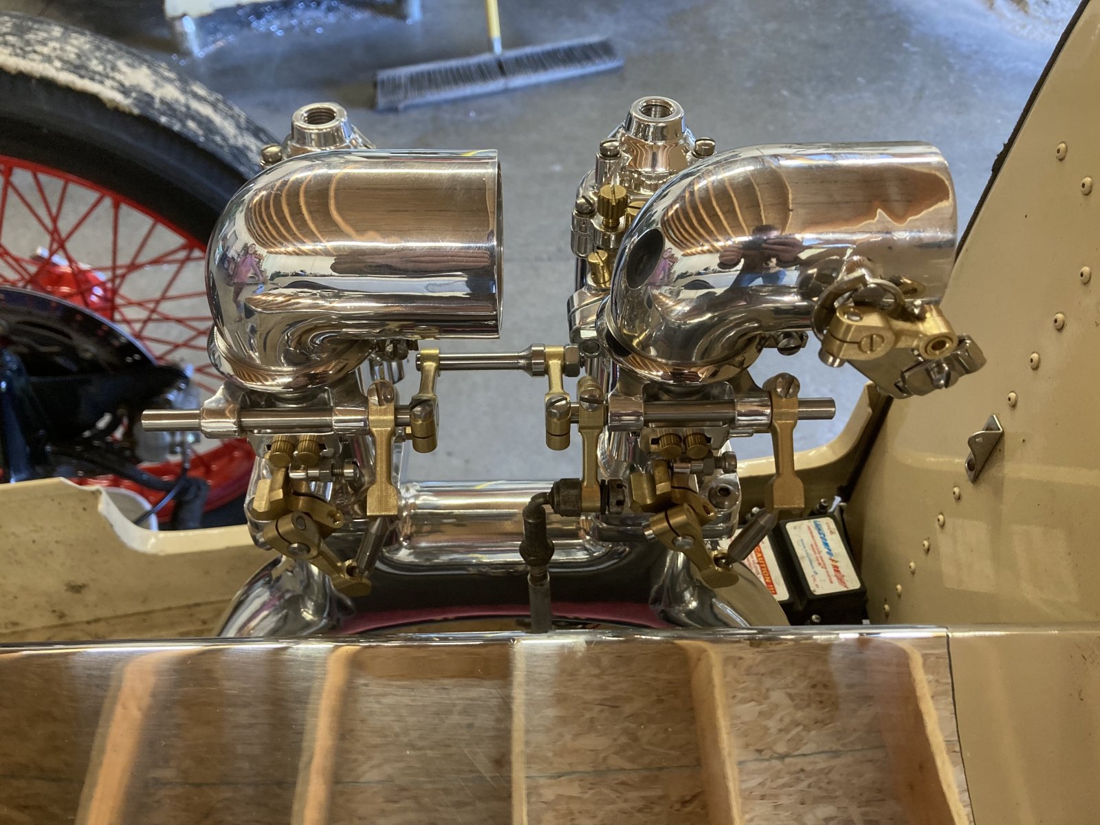

  13. Slowly but surely! Time to start working on the gear and shaft situation. 338590284_1838057563246096_744587919599547054_n.jpeg
  14. Jeff34
    Joined: Jun 2, 2015
    Posts: 1,312
    Jeff34
    That winfield intake setup is GORGEOUS!

  17. stubbsrodandcustom
    Joined: Dec 28, 2010
    Posts: 2,625
    stubbsrodandcustom
    from Spring tx
    I scribed it and cut it down this morning. got it all installed, can only put a .004 feeler gauge in there now so i feel good with it.
    Thanks. Yeah its probably some weird stuff for sure. It worked out good though. Thanks.
