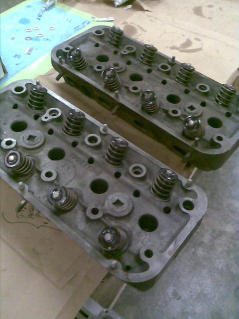

  8. ATX ENGINE MAN
    Joined: Apr 7, 2009
    Posts: 6
    ATX ENGINE MAN
    from AUSTIN
    Just finished up honing the new guides to size, and valve job. Nice custom 5 angle... should compliment the "little" port job. ;)

  15. ATX ENGINE MAN
    Joined: Apr 7, 2009
    Posts: 6
    ATX ENGINE MAN
    from AUSTIN
    Added a back cut to the valves, heads received the final surface, wash and ***embly. Ready to rock and roll!
  16. MR. FORD
    Joined: Aug 29, 2005
    Posts: 1,636
    MR. FORD
    from Austin, TX
    HOLY COW! Amazing work Chris.........!! Now get some sleep!! I owe you beers for life!
