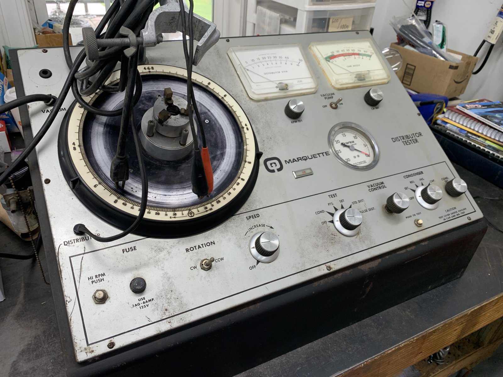

    I recently acquired a Marquette Model 42-127 distributor machine. It is complete and aside from being dirty appears to be in good shape.
    My question is does anybody know if this machine can be used to check the advance curves on non points style distributors ?

    This is the machine.

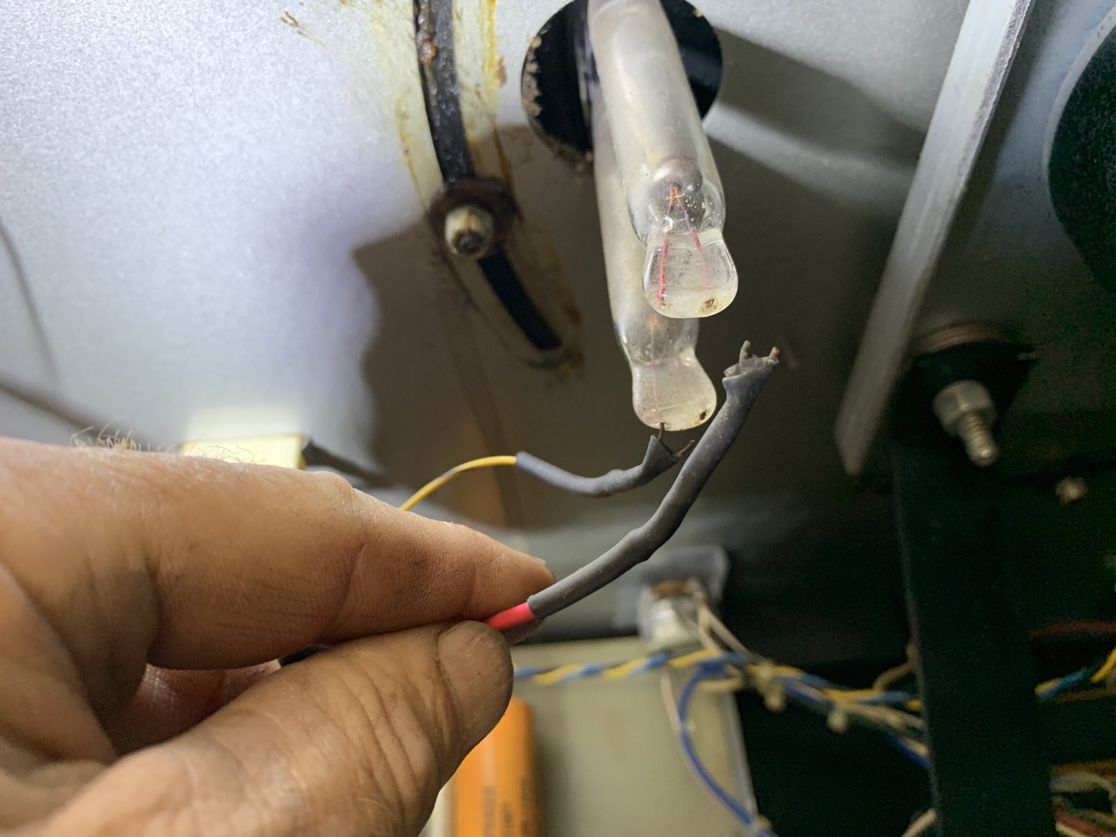

    Also discovered that 3 of 4 leads are off of the bulbs .
    May try to resolder them.
    Has anyone ever converted these to LED bulbs ?
