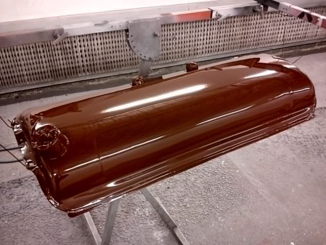

    Late evening today I got a text mess from my friend and painter Totte with a pic . First thing that he have painted for my 32 . Next thing up is the frame, it will be this red/brown on the outside rails and semi gloss black on the inside.
    Totte, you are the man :)
  13. nailhead terry
    Joined: Mar 23, 2008
    Posts: 1,460
    nailhead terry
    I will see you one red tank and raise you a blue one . The Bettie 32 is getting some color too

    Joined: Aug 14, 2005
    Posts: 2,999
    bonesy
    That color is awesome! I can't wait to see more.
  15. langy
    Joined: Apr 27, 2006
    Posts: 5,730
    langy
    Nice colour Martin, keep them pics coming.

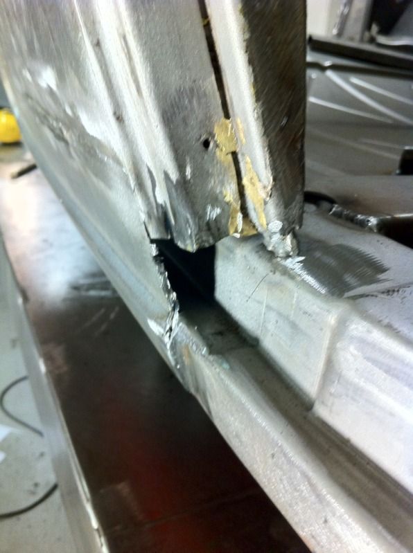

    from Sweden
    Hi Folks, havent so much to show resently. Have been doing some more metal work on the body and there is still loads of hours to do there.
    Took out some rotten wood the other day and ordered some new from Artwood. The top kit,rear and side window wood.
    This metal-part is located between the rear window and the side quarter window and it was filled with some kind of paper or something. I belive it supposed to be there for making interior mounting .
    Anyone knows ? , and someone with an idea what to fill it up with ?

    Joined: Aug 9, 2011
    Posts: 660
    Heo2
    Den är för att spika klädseln i. Pappen kallas
    tac strip. Dom som säljer Ford grejer brukar ha den
    man brukar limma ihop masonite till rätt tjoklek
    ibland oxo men lite svårt o den böjen och jävligare
    att spika i
