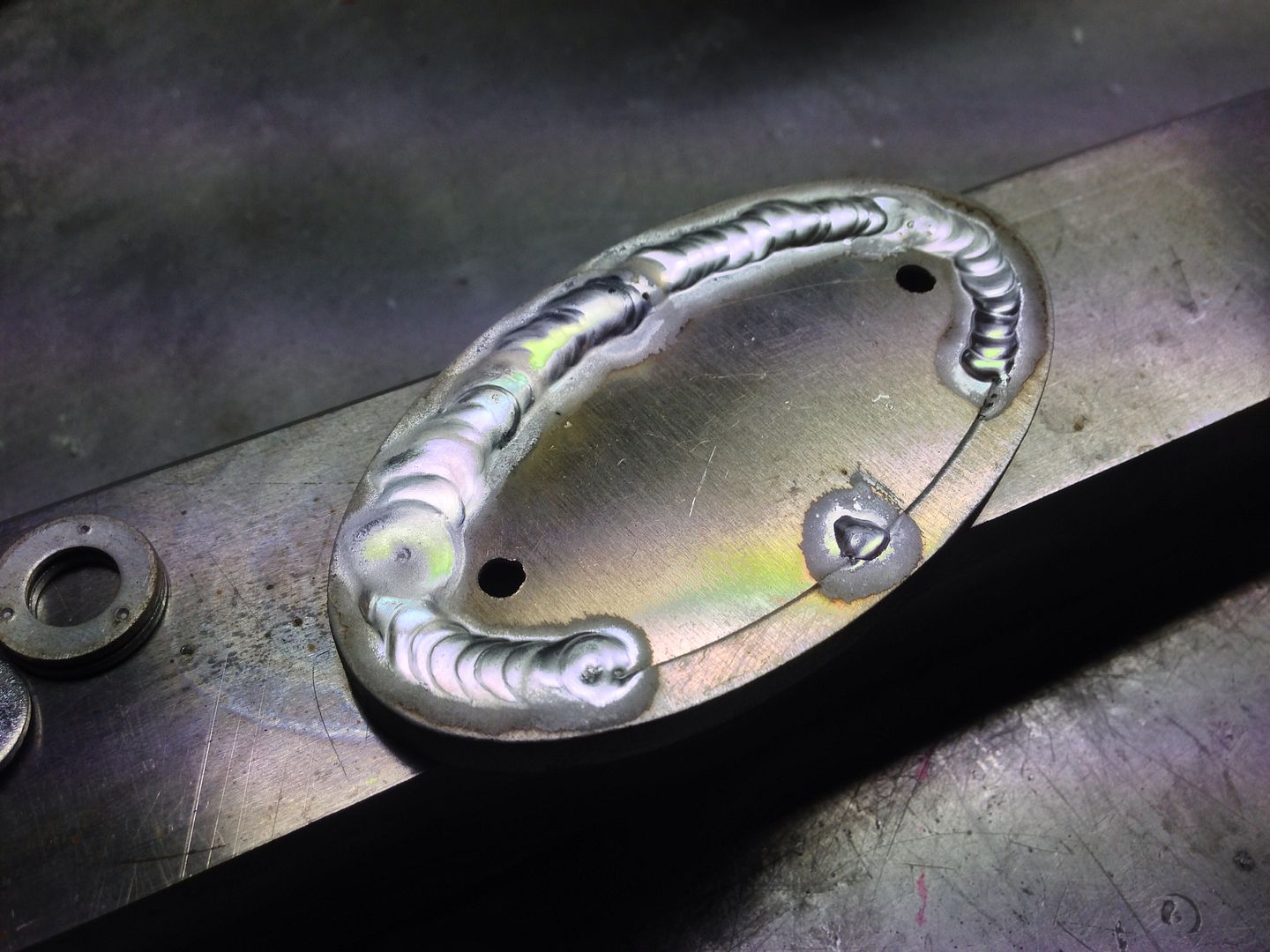

    First thing was to dotweld it together with the tig and grind it.
    Then it was adding bondo and grind it to get radius on the inside edges .
    This panel is the model for future alu casting . All edges need to be angeld to get realese in the sand.

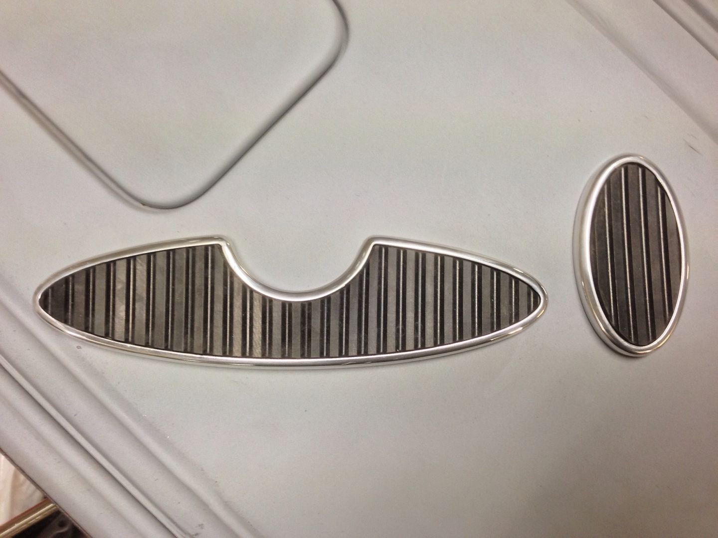

    I let the switch panel leave my head today and spend this evening to build a gas and brake pedal . My plan was to have some casted pedals but I did it like this instead.

    The brake pedal might seems strange, in this little contry there is a law saying that you have to be able braking with your right foot and that the pedal has to be on the right side of the steering column.
    With this one I can use both left and right foot to brake :)
