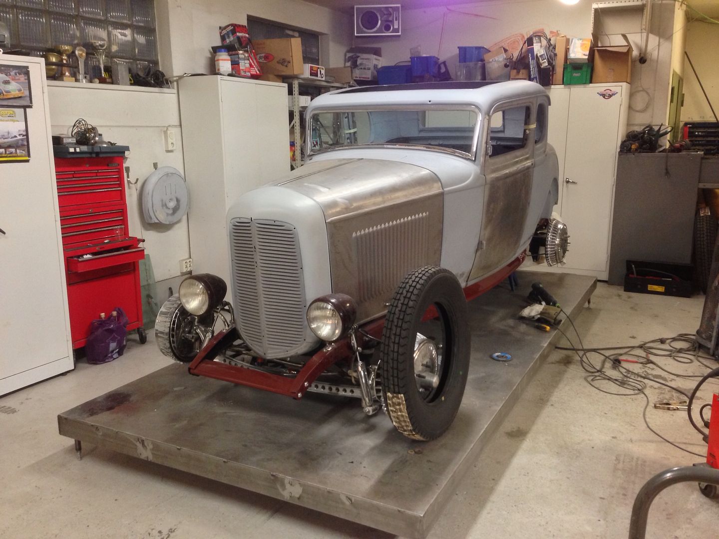

    Started with the top trim for the shell today, it needs to be longer and another shape to fit the 32/adler front.
    Some hours still before its done.
