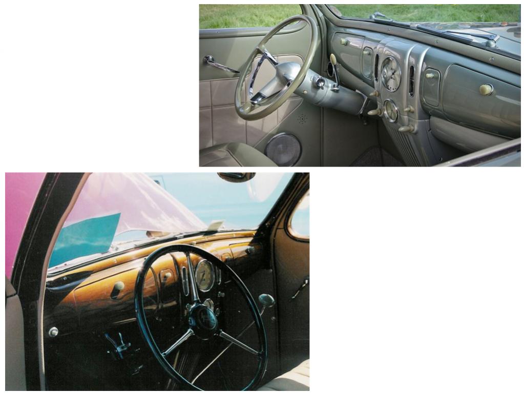

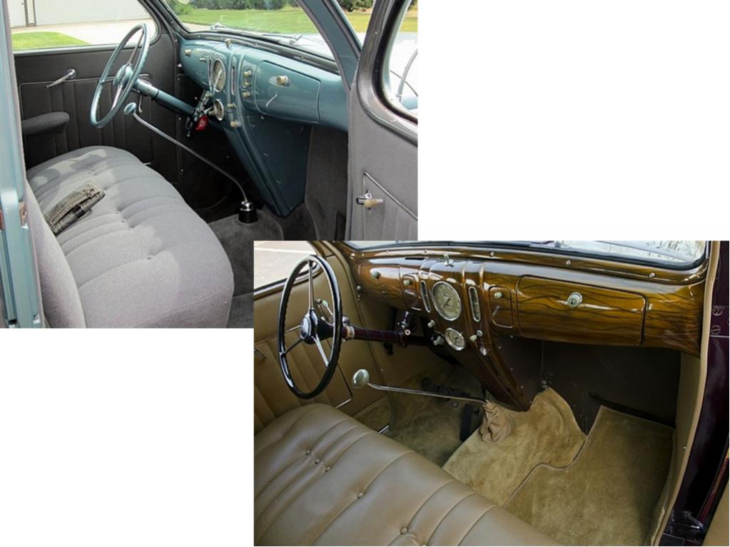

    :)Sending some pics for inspiration, but you prolly got it figured out already.:D The heater is too big a diameter ? pics show round vents in the sides and the front grill could be baffled.Defroster plumbing should be simple. Inside the lower part a non covered heater core can be housed with no prob, but your electrical components are mounted above, they don t need the heat. Also I noticed your horizontal dash looks shallow. Then I observed the customizers added rolled panels to the bottom edge.
    brEad likes this.

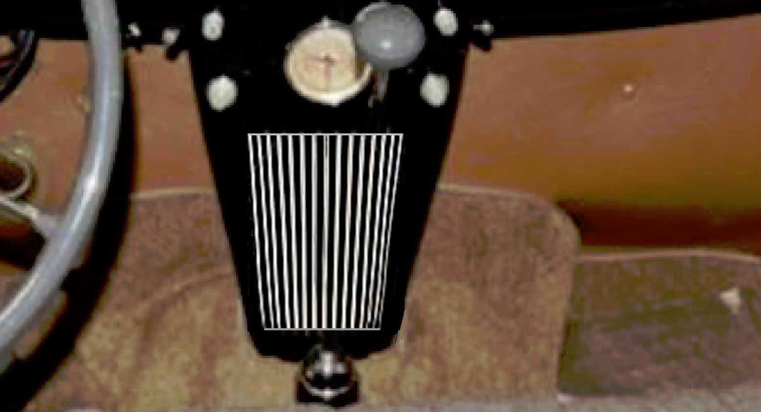

    :)Martin, How about an aluminum water-cut grill like the pic for idea ? :D
  28. tmfcracing
    Joined: Feb 25, 2009
    Posts: 984
    tmfcracing
    from Sweden
    Thanks Tnomoldw for all those pics :) making a grille crossed my mind but I like the stock Lincoln midsection to much to change it.
