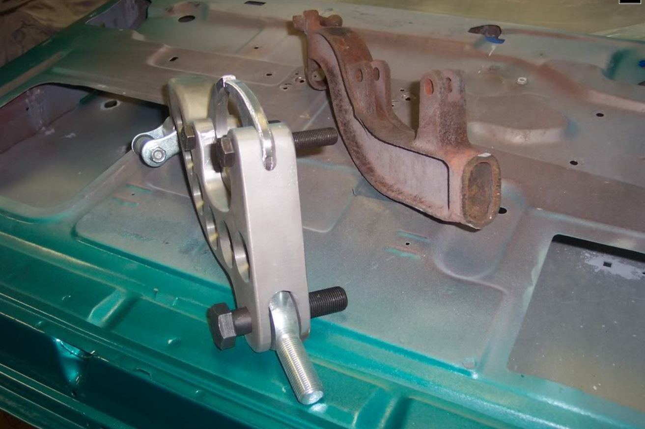

    :)Are you reworking the back too? Look what I found. A guy made these on his lunch hour..:eek::cool:

    Most prolly not all could be made on your water cuter,,, ?

    The waterjet sure has it limits, only 2 axis . To make the part you show the solution would be in multiplied parts and weld. The Lathe will come in use.
    Another deal for the guys with a 5 axis mill :)
