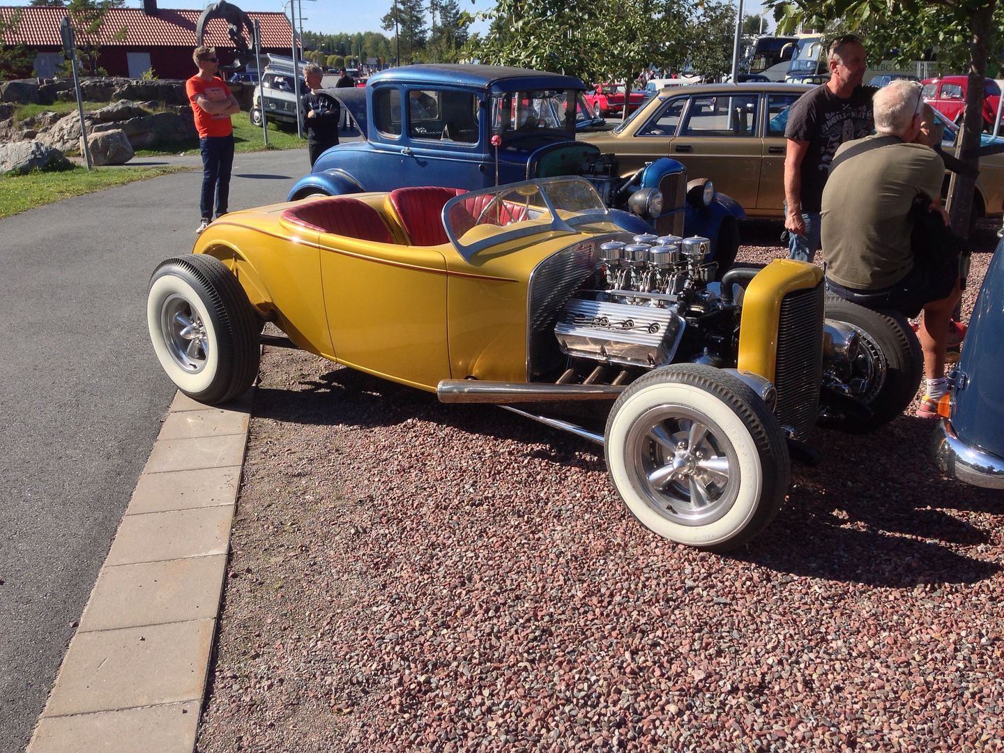

    Just have to show you this one , meet my mate Charley Swordson on a swapmeet the other day.
    He had this roadster done back in 1992 and have used it a lot during the years, he even had it over to CA once.
    Pics speak for themself :
    kiwijeff likes this.
  9. Jeff Norwell
    Joined: Aug 20, 2003
    Posts: 15,296
    Jeff Norwell
    MODERATOR
    Martin... just fabulous...I have Charley Swordson's roadster burned in my mind... from the first -re issued Hop up years ago...... I just LOVE that roadster....
    It still looks very rad........

    in that roadster...where is that steering wheel from? cool cars!!
  11. Jeff Norwell
    Posts: 15,296
    Jeff Norwell
    MODERATOR
    If I remember correct.... its from a boat..... I think.....
