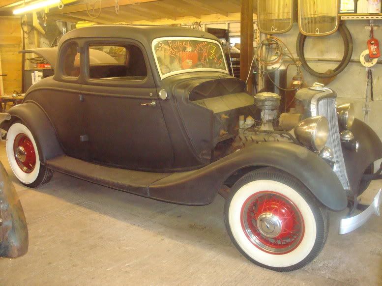

    Just spent the last 3 months working on a survivor 33 5W coupe. This post will cover the first month, roughly mid April to Mid May.
    The car had been laid up in a barn in 59. It used to run around Kansas City Missouri in the mid to late 50's. It passed through a few hands recently and was blown over in black primer and the chromework painted silver, but what attracted me to it was that it was almost complete, had some mild mods from back in the day, and best of all it had never been stripped to a bare shell, as so many have.
    Most of the posts will be pasted in from another forum so will be written as they were happening, rather than in recap form now. I tried to lump a load of posts together, but can't do that as there are too many images. I'll have to keep replying with the next installment.
    Mart.

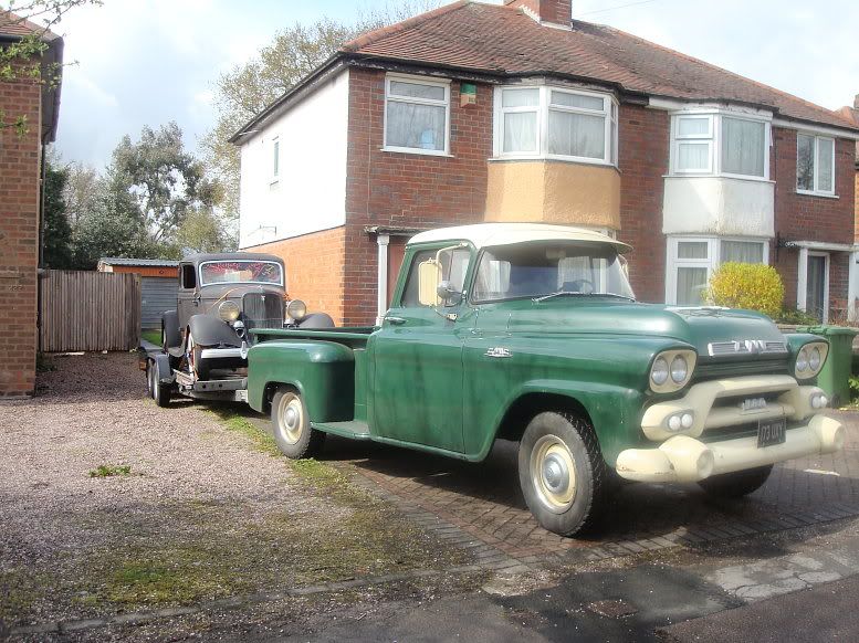

    Got up at 5:15 this morning, on the road at 5:45.
    Nice easy ride down. In the '58 GMC towing a very nice hired trailer. Bit of traffic, not too bad, got to Chatham at about 9:30.
    Russ from R and R turned up and we got the coupe pushed outside.
    After making a right arse of myself reversing the trailer, I managed to get it loaded up.
    And on the way out took a shot by the cranes:
    It was raining by now, thje paint is much more matt than it looks in this shot.
    A couple of the obligatory "tailgater" pics:

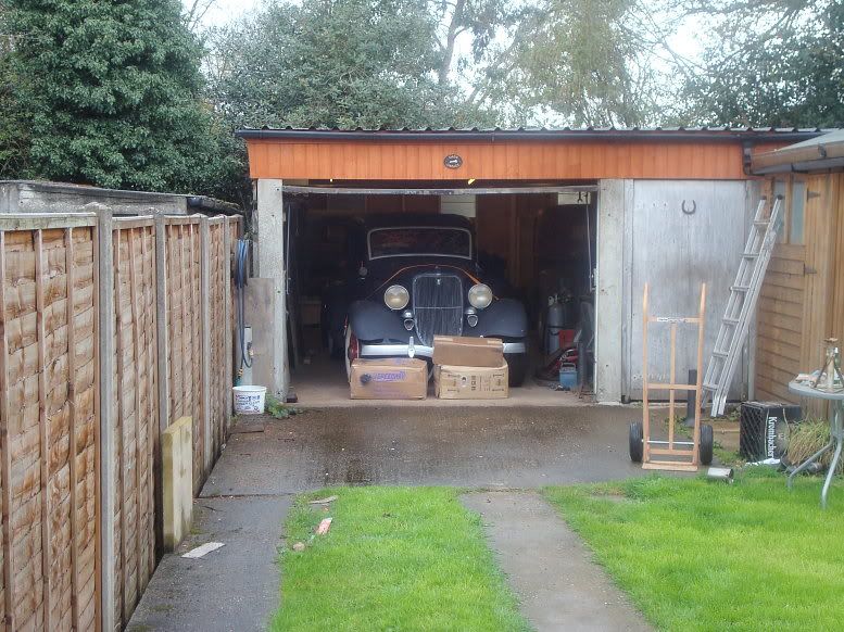

    Home by 2:30, and managed to reverse alongside the house. GMC is now known as "The CHAMP".
    And as luck would have it, a mate just happened to be passing so we were able to offload the 33. (I offloaded it and he helped me push it into the garage).
    So now it's safely tucked up in my recently tidied garage while I make my mind what to do. I can guarantee though, that much tinkerage will ensue. Will start a proper build thread when appropriate.

    Getting started:
    This thread is to document the work done on my 33. It will show everything - warts and all and will also be a record of the as found condition.
    I don't have a real clear cut plan, just a few ideas. I just looked and realised it was 3 months since contacting the seller about the coupe, and picking it up.
    The deal was delayed when the seller changed his mind about selling it, but at least I was first in the queue when he did then re-decide to sell it.
    I'll take some detail pictures when I start doing something, but the plan of attack is loosely based around:

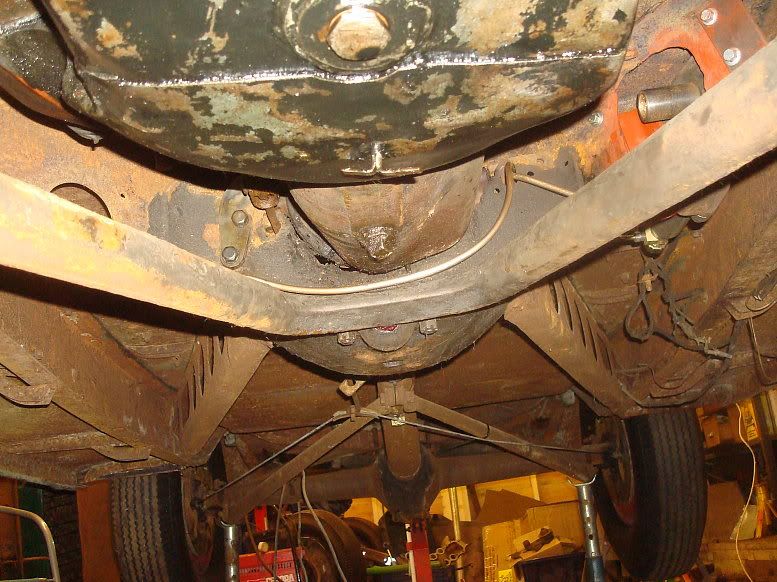

    Now, buying a car is a voyage of discovery. Some things are better than hoped for, but most things are worse. But that's the fun of the game. I was told the engine was stuck, but being the optimist I sort of hoped that rocking it in gear might free it up. The heads were only loosely fitted, so it took no time at all to find out my hopes were misfounded.
    Lots of rust and water damage.
    But hey ho. Keep looking around and taking stock.

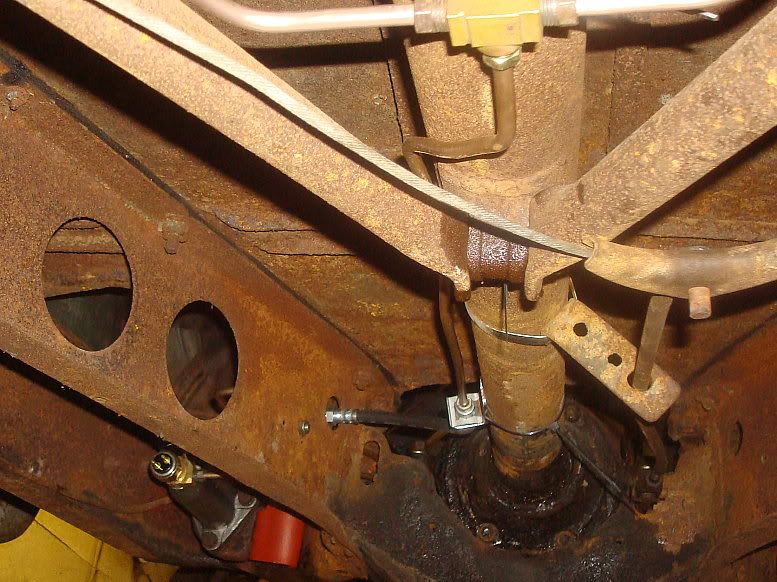

    39 pedals fitted to the x-member, stepped off at an angle on spacers. Still not square to the car but it must have worked.
    The floor cut a bit to allow the pedal to come up.
    Pedal linkage, while not following btextbook geometry, does still work.

    I've seen engine mount spacers used in 33's before but but not a stack of 4 engine mounts per side!
    Note the big square headed bolts.

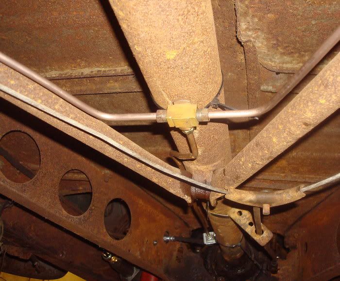

    Bottom hoses are pretty neat:
    I removed the grille, and removed the two bolts holding the rad. I used the oxy acetalene kit to heat the bolts. They were a bit rusty. I managed to cut through the hose clips on the lower hoses, and got the rad out of there.
    Positioning of engine looks pretty good.

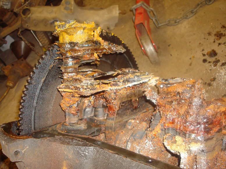

    I started to strip off any useful stuff, water pumps, manifolds, clutch etc, and decided to drop the sump. I was curious to look inside.
    Oh my GOD! What a mess!
    The photo's can't express it!
    The bit hanging down is the remnant of the filter assembly.
    Water had got in and had left distinct tide marks, I'm guessing each year.
    It's just the craziest thing - I've never seen anything like it before.
    But even the crustiest most f'd up flathead can yield up good useable parts. The water pumps are rebuildable (still turn) and the clutch and flywheel (10") are in excellent shape.

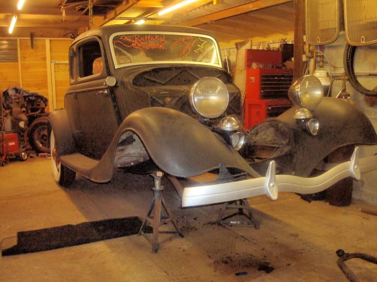

    So that was it for the engine. While the engine is out I wanted to go through the front suspension. So up she went on stands:
    I used the engine hoist to pick the car up, and then lower the axle down. This worked well because I could roll the axle out on the base of the hoist.
    And then a parting shot of the car waiting for the front suspension and replacement engine to go back in.

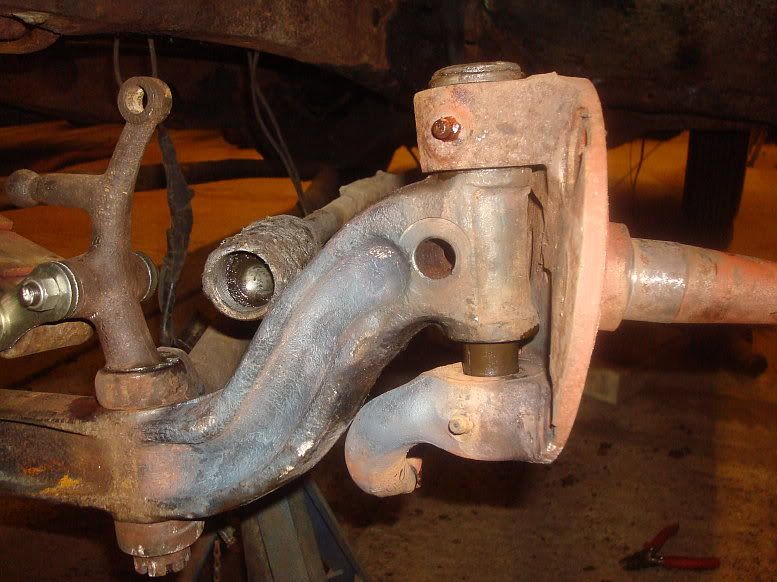

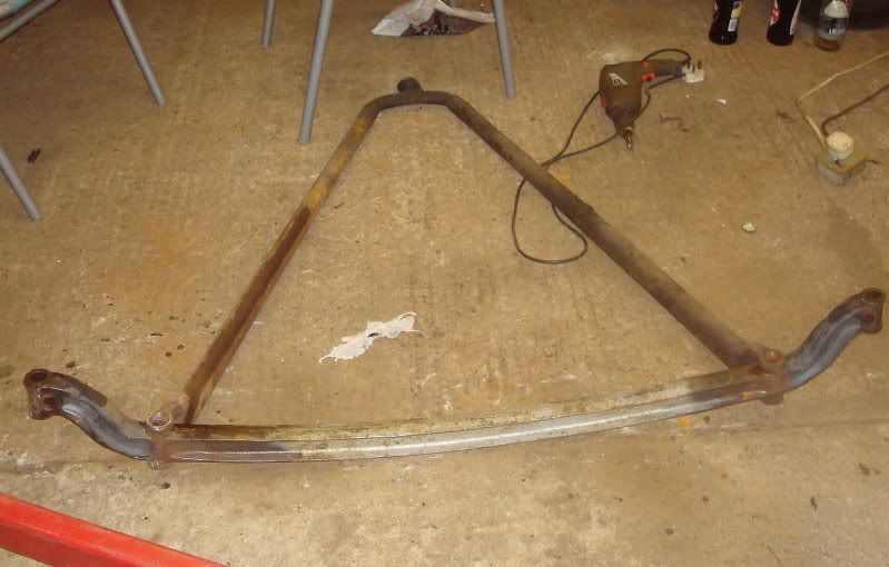

    Pulled the front axle apart last night.All the hubs, brakes and kingpins came off ok. The person that put it together seems to have had an aversion to splitpins. One perch bolt showed signs of fretting, and I got both the nuts off and the fretted one came out easy. It was actually loose and showed a small amount of wear.
    I have a dropped axle (JD) that I might sling under it, and have a plan to get it all set up using parts I have immediately to hand. I think the front could use a subtle drop (1.5") that will overcome the raising effect of the new bushes I will be fitting, but the other benefit will be a slight decrease in track width bringing the tyres back under the fenders.
    You have to drop the steering arms down a long way with a 33 wishbone, so I may look at running the track rod above the bones or using two twin hole spindles (one LHD and one RHD) and using the second hole in each, the extra length compensating for the deep drop.
    Although I didn't intend to do it, I think it will make sense to throw a coat of paint on the parts as they are refurbed and put back on. I need to allocate an area to wirebrushing etc, to try and limit the mess made. Working on the truck absolutely covered everything else in thick brown rust dust, and I want to avoid that if I can.

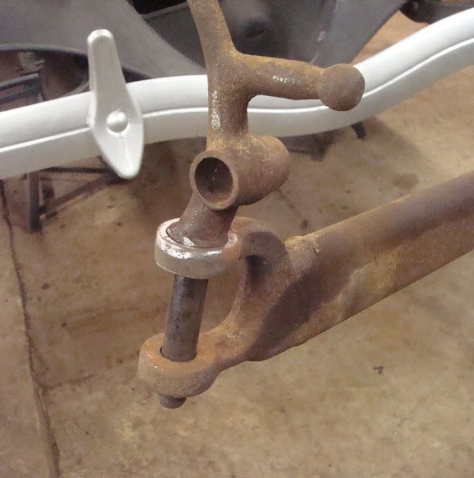

    Tonight I looked at the damaged wishbone and set about making it serviceable.
    I got the tight perch bolt out using a combination of heat and a pneumatic chisel. The chisel did not quite get it started, but I managed to get it to twist and then the chisel managed to push it out.
    The result of this exercise was that I had:
    A pair of perches, one slightly worn.
    One slightly fucked axle - the hole is oval. (Note dropped axle next to it - I'm going to use that)
    And a wishbone with a worn end.
    I decided the job stopper was the wishbone, so I tackled that first.
    I warmed the end with oxy acetalene and laid down a few good beads of mig on the surface.
    Then using an old fashioned pair of inside calipers I ground the weld down checking the gap with the calipers as I went.
    I finished it by hand filing until the fit was acceptable.
    This weld booger on the taper:
    Was ground and then hand filed down until it looked ok.
    And the good pin test fitted in place.
    I have built up the worn pin with weld and will see if I can skim it down on the lathe. These are not normally moving parts, but should be a good tight fit. If I can't get it right I'll be looking for a replacement or I do have a pair of street rod ones but I prefer the look of the originals with the brake and shock brackets on them, even though they may be redundant.

    Here's a few snaps from the last bit of work.
    Here's my worn perch bolt built up with weld.
    The perch was skimmed up in the lathe and finished to a true surface, the same diameter as the good one.. Then I fitted the shackle bushes. Here are the perches ready for refitting.
    The wishbone was fitted to the axle:

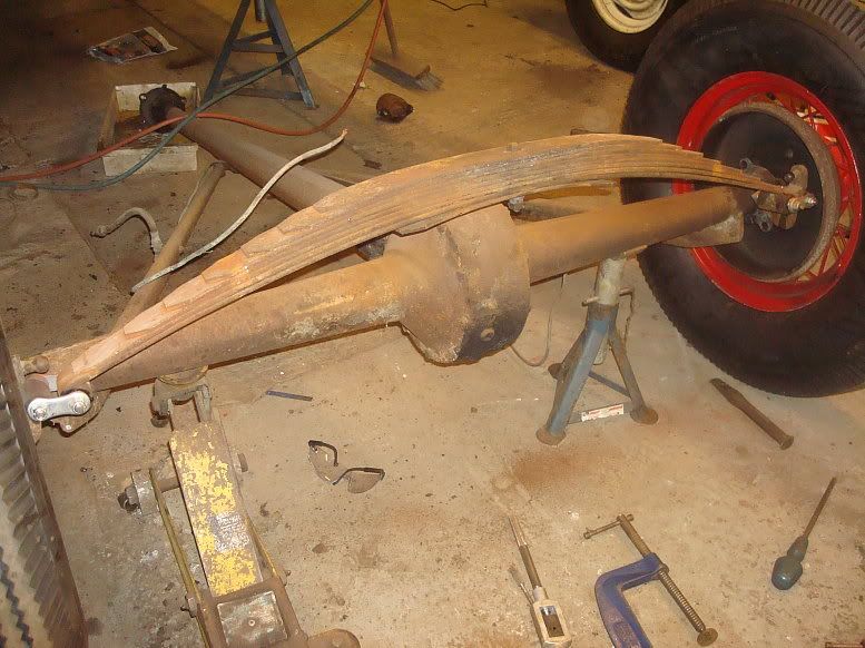

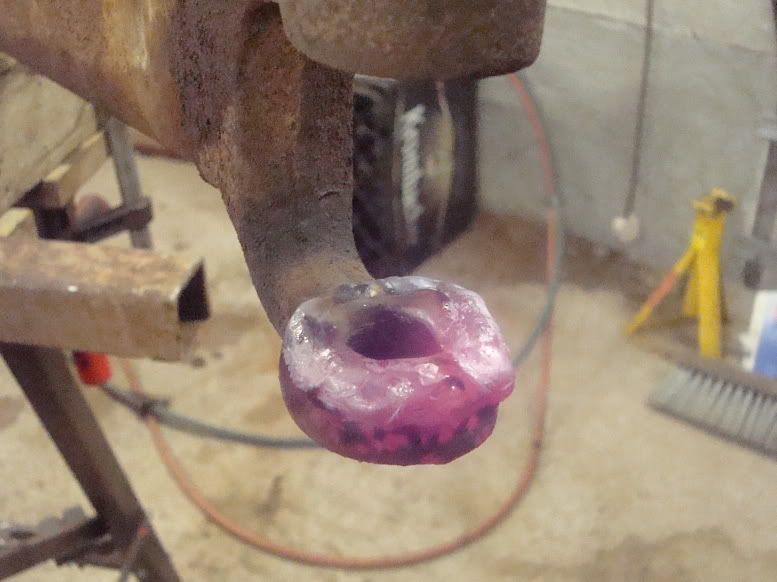

    And the spring fitted with new bushes and then fitted to the axle. Was disappointed with the replacement bushes from Macs. There's a thread on Fordbarn on the subject, I'll report my experience on there. (will add link here)
    Here the axle assembly is ready to be slid under the car.
    I cleaned up all the spring mounting hardware and after finding some better nuts, bolted the axle back in. I reset the axle stands under the wishbones in preparation for the next job: reshaping the steering arms.

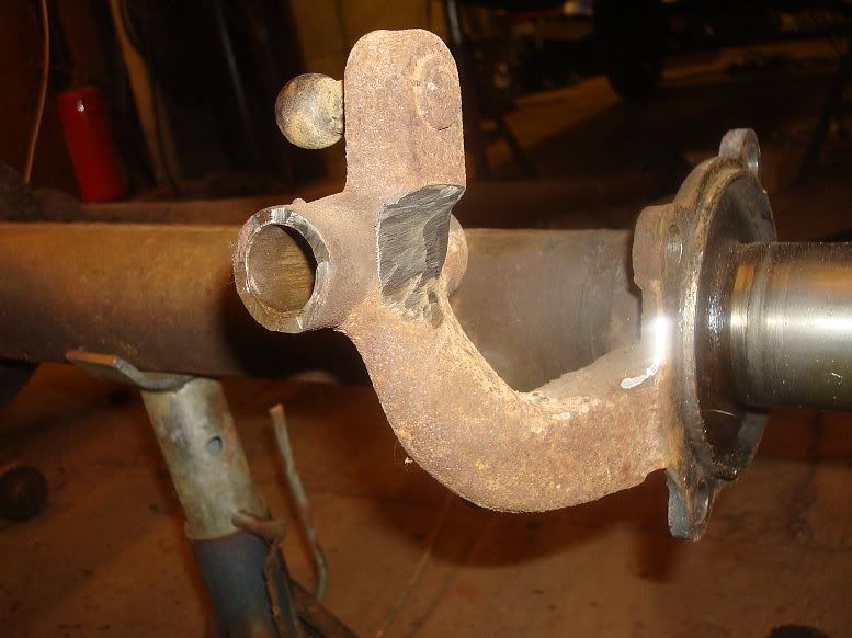

    4/29/12
    Little mini update from today's efforts.

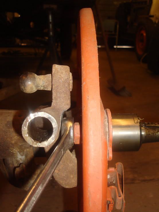

    I decided I was going to run lhd and rhd passenger side spindles, so they both the long steering arms with the two holes. I'm using the end holes normally used for the drag link for the track rod.
    I couldn't document the mods to the steering arms due to having to wield the oxy kit and big levers, but here is the problem in a nutshell:
    The stock arm fouls the drop in the axle. this one will not turn past the straight ahead.
    Here are the stock left spindle and the modified rhd left spindle.
    It is bent down considerably. I don't like the streetrod bolt on arms, I rather torture some of Henry's stuff into shape.
    Here you can see the spindle turning and the arm clearing at the tightest point.
    And because it is bent down the arm clears the axle completely all the way to full lock and beyond.
    And a shot showing the spindle in situ, showing the advantage of the long arms.. You can get them low enough to clear the 32-34 wishbone.
    These wishbones were designed to have the track rod above, so the bones are low relative to the axle. Later bones are designed to have the track rod below, so they sit higher relative to the axle.
    I shortened the track rod (1940??) just a little bit (1/4") and cut a bit off the end of one of the track rod ends to get the toe in close. I was going to do both ends but just doing one was enough.
    I fitted a new set of kingpins and new bushes.
    I use a standard reamer and do them one at a time, using the best old bush as a guide for reaming the first bush, then ream the second new one using the first new one as a guide. If you need to do spindles never knock the old bushes out until you know how you are going to ream them.
    So at close of play tonight I had both spindles fitted with new kingpins and bushes, the arms modified to clear and the trackrod shortened to fit.
    Quite a good bit of progress I'd say.

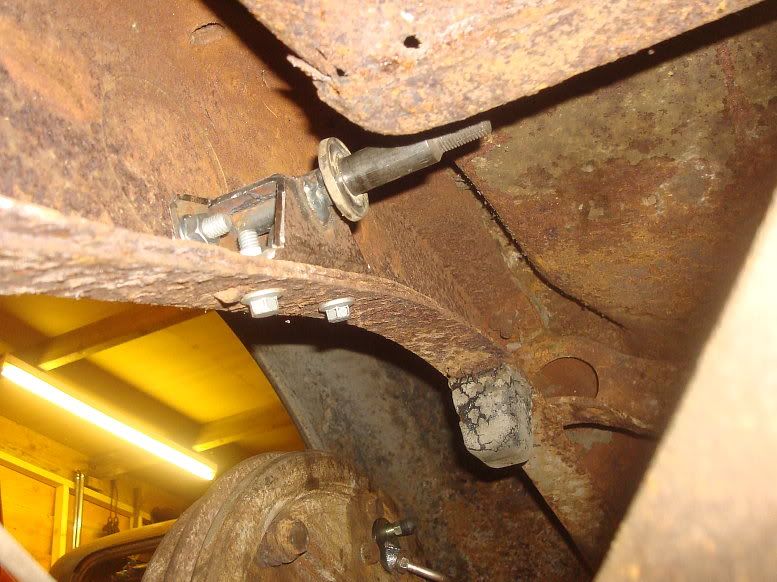

    While the engine and box are out, I wanted to sort out the pedal box. It's a 39 unit, and was fitted a bit poorly to a hacked x member leg.
    Here's some pics showing the as fitted condition.
    The master cylinder fits at a wonky angle and the clutch pedal comes up through the floor.

    While the front was up nice and high, I went through the front brakes, cleaned the worst of the muck off and replaced the cylinders and shoes as necessary. I cleaned the drums up, cleaned and regreased the bearings and assembled them all up.
    Here's a couple of shots:
    Yes, the grease shield is on upside down, to allow better access to the nuts on the slingshot steering arm.
    The drag link still needs sorting out, but that can wait a bit.

    When I was trying to remove the backplates, I had a problem with the square head bolts turning. I made up a special spanner from a cheapo 19mm combo spanner, suitable bent and ground to fit.
    And in situ:
    I still had to heat the nuts up, but this new spanner allowed me to get that initial movement on the nut, and then they came off quite easily.
    Anyone who has messed with early ford shackle bushes knows they are a bastard to get the remnants out. I struggled like fuck to get these out, but did eventually, after carefully sawing through the wall and chiselling the bits out.
    Getting the new bushes in was no easier. I started hammering the first one in, but it got stuck half way. It's very easy to mushroom the bushes and then it's virtually impossible to get them in. I have done them successfully in the vice, but I couldn't get the axle in the vice.
    No problem: bring the vice to the axle:
    By using various sockets as pushers, I managed to get them in, but even then it was touch and go.

    Once all the shackles were sorted out, I reassembled the spring to the axle, using the old technique of just putting the main leaf on first, (even then it took a good pull with a G-Clamp to get it over far enough to get the shackles on), and then assembling the rest of the leaves.
    I left two leaves out (short ones that had been fitted under the spring as spacers) so the nuts would go further onto the u-bolts.
    While the axle was out I removed the rear shocks (siezed solid) and the last remnants of the exhaust.
    After putting the wheels back on, I slung the whole axle, less brakes under the car, dropped the car back down and bolted it up.

    Somewhat unusual, this car did have a fully functioning handbrake. This feature is often missing on some cars. The lever was totally siezed up, but 5 minutes in the vice with wd40 and oil got it freed up nicely. Cleaned up the hardware and bolted it on.
    I freed off the adjuster and reassembled the linkage as I had taken it off. On this car I'm fixing what needs fixing and this works so it's going back on as it is.
    It pulls from a bit off centre, but the brakes don't seem to mind.
    But can you spot the mistake??
    That's right, the cable pulls straight across the brake lines. Brake lines are copper by the way and are still very soft and flexible after all this time. I had already decided to rerun all the lines and replace all the hoses, so off they all came.
    The pipe ran across the front crossmember, under the rear, right by the pulley so I made a new pipe.
    Here it is just laid in place.
    I decided this was a crap idea, the 34 is very cramped around this area, so after a lot of lying under the car I came up with a better idea. (Note old repair to water pump pulley in this pic -not by me, I hasten to add)
    Left side comes up inside the rail
    As does the right side.
    Here's a pic of the master cylinder and the fittings.
    From the junction block on the master cylinder, the front pipes shoot through the round hole in the x-member. One line goes through a t-fitting which feeds the flexy hose going to the back axle.
    Here are the two front lines coming through the hole that would be used by the handbrake on a rhd model.
    Ok, obviously I need to add a few clips yet. This routing is ideal because the lines are the right side of the x member legs and can run naturally up the inside of each rail.
    At this point I needed to finalise the design for the rear shocks, so the brake lines, which will run along the radius rods won't clash with the shocks. I have only gone as far as deciding how I'm going to do it and pulling one radius rod off.
    Here's the first mount roughed into place:
    The rod is 5/8" diameter with a 7/16" thread. They are off the old jag independant rears.
    Once the design for the shocks was settled I could lay the rear pipes in.
    Above you can see why it was important to do the shocks first. The pipe run is nice and simple, and lays in place easily with a minimum of bends. The shocks can be removed and the radius arm bolts accessed without disturbing the pipes.
    You will also see in the pic above a cable tie holding the brake pipe, I am happy to use these, but a handy tip is to take an extra turn around the pipe, as seen above, this holds the pipe off the surface by the thickness of the tie, reducing chafing and debris buildup between the pipe and surface.
    I'll deal with the pipes first then come back to the shox.
    The pipes run up the inside of the radius rods and join into a Tee:
    And in this shot you can see the nice simple setup with the short hose going from the frame to an intermediate pipe and then feeding the Tee.
    That's it for the brakes, they're all plumbed up, copper washers fitted and everything tightened as necessary. I won't fill the system with fluid and bleed it until I've decided how to do the front shox in case I need to pull the front end again.
