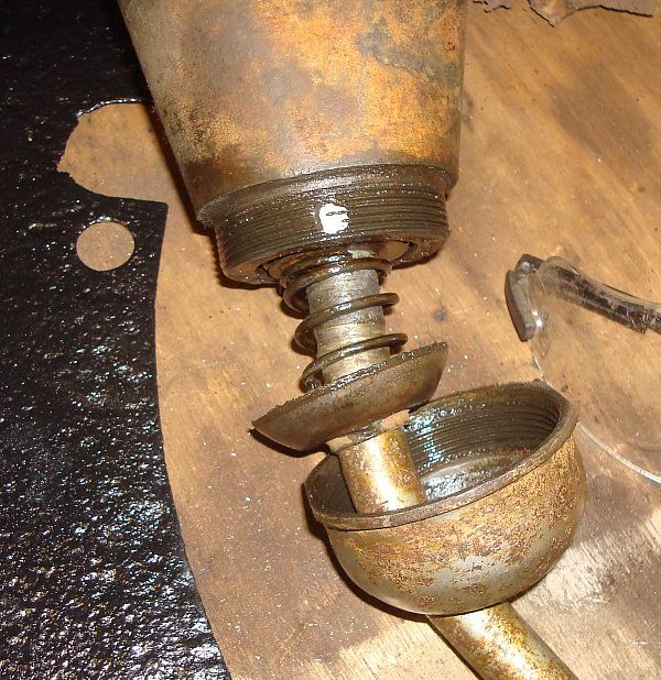

    But before that there was a couple of other little jobs. I removed the trans cover and drilled out the dowel hole to 7.5mm. I ground out the slot in the shifter until the shank of a 7.5mm drill just p***ed along the groove and made a new pin from a piece cut from the same drill, the part just above the flutes, which is harder than the end of the shank.
    Amazingly the cap unscrewed bu just grasping it with a cloth and turning it by hand. I was expecting all sorts of aggro getting it undone.
    The reduction in side to side play of the gearstick was quite remarkable. It was pretty sloppy before.
    While the lid was off I drained the oil. The gears were quite rusty and a lot of the rust had come off and discoloured the oil. I refilled it through the open top which is by far the easiest way. I used sae 140 non ep. The gears looked pretty good, nice and shiny despite some slight pitting.
    I'll probably give bit another flush through in the future.

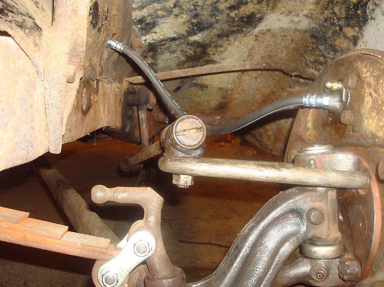

    One thing that had been bugging me on my coupe was a slight tendency to bump steer, or even worse, "roll" steer. There are traffic calming measures on my road in the shape of raised junctions. The car would give a little kick to one side as it went up the bump and a slightly bigger kick the other way as it dropped off the other side of the bump. Also when trying to drive fast down a country lane as I wind some steering on and start to turn right, lets say, as the body rolls to the left, the steering pulls harder to the right. Not good. It was a bit of a handful on the twisty stuff, requiring constant attention and correction.
    I had an idea what was causing the problem. Hers's a pic to illustrate.
    Ok, it would have been better taken from the side, but you can see that the drag link runs uphill from the pitman arm end to the steering arm ball. The steering arm is straight, and the ball is fitted sticking up, so the drag link attachment is quite high. All this is made worse, of course by the dropped axle. Fitting a dropped axle does cause a big list of knock-on effects.
    I decided to invert and drop the steering arm. That meant that the drag link would no longer fit, as the end would be the wrong way up. As I needed to modify the drag link I decided to make it adjustable using the end of a track rod. A drag link has two different ends, one the same as a track rod end, and the other one is the opposite way around. This means one end has the shock absorbing spring for compressive loads, the other end has a spring for tensile loads. So I used the otherwise s**** drag link that was on the coupe when I got it, and cut the end off that was the opposite of a track rod end, and took a bent track rod and straightened enough of it to give me enough to make a drag link.
    I drilled out the track rod tubing to about 12mm and turned down the drag link shaft so it pressed into the drilled out end of the track rod tube. I cleaned it thoroughly and welded it on full power with the mig. I then drilled and made a couple of rosette welds through the tube into the shaft of the drag link end. This is a highly critical weld so don't try this at home unless you are either confident of your own abilities or have a certified welder prepared to do it for you. Aussies would not be allowed to do this.
    So the steering arm was heated and bent to give a drop, a new ball was fitted and the drag link built up and fitted.
    Here's a shot from the front:
    You can see the drag link end is about 4 inches (or more) lower than it was. What you can't see so easily is that the alignment is better, the drag ling sits on the ball more readily, without binding. Everything travels through the full range from lock to lock without fouling or binding.
    And here's a shot from the side:
    Although I do not have a "before" shot for comparison, you can see this angle is perfectly reasonable.
    I took it for a road test and I could feel straight away that the "edginess" had gone, and the tendency to dart to the side over the raised sections was gone too, I could ride the bumps hands off and it just goes straight. The first road test showed me that the drag link length needed adjusting as the steering wheel was not centred. A couple of iterations of adjustment followed by a quick run around the block got that dialed in. Having the sweet spot on the box properly aligned to straight ahead driving seems to make it that little bit better.
    So a good improvement for what amounted to a couple of afternoons worth of work. Now it's dialed in I can go around and fit the splitpins and regrease and go out and enjoy the improved driving experience.
    Mart.
