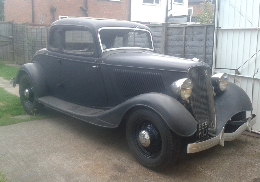

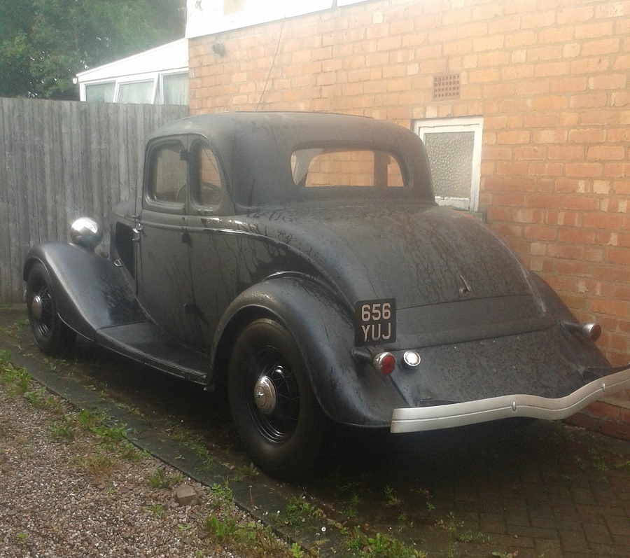

    Anyway, here are two pics taken a couple of days ago. I have painted the wheels black and turned the tyres blackwall out. I thought it was tume the old girl had a new look.Of course I got caught in a heavy shower during the road test!
    Oh yeah, forgot to say - I how have an undropped axle and a reversed eye spring. I basically swapped the axles between this car and my roadster because I wanted a dropped axle on the roadster.
