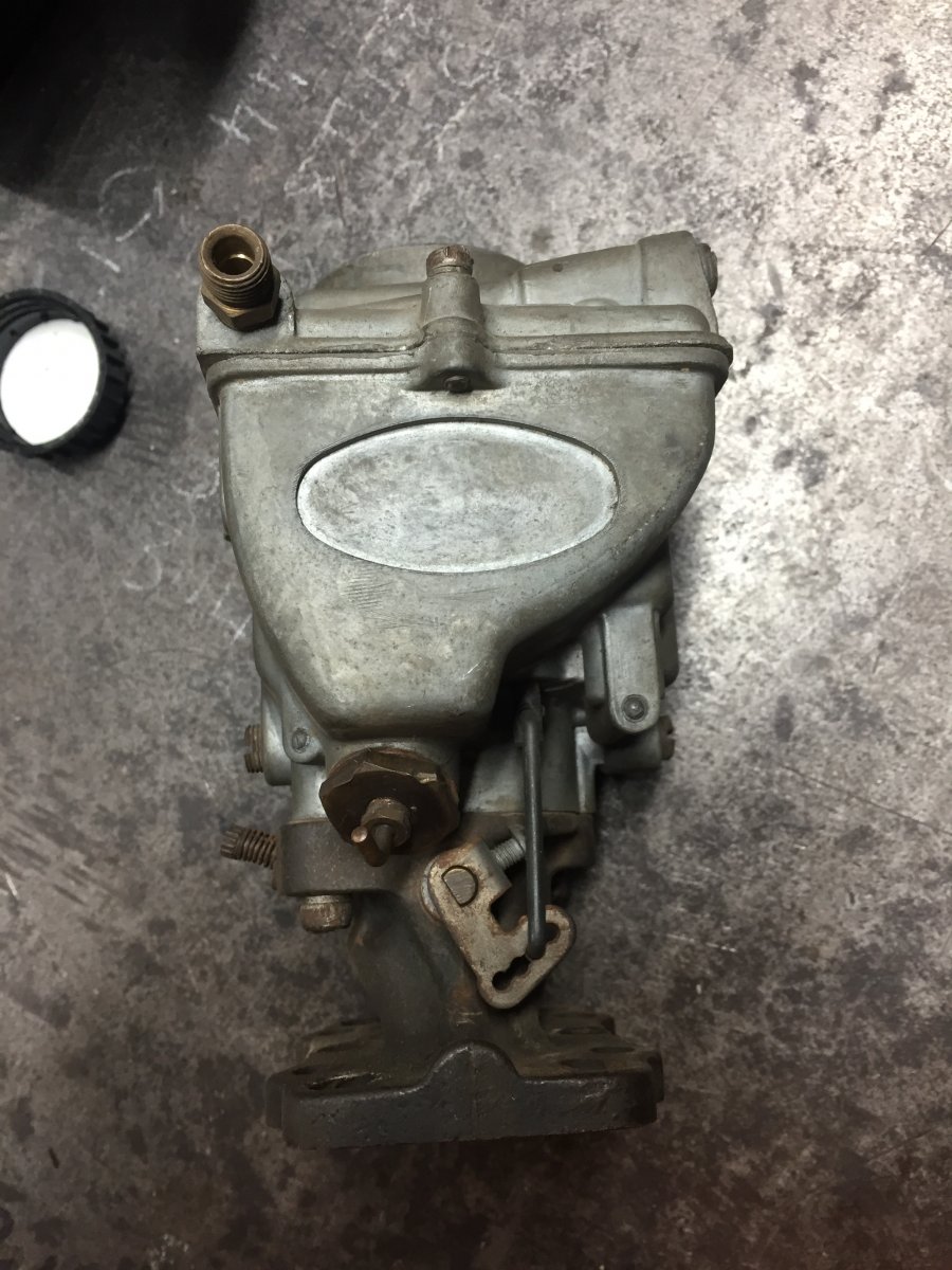

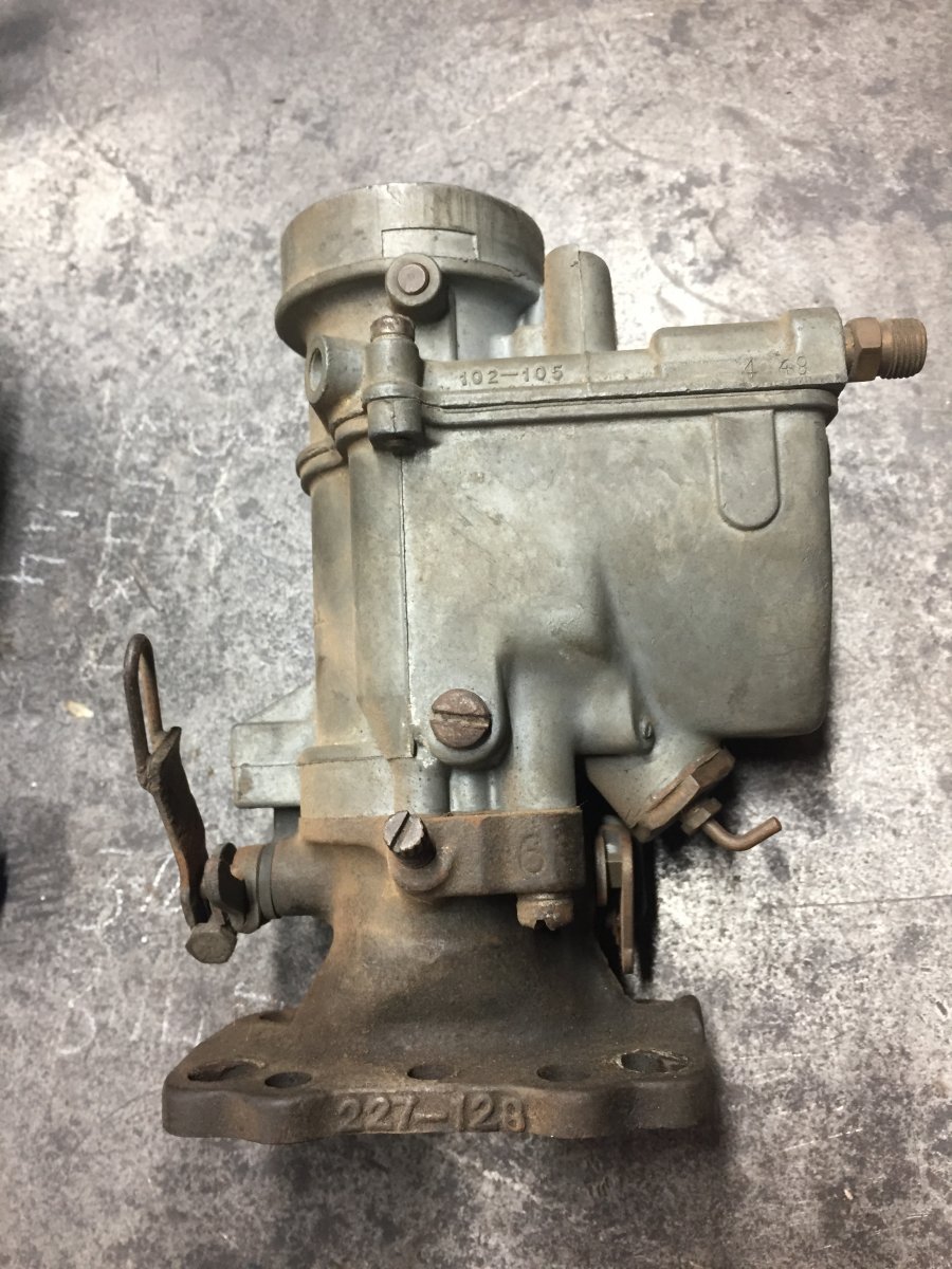

  1. Could any of you carby guys tell me what the Model 10-2929 carb was off and any info on these carbs.They have a multiple mount base on them to fit where a 94 or 97 could be used.
    This is a single barrel model. It was mounted on a A Model A motor with a B crank, adjustable followers and big valves run in an old race car.
    I read that the Model 10-2928 was a replacement carb for 34-40 Ford v8s ,possibly a duel barrel.
    I asked on the Ford barn also ,
    Thanks for any info.

    Original application was a dusty shelf on some of the mail order auto parts companies famous for quality parts. ;) (Whitney, Warshawski, Western Auto, etc.).
    Originally sold to customers too frugal to purchase a carburetor rebuilding kit for their original carburetor. :p
    Basically, one of the early "one size fits all, works well on nothing" carburetors.:eek:
    Superceded in August 1948 by 10-3288.
    Parts availability - your local machine shop ONLY. These were basically sold as a "disposable" unit. There are no parts listings, specifications, kits, etc. listed in the Marvel Schebler master books.
    Best current usage:
    If clean - paperweight
    If dirty - doorstop

    Barrelnose - a wee bit of additional information:
    In your second picture, an indented oval is visible on the center section of the carburetor. When new, a "water decal" was pressed into this oval, with the "manufacturer's name". I have seen Johnson, Marvel/Schebler, personally and Wizzard seen by a friend.
    Of course, guess what happened (quickly) to the water decal!
